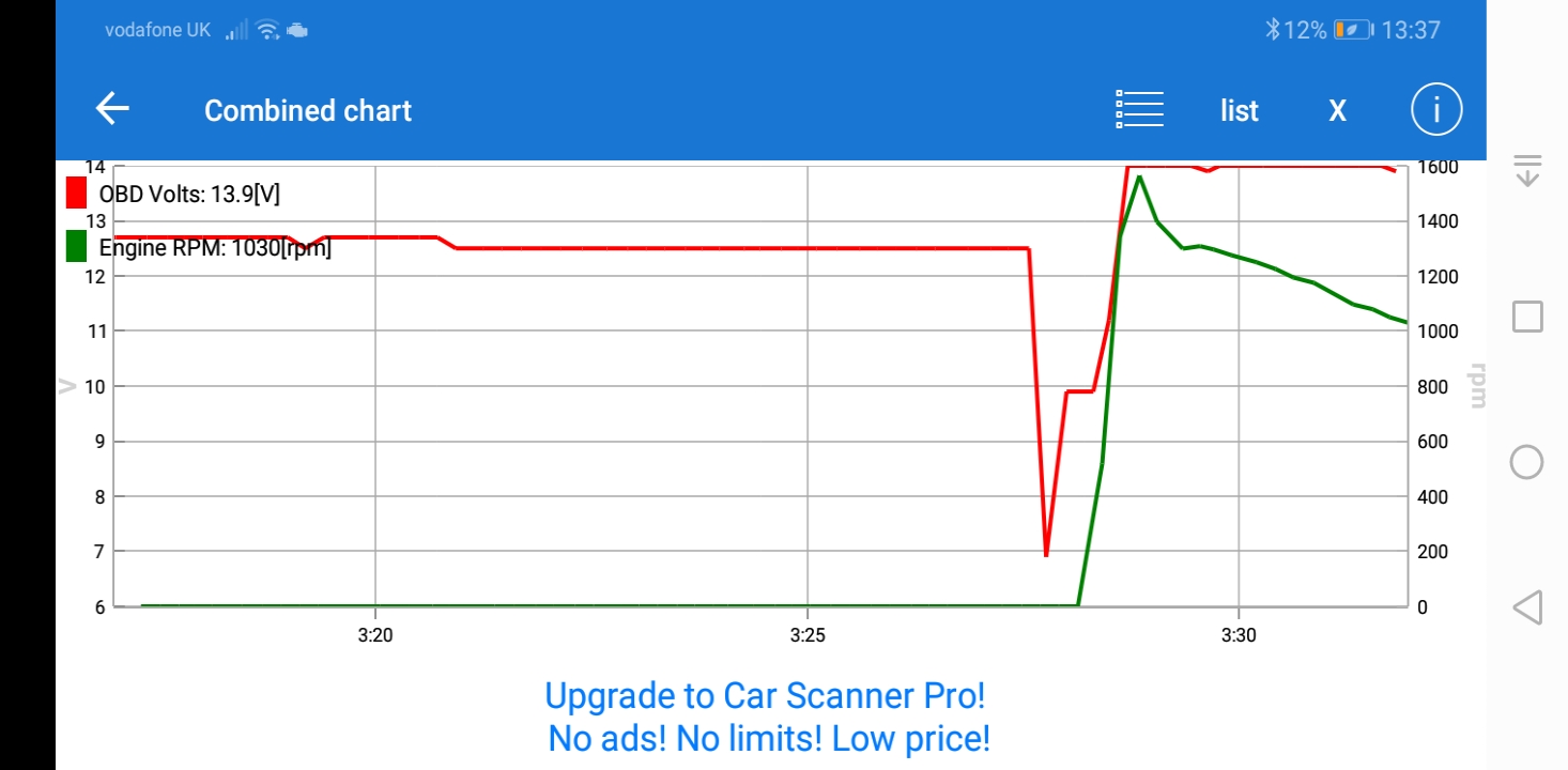

If you have a scan tool it's quite useful to graph the voltage while cranking
Here, my car with a weak battery, you can see while the starter is stationary the voltage drops to 7V for a brief fraction of a second, far to quick to be measured by a multimeter
Another volt and I would have had problems starting clock would have reset and possibly problems with the instrument pointers

What's it drop down to while cranking
Red line starts at 12.6V but drops to 6.9V during cranking, this car has a faulty battery that fails in cold weather
