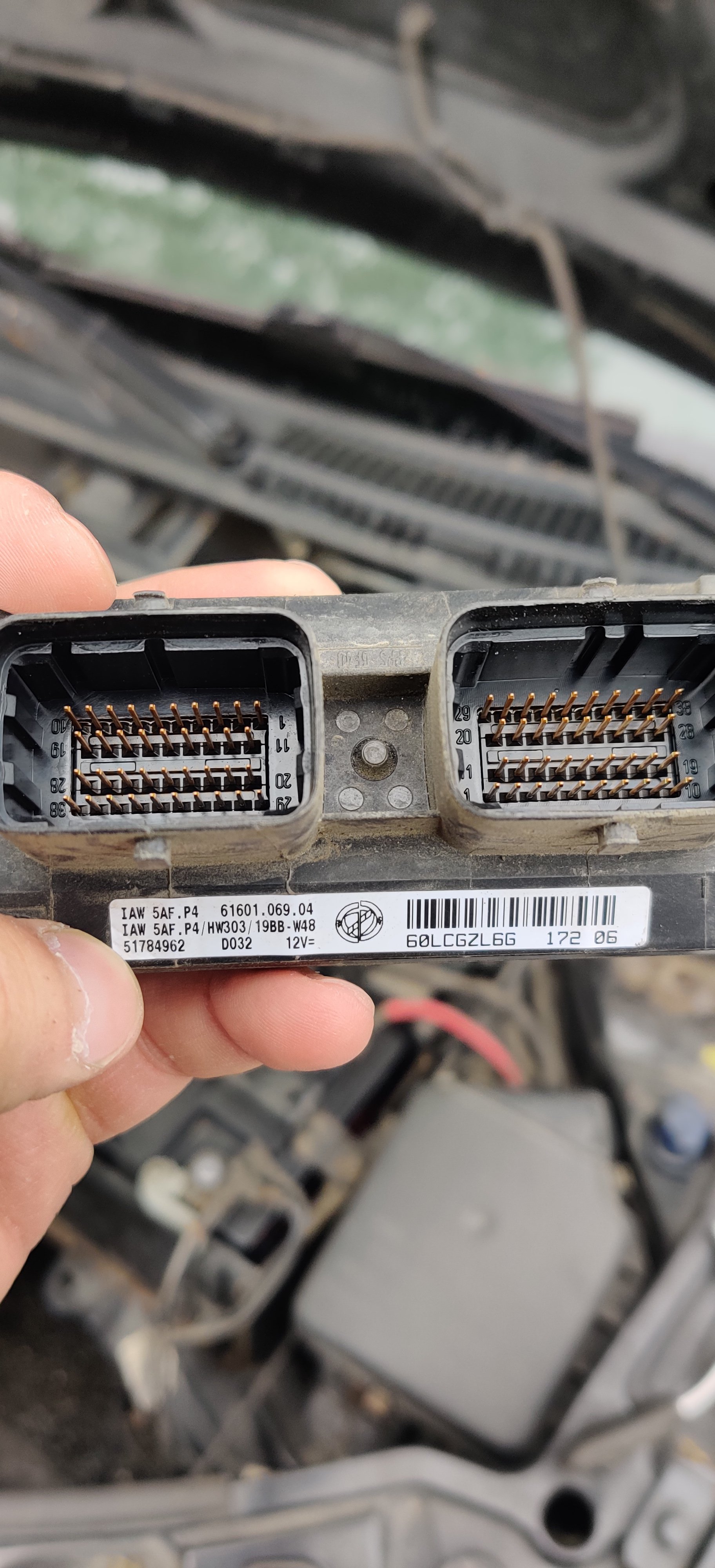

Would a ecu model IAW 5AF.P4 / HW303 / 19BB W48 with part numbers 61601.069.03 and 51782650 be compatible with the ecu I'm planning to replace: IAW 5AF.P4 / HW303 / 19BB W48 with part numbers 61601.069.04 and 51784962. (Fiat Punto 1.2 8V, 2006)
Ebay is full of vendors selling the ecu with part number 51782650 and it's almost impossible to find someone who sells one with part number 51784962.

do you mind saying why you need to replace the ECU? The coil output transisters could be replaceable without access to special equipment. It is much harder on the 16V ECU because of the bonded gold wires.

The car failed the MOT, check engine light stays illuminated. We already changed coils, plugs, ignition wire set and both o2 sensors. The engine misfires on ignition and stalls in the first 5 seconds unless some throttle is applied and idle stays rough afterwards. The mechanic suspected that the cause is most likely due to a faulty ecu, can't remember the error codes since it's not my car.
Would you happen to know whether all ecu models IAW 5AF.P4 / HW303 / 19BB W48 are compatible with each other even if the other part numbers are different?

Sorry. I do not have a definite answer about the types of ECU.
But why were all of those parts changed?
What codes did the mechanic find?
Changing the ECU sounds like you are guessing rather than being systematic.
Don't know which way to guess this.
