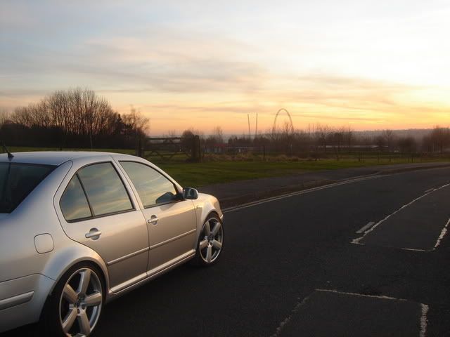

Trust me, I've been waiting to hear just as much, if not more than you :)
Can't believe I came back from holiday to a standard Bora. LOL.
Here's some mouth-watering pictures for the time being.
None of the engine until it's finished though ;)
I didn't read your thread.. partly because I was probably on holiday and didn't see it.. will have a search now.
The only negative thing i would say about your bora is its silver. not a fan of silver cars. but i know its a good car. wanted one myself for long enough. I dont think the Passat is too big a step up price-wise, so would choose that over the same age/spec'd Bora.
