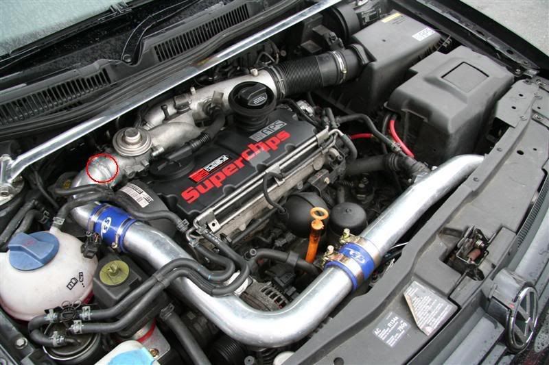

Reason I say that beacuse the 130BHP version is in the wheel-arch and the 150BHP version is front mounted. I keep blowing my Turbo Pipe too at the EGR valve - I can't find a suitable replacement for the OEM one.
Does that company manufacture custom stainless steel pipes too? Or something along that derivative.. cheers.
What size is the pipe Ian? We do braided stainless steel hoses that go up to pretty large but it's probably not what you're looking for. Most of the stuff they work with at Docking is ally. Have you got a picture of what you need?

Here is a pic of a 150PD Anniversary with what I want.
I've circled the problem area (mine is currently a silicon hose that runs down to the nearest wheelarch on that picture. This particular picture has n FMIC.
I really do need a set-up like the above, but I'm not sure where to go, or what Intercooler to go for? Or what pipes to even go for?
Thanks !

They could knock that up for you no problem. You're from Liverpool though aren't you..Silverstone is a bit far for you to travel down I guess! I'll have a word with one of the guys tomorrow and see what he says.
