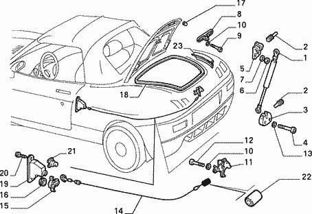

...the boot lid, I mean :D
Anybody know where the rub might be? I tried applying WD40 behind '19' (attached pic), but to no avail; the lever's still stuck (yes, it is unlocked ;) ). Is there anywhere I can access the wire from to see if it has snagged on something?

Dont know if it's any help robot but one thing you could try is:- pull both seats forward, take the black covering off the panel behind the seats. You will have to undo the bottom of the seat belts and the centre console and also remove the plastic covers either side that covers the hood mechanism. Then remove the grey coloured metal panel and this gives you access to the petrol tank but it also gives you some access to the boot release cable. I dont know if this will help but if all else fails, and you followed my earlier advice and hit it with a hammer and that didnt work then you have nothing to lose:eek:
Any chance you've had a look? :D Hopefully I'll have come far enough with rebuilding the dash today, that I could have a see if I could fix the boot as well :eek:
I did what you wrote superspotty - but for some reason the metal panel didn't want to come away :confused:. It looked like I'd have to remove the whole roof-mechanism to be able to remove it. So, I ended up just putting it back together again :eek:
After I had put it back together I started pulling it a few times, and lo and behold! - it popped. Obviously I lubed it up well before I started pulling it :D.

I got a pm from 'Richard in France' about how to fix it. Figured I'll paste it here in case any of you experience the same problem:
"You need to remove the plastic dressing from the rear bulkhead. You'll then be able to get into the boot space. You need very long arms or a tool (I used a piece of steel) to unlock the boot by flicking the mechanism aside. DO NOT RECLOSE THE BOOT (like I did).
You can then trace the cable all the way from the boot to the door pillar. DO NOT REMOVE THE OUTER SLEEVE!!!!!!! You need to find a replacement CABLE with the nipple end at the door pillar and the raw end at the boot end.
It's actually really easy, technically, but you'll grunt and groan, take the skin off your knuckles and generally get a bit sweaty doing the job as it's in a really confined space!
PS - the plastic dressing is a real b*tch to get back on perfectly... "
