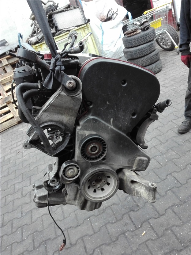

Yes, it looked to me similar to the one in the 156 I had. But as I don't have a general view of the Barchetta engine, so cannot be sure it's the same.
Attached 2 side photos of the 156 engine. Ah, that's a 2 liter engine, but the mountings should be the same to fit the same engine bay.

Super, thanks! Found it, I wonder what in the world is it doing in my daughter's b..?
Thanks for great photos! I'll have to look closer in ePER, doesn't look like it will come off all that easy...
That is easy. It came in with the whole engine...
You’re thinking an engine swap? Hmm nothing in the service manual or old receipts… The cover is Fiat, but underneath 🤷‍♂️ I wonder how much is interchangeable within Pratola Serra B, and how to tell what is what..! Oh boy 🤦‍♂️
I can't even imagine how, and especially what for someone could add an extra mounting point to the engine installed in the car :)
