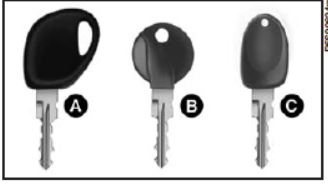

The manual shows 3 keys, the Master (burgundy A in pic), the daily use keys (blue, B in pic) and the "Valet" key for lack of a better term, starts the car but doesn't open things (C in pic).

I don't know about the Barchetta, but FIAT like most of other makes uses immobilizers. The transponder should be in the key. Normally it is a glass . plastic tube with electronics inside, the power is inducted from the antennae around the place you put the key to start the engine (I don't know the English word). So, putting the wrong key, even correctly cut, wouldn't allow you to start the engine. It was already used in the 90's in the Cinquecento. So definitely could be the same in the Barchetta.
A key without the correct transponder was able to open the door and unlock the steering wheel, but was not able to start the engine. In the CC my father had 3 keys. The main one, blue one, similar to yours marked A + the same exact copy. And the 3rd one was similar to yours marked C. With a black plastic. And as far as I remember this one had no transponder, so if the main keys were lost, you could start the engine only having a code card (there was a special procedure to input the code), and to make a new main, full key you needed to have the code card + the 3rd key. Combined it allowed you to get a new working key.

Our 2005 Barchetta, manufactured on 23/07/2004 (VIN range 57170 - 57420), came with the three types of keys. Red Master, Round Blue Normal, Oblong Blue Valet Key.
For the Barchetta I would think it is unlikely that Fiat would have changed from the Code I to the Code II System. The Mark II Bachetta's were a reopening of the manufacturing line (well all hand built) with minimal changes. Notably the bumpers and boot brake light. The same Hitachi engine ECU & Immobiliser were all the same.

The later keys, without the brown master, had a '2' on the blade, just below the plastic part, with a little symbol that represented the transponder.
If it has the 2, it is a later type and can be cloned. If it has nothing, it is either the type 1, or a replacement with no markings.
