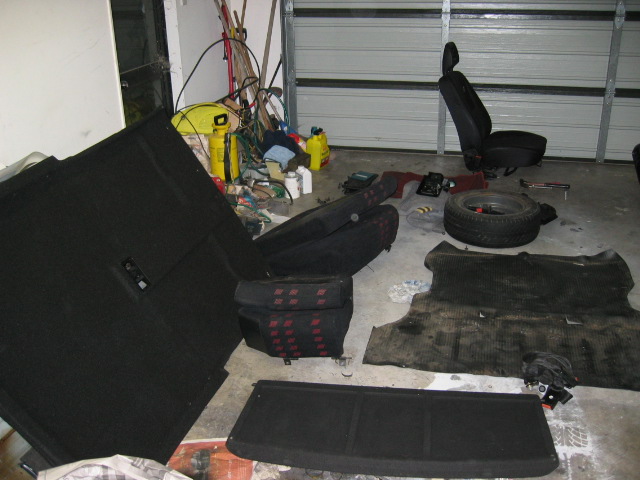

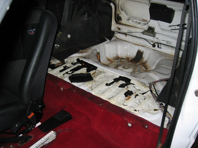

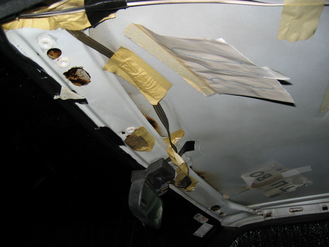

I thought I'd put in a little effort ahead of the last Toyo Series clubsport event tomorrow... so I spent just one hour reducing the weight of my Uno Turbo.
Ever noticed how your Uno goes so much better when you are completely by yourself alone* than when you have a passenger? That's the difference that ~70kg of weight saving can do ;)
Here are the items I removed:
Luggage compartment mat (Turbo version)____4kg
Std. spare wheel/jack/tool_________________14kg
Rear seats (split-fold)________________10.5 + 7kg
Front passenger's seat____________________13kg
Rear shelf________________________________2kg
Floormats (aftermarket)___________________2.5kg
Headlining________________________________4kg
Sun visors/grab handles____________________1kg
Rear seat belt buckles______________________1kg
Total___________________________________59kg
_________________(approx. 7% of the kerb weight)
I always wondered what these items actually weighed: I think that the best value items to remove are spare wheel, seats, and that insidious rubber mat that covers the boot floor (it also contains sound-deadening material on the Turbo). I'd say not to bother removing the headlining: only 4kg and makes the car a lot noisier with it removed! I guess I wanted that race-car feel. Also, my tailgate hinges need replacing so I had an excuse. ;)
Incidentally if you're wondering how to get the 59kg saving up to the weight of a passenger - you could remove most of the petrol: I think I could save at least 20kg there - pity I filled up recently so I have at least 45L*0.737kg/L = 33.17kg there...
The carpet is the obvious next target: however, being an Uno, it is not terribly luxurious and I suspect weighs about 7-8kg at most.
-Alex
* ten points for guessing the song that I paraphrased :)

How difficult was the headlining to remove, this would be my first target.
As for the song, no idea :confused:
Dead easy!
Remove the grab handles, sunvisors, rear view mirror and push in plastic plugs and it just comes down in one piece. Assuming you have an interior light, you can prise it out first then disconnect the wires.
It's a little more difficult if you have a sunroof fitted as the aperature is glued to the sunroof surround. On my mk1 the headlining fabric had become very brittle and just broke apart where it was glued to the sunroof. I ended up cutting round the edge, which wasn't too much of a problem as I planned to recover it anyway. Thing is, that was nearly two years ago and the headlining is still sitting in my spare bedroom... :eek:
