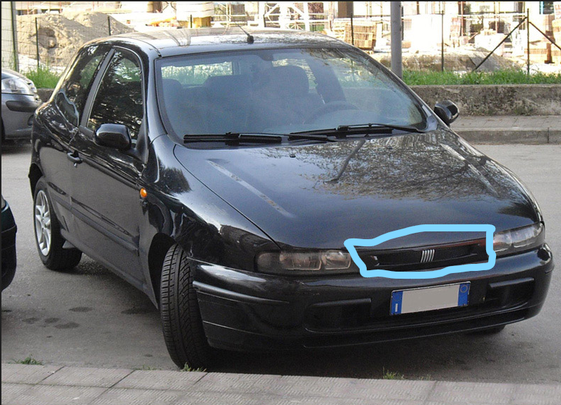

D dusko96 New member Joined Dec 17, 2022 Messages 2 Points 1 Location Macedonia Dec 17, 2022 #1 Hello, I am new to the forum, I have no idea how to fix this part shown in the picture, it is broken from inside, can you help me?

OP OP D dusko96 New member Joined Dec 17, 2022 Messages 2 Points 1 Location Macedonia Dec 22, 2022 #4 Thanks, but i want just to fix that.
N Neverth Established member Joined Jan 18, 2012 Messages 665 Points 201 Dec 22, 2022 #5 I glued two of mine together, bonnet up, then take the three nuts out, most likely only center one is connected and sides have detached. Once all parts are out I just used epoxy to attach the side mounts and then reinstalled the next day.
