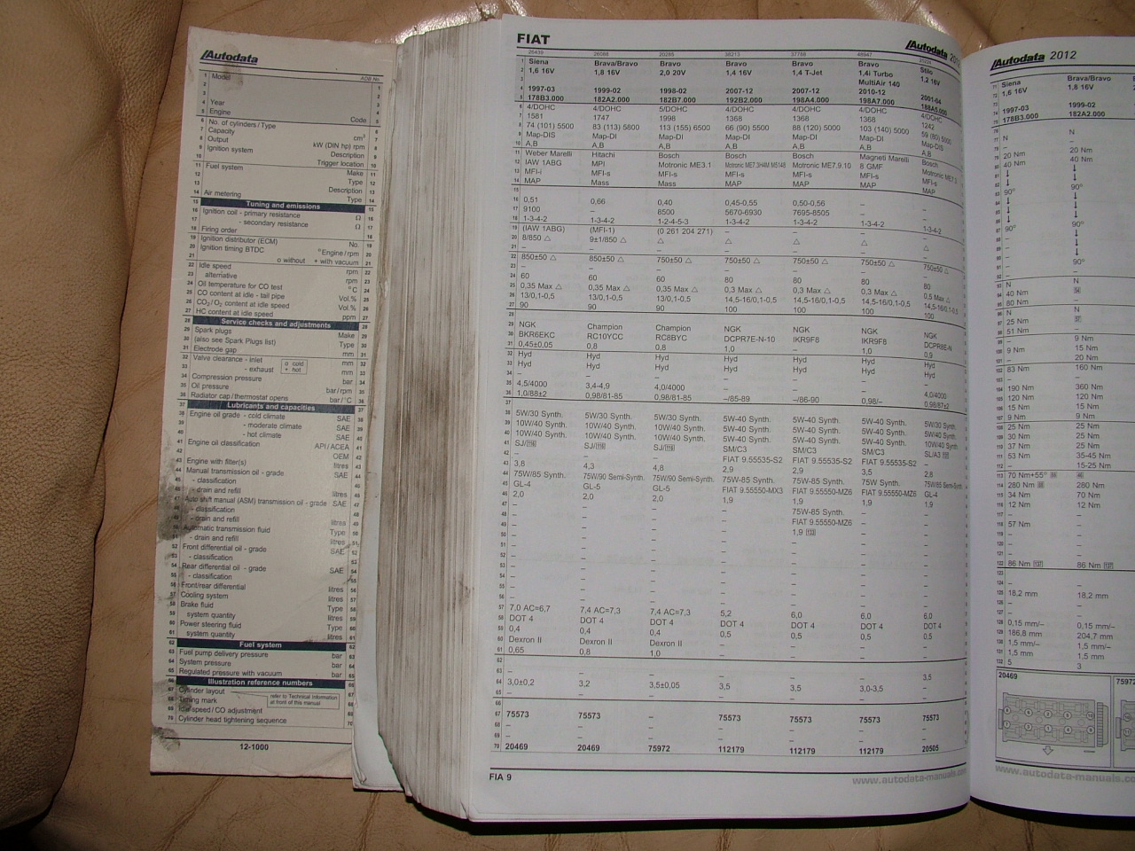

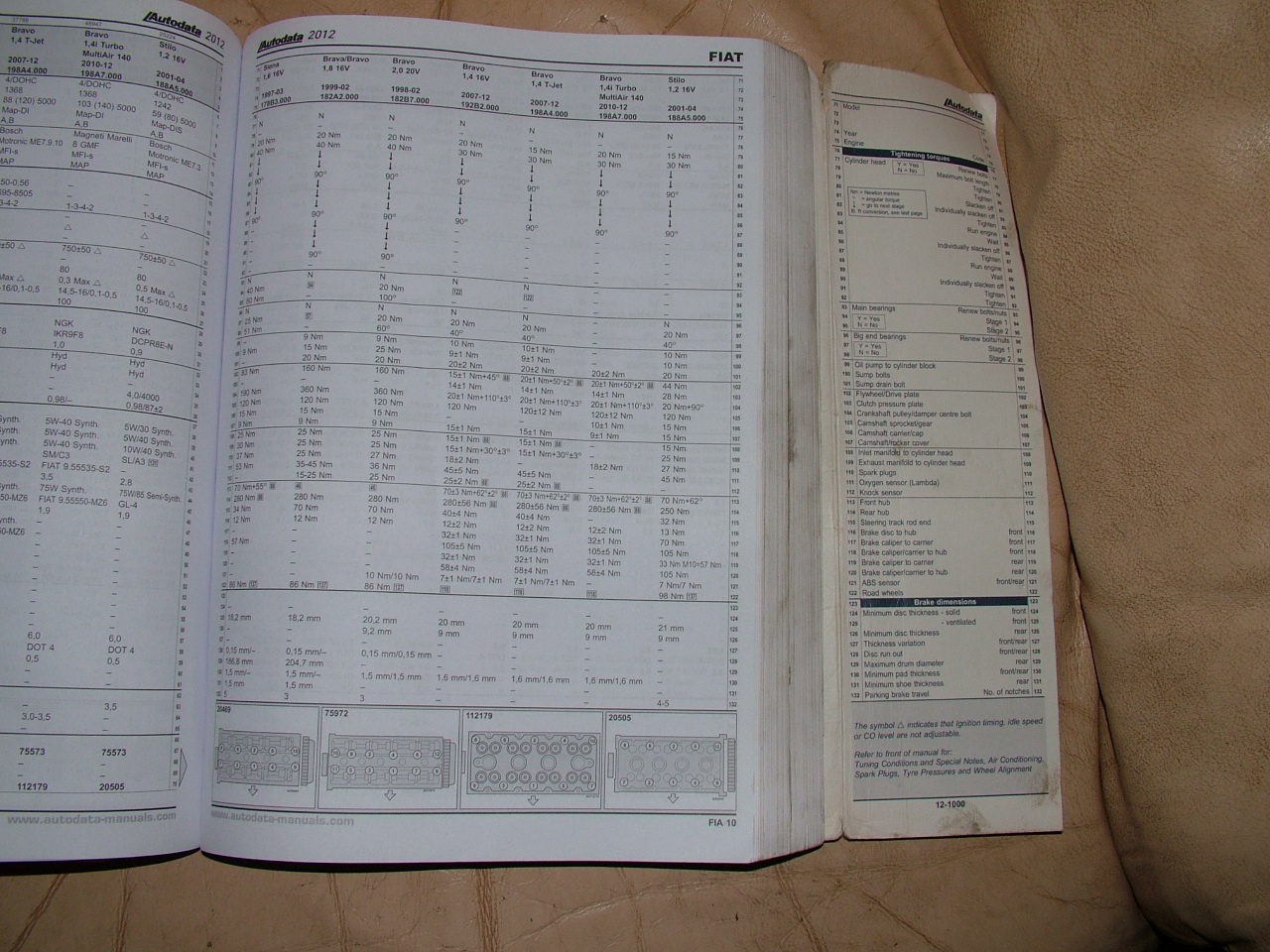

Hey! I'm going to change a head gasket on my 97 Bravo HGT but don't know the correct engine head torque spec and the right tightening order.. Can anyone help me? Also don't you know if the 147 HGT and 155 HGT heads are the same? Thx

This is all I have, but not exactly your engine code. So maybe check elsewhere to confirm.:)
