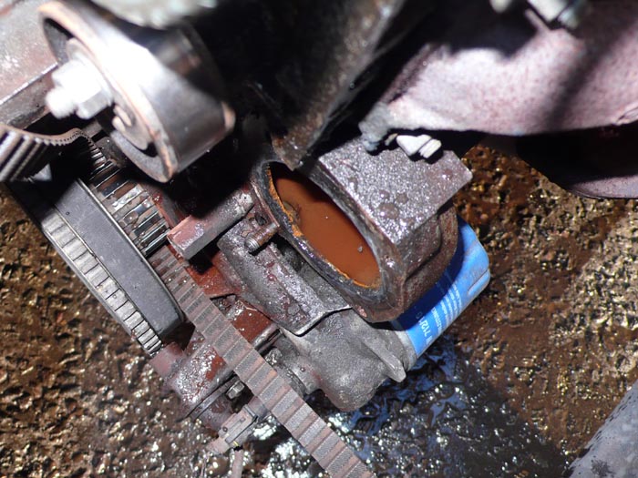

First you will need to loosen the timing belt tensioner and remove the belt from the water pump pulley etc. The undo the 3 10mm bolts in the pump and there is a 10mm nut on the bottom far corner. once thats done just give the pump a bit of elbo grease and it will come out.

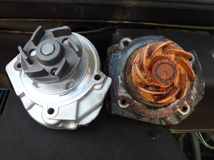

This is the old pump on the right, you can really see the difference compared to the nice shiney one on the left, the bearing in this one is knackered.
