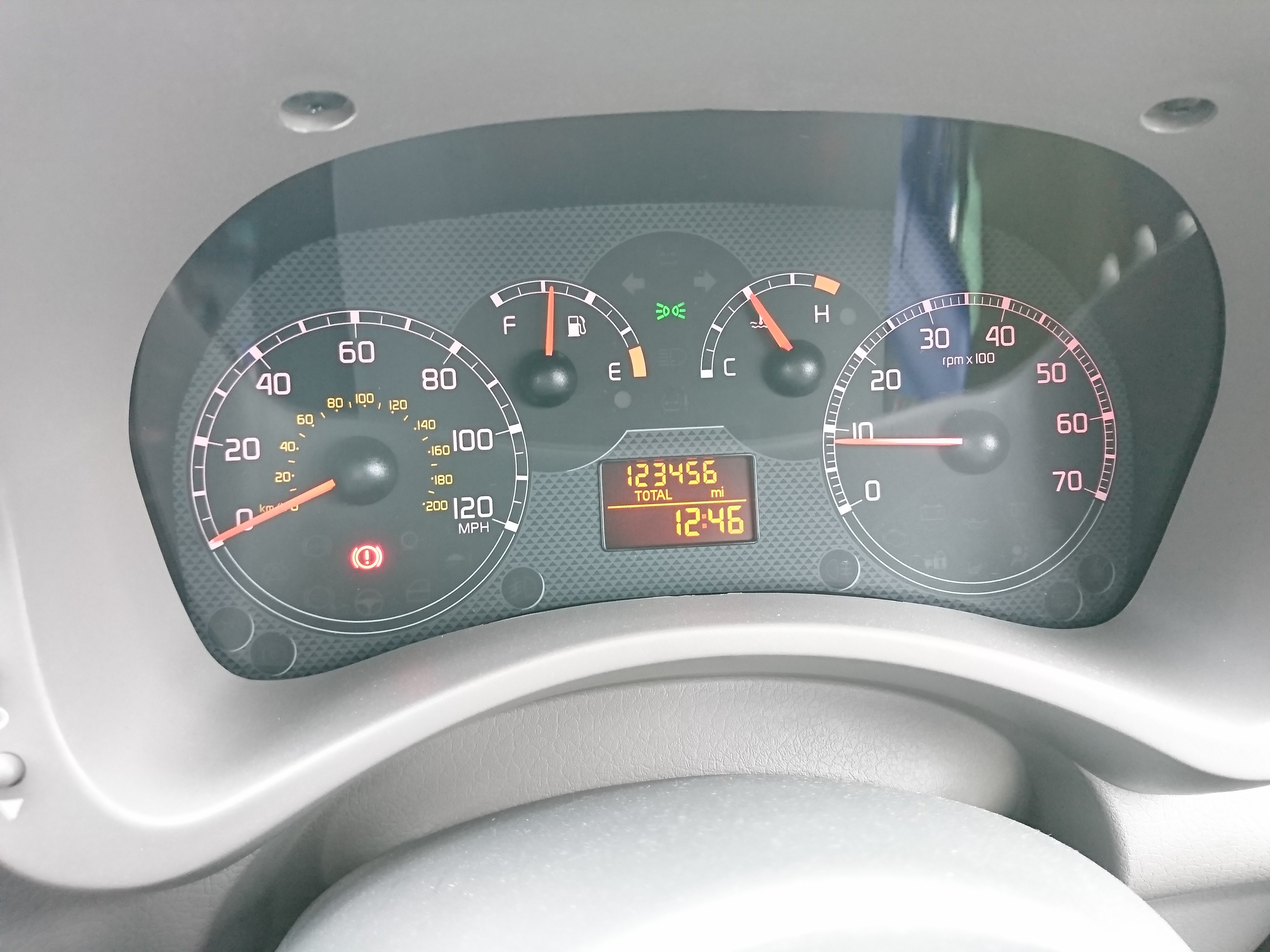

Next picture 123.456 miles? Pretty impressive though.
gr J(y)
Looking forward to that already! Probably this time next year or earlier given current use.

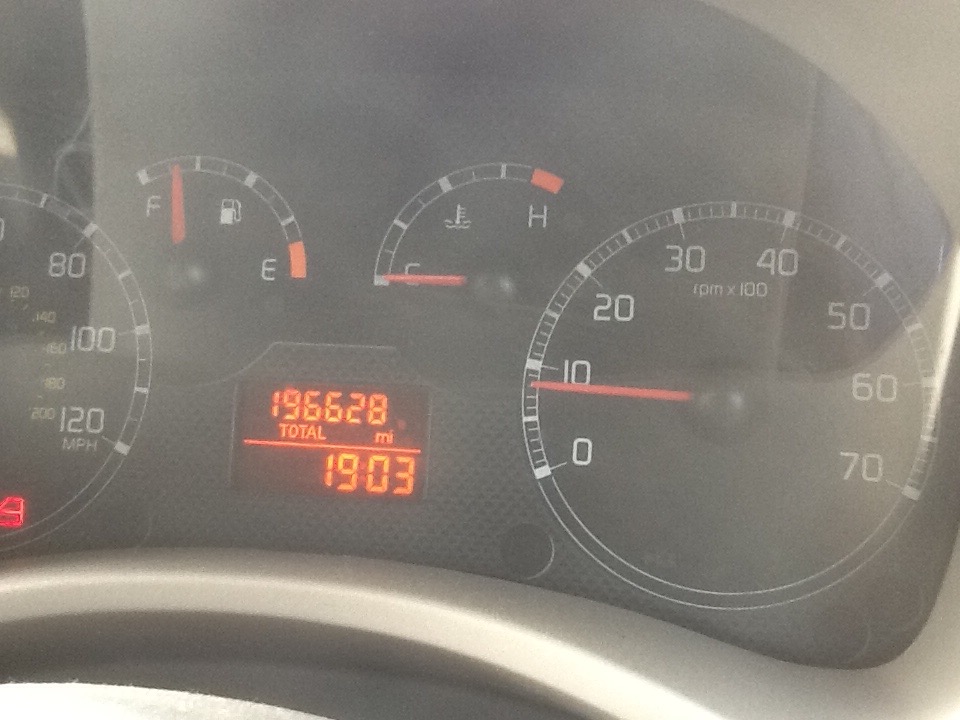

Soon be the 200,000 club. :)
