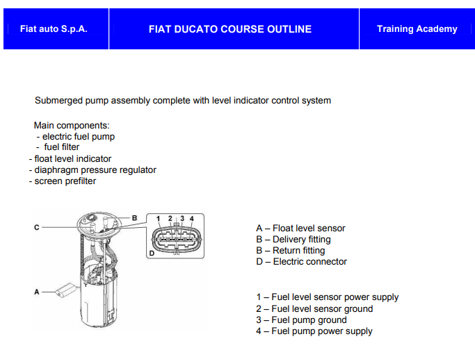

Fuel pump is between seatsView attachment 464611

I tried disconnecting the low pressure electric fuel pump under the floor beneath the seats by pulling off the connecting plug, but it had no effect - the engine still started and ran indefinitely. I think its only needed for priming the diesel, or when its very cold and thick. The rest of the time the mechanical high pressure fuel pump on the engine will suck the fuel through on its own. Which is a pity because that would have been my preference. I imagine the thief conking out a few metres down the road and needing to bleed the diesel would attract more attention than not being able to start the van where it was.
