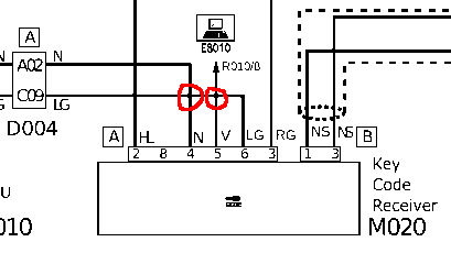

Further analyzing the schematics I came to the conviction that the scan is misleading/unclear at the two places marked by red. IMHO both should not show black dots meaning interconnection of horizontal and vertical wires?

Further analyzing without connections at the red circles my conclusions:
c) The wire going from Yellow LED E050 via D001 to Pin #2 of M020 is pulled by M020 towards ground in case of missing key.
d) In that situation M020 also signals it at Pin #6 to ECU M010 Pin #11 and this is how ignition is prevented.
e) My guess: Cutting this wire and and connecting M010 Pin # 11 to ground or eventually +12V or eventually keeping it unconnected would allow to start the engine without valid key number inserted?

You are grossly over simplifying the system. Please read the second paragraph of the descriptions that I attached to post #6. From this I infer that the communication between the code receiver, and the ECU is by encoded digital messages.
My pdf does not show black dots at the locations indicated. Fiat eLearn dos not use black dots to indicate a connection, and they should not be used at an "X" point, as wires should be offset to make two "T"s instead. For in harness connecions eLearn use an open diamond shape. For an example see the 5 wires joining near ECU (M10) at bottom RHS of same diagram.
I woould however agree that the diagrams could have been drawn more clearly, by removing unnecessary crossing of wires (lines). I have modified some drawings to achieve this, but it takes some time to do this.

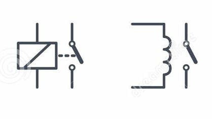

Regarding "relay" I have attached the relevant symbols, a similar one is also in Wikipedia.
@Irgendeiner your English is excellent, but perhaps we are losing something in translation. I have not tried to show a relay, but only indicate a connection to one on another diagram.
