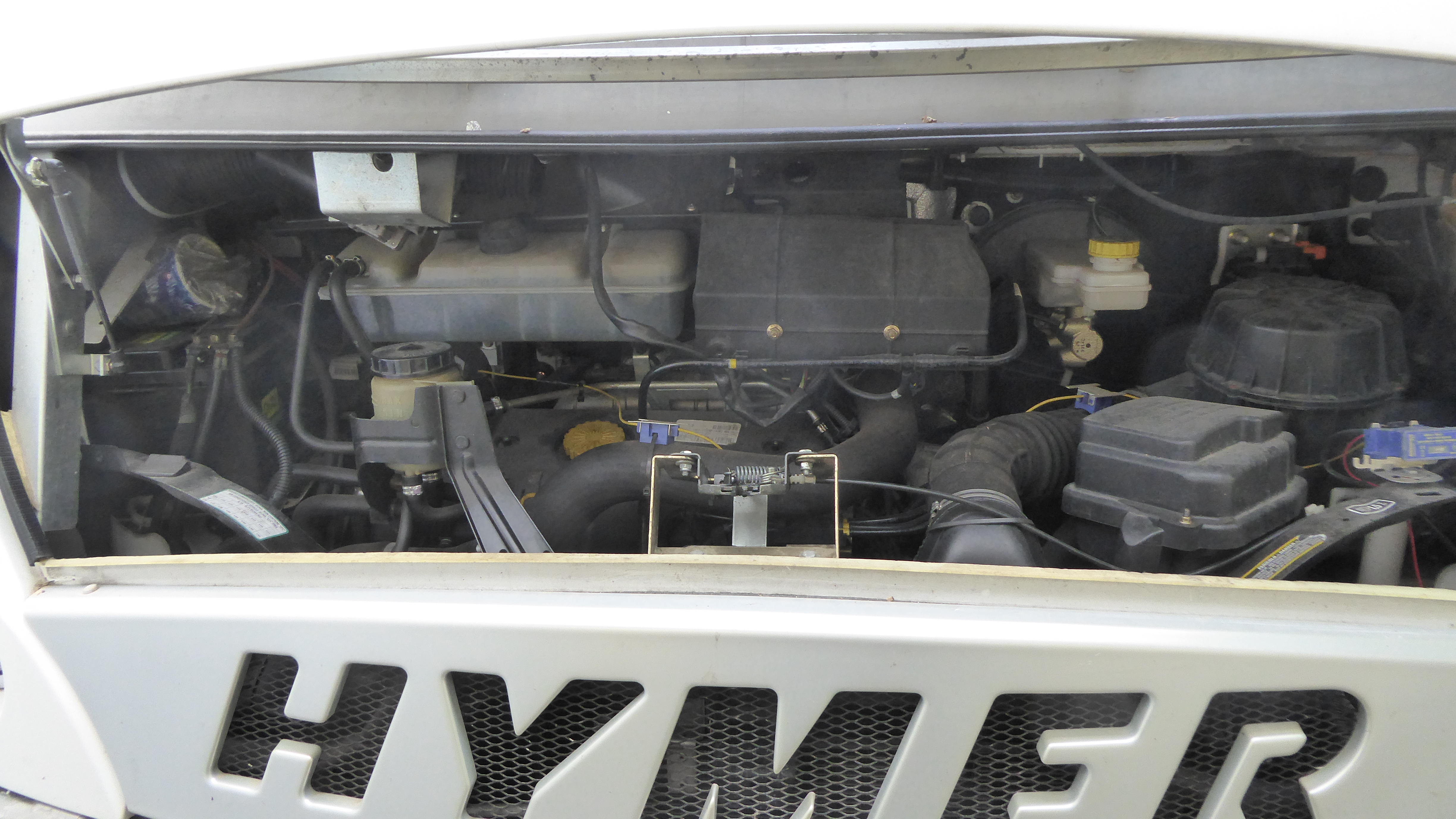

The attached photo shows the engine compartment. If that doesn't provide the necessary answers, please tell me which part of it I should photograph up close.

Thank you for your reply and photos.
Very interesting, as your engine is an 8140.43N, which is referred to as the "Power Version", of the 2.8jtd. I have only seen one or two others mentioned on this forum. Significant difference is that the engine has a vacuum operated variable vane turbo. Engine power output increases to 107kW from the 94kW of the standard version. Maximum torque is 310N-m, against 300N-m, and at a lower engine speed of 1500 rpm against the 1800 rpm of the standard versions. It should have better pulling power.
On your first photo immediately to the right (vehicle LHS) of the brake fluid reservoir, with yellow cap I can just see the fuel filter with orange electrical connectors. It appears to be the plastic bodied filter, which is reffered to as a "Green" filter. (Later filters were partly green.)
I will assume that the cold starting device is the flame starter, the components of which will be hidden below and behind the black plastic hood at the rear centre of the engine bay. The flame starter is the more common method.
Unfortunately I do not have edited diagrams for the 8140.43N, but the following link should take you to the correct "4cardata" page.
