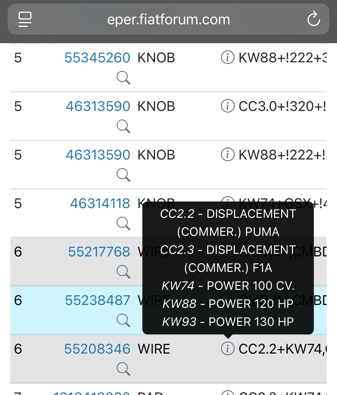

From what I can see from the information tab on the drawings, the earlier variants 2006 - 2011 don’t make mention of lhd or rhd, but post 2011 this can become relevant.
Just in case you hadn’t located the information tabs, they are as per below images

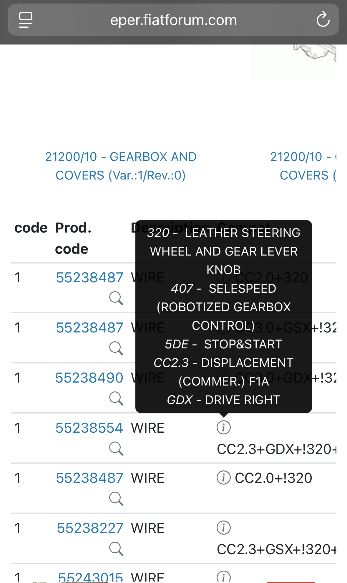

This first image is from the lists for 2006 to 2014 showing that lhd & rhd doesn’t feature - however the 2nd image shows that between 2011 to 2014 the lhd/rhd choice did exist, so no wonder you’ve struggled.

This is the number i get 55228970
on your second black information box at the bottom it says 'drive right' AKA which suggests right hand drive.
i was hoping to get the arts before taking the old cables off.
It does say drive right on my 2nd image, but that is not applicable to the part number you referenced.
If you look on here this vendor has provided a supercessions list at the foot of the page which shows that all 4 available part numbers in the column you have provided are the same component design/fitment.
Supercessions can be components modified to improve or nothing more the a different supplier to the vehicle manufacturer.
It would be worth a call to Coastal with your VIN for reassurance before ordering.
