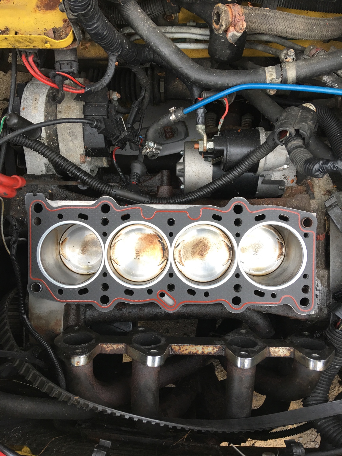

Currently the heads off the engine it come with every thing to refit but some how the inlet manifold has been broken so I need for find one or another head with one and needs the rear callipers re fitting the are brand new in a box in the boot i've looked all over and the only rot I can find is in the wheel arches
So the game plan is to get it running and driving so I can make sure the running gears okay then straight onto getting her looking nice
Now boost is loading I am in the process of buying parts as and when they come up forsale or Making it myself but so far I've got a manifold and decomp plate

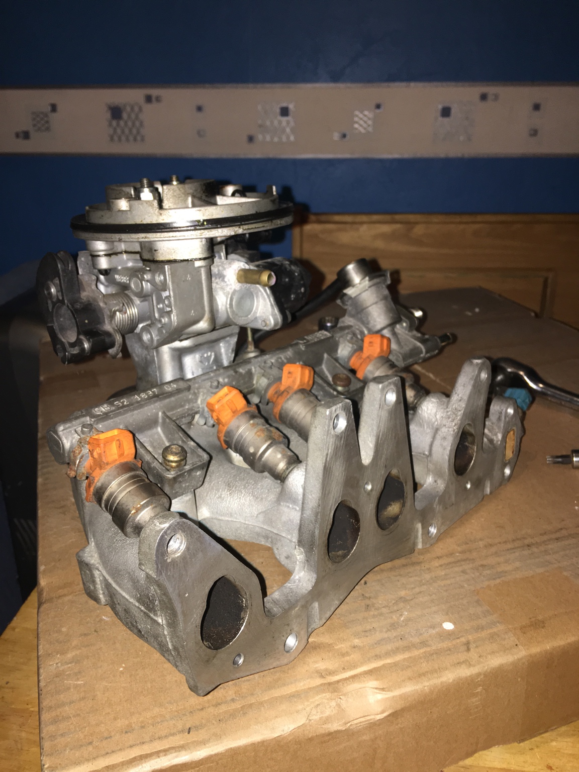

Small tiny update but kind of big news guys i'm pregnant no serious and inlet manifold has arrived definitely more updates to come this weekend weather permitting

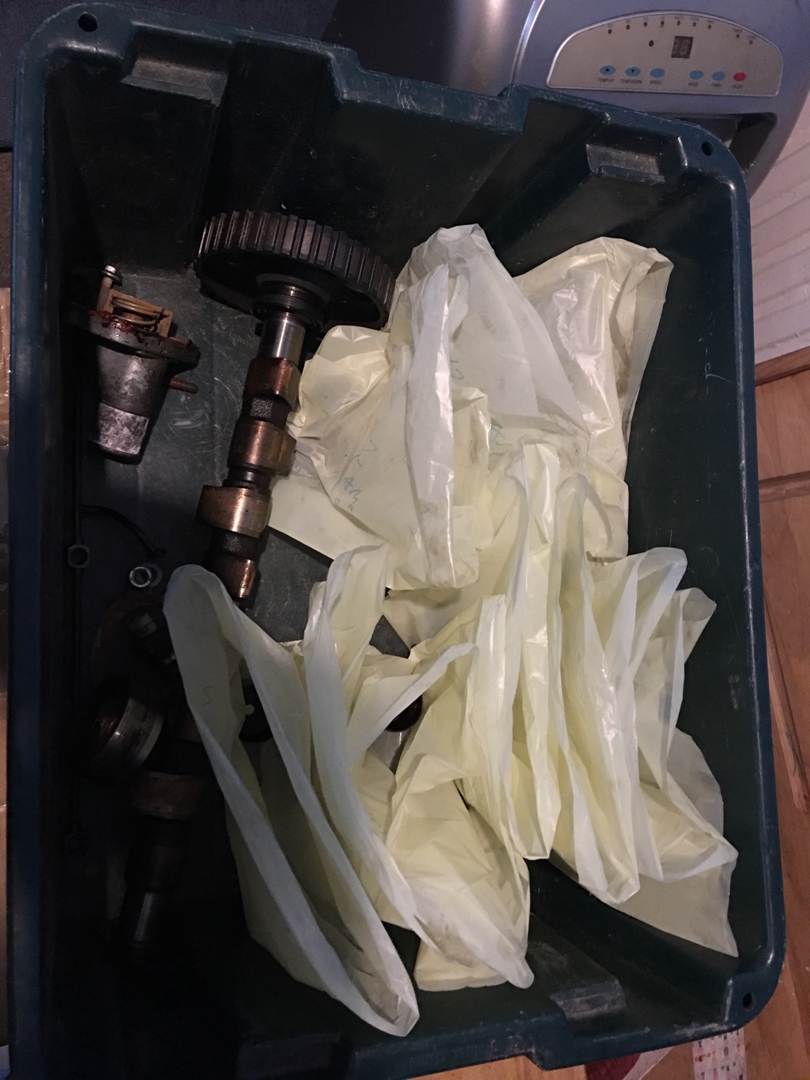

So over the weekend I decided to get the head striped and labelled up so I can get it sent to be skimmed,new valve stems ect

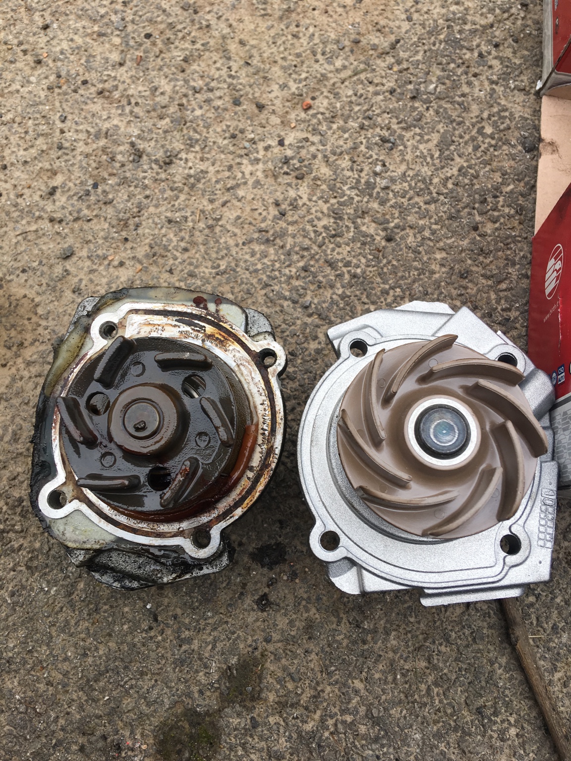

Well it was all going well until I went to put the cambelt doesn't fit my pulleys I ordered it for a p75 and it also doesn't fit the spare p75 pulley I've got in the shed so I guess s4p sent me out the wrong timing belt kit or fiat changed the pulleys somewhere along the lines but got one matched at euro and it's getting dropped of to work Monday at work just gutted I couldn't get her running today but next weekend she will be
Re: Hensey's 1242 8v turbo build
there is 2 different timing belts for a 75.... I discovered as such when i was looking for new belt for my p75 panda conversion. I found somewhere that said upto x engine number and a different belt from the next.. number of teeth on belt is way different so you could just count them on old belt to be sure.... Thinkit was Mister Auto website that had them listed by engine number but i can't remember for sure....
Yeah basically what Euro said when I took the old belt and new belt into them to match it s4ps don't even list another belt for the p75 so I've got a nice new waterpump and cambelt that I can't send back because I've used it ah well lmfao
