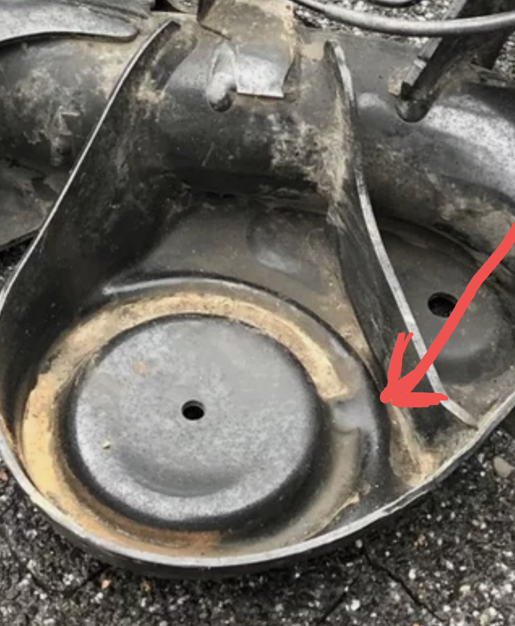

Does 2011 fiat panda rear springs bottom end need some sort of rubbers ie doughnut shaped that sit in the carrier to suppress knocking noise. I noticed at the top there is one but the bottom seems to be steel on steel thanks
There's only one at the top
The bottom has a locating ridge on the axle, so it needs to be turned so the bottom of the spring lines up with it
Here's what I mean
Couldn't find a decent photo, but it's more obvious when it's in front of you
It's slightly shaped so the spring has to be rotated to match
Here's what I mean
