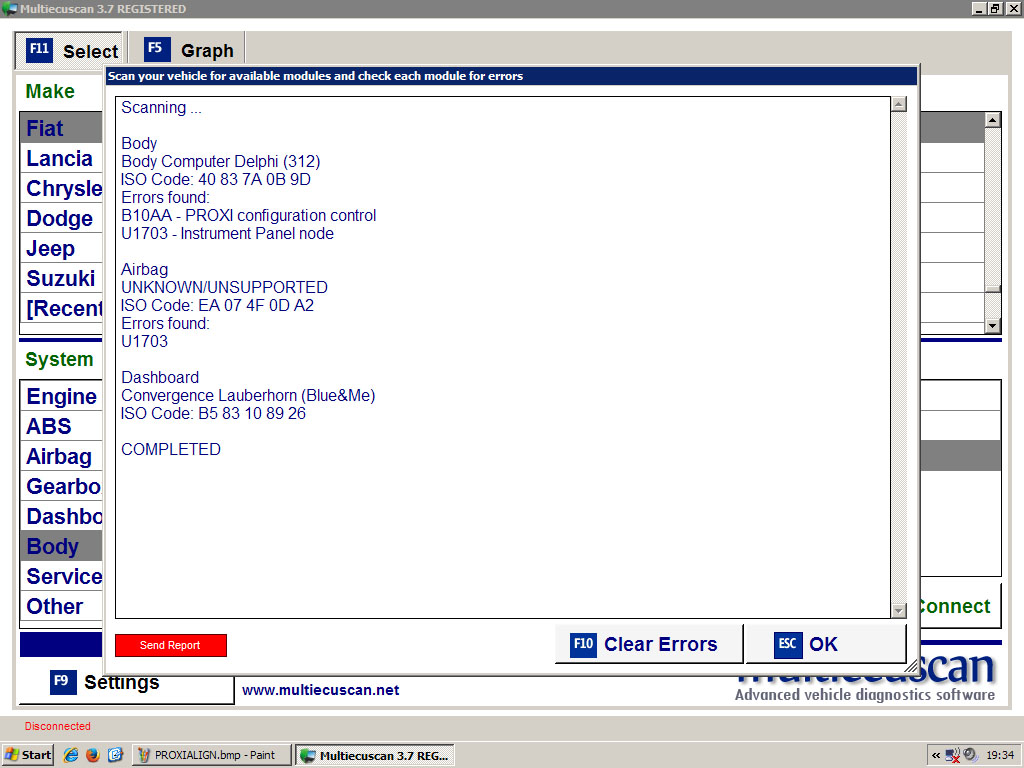

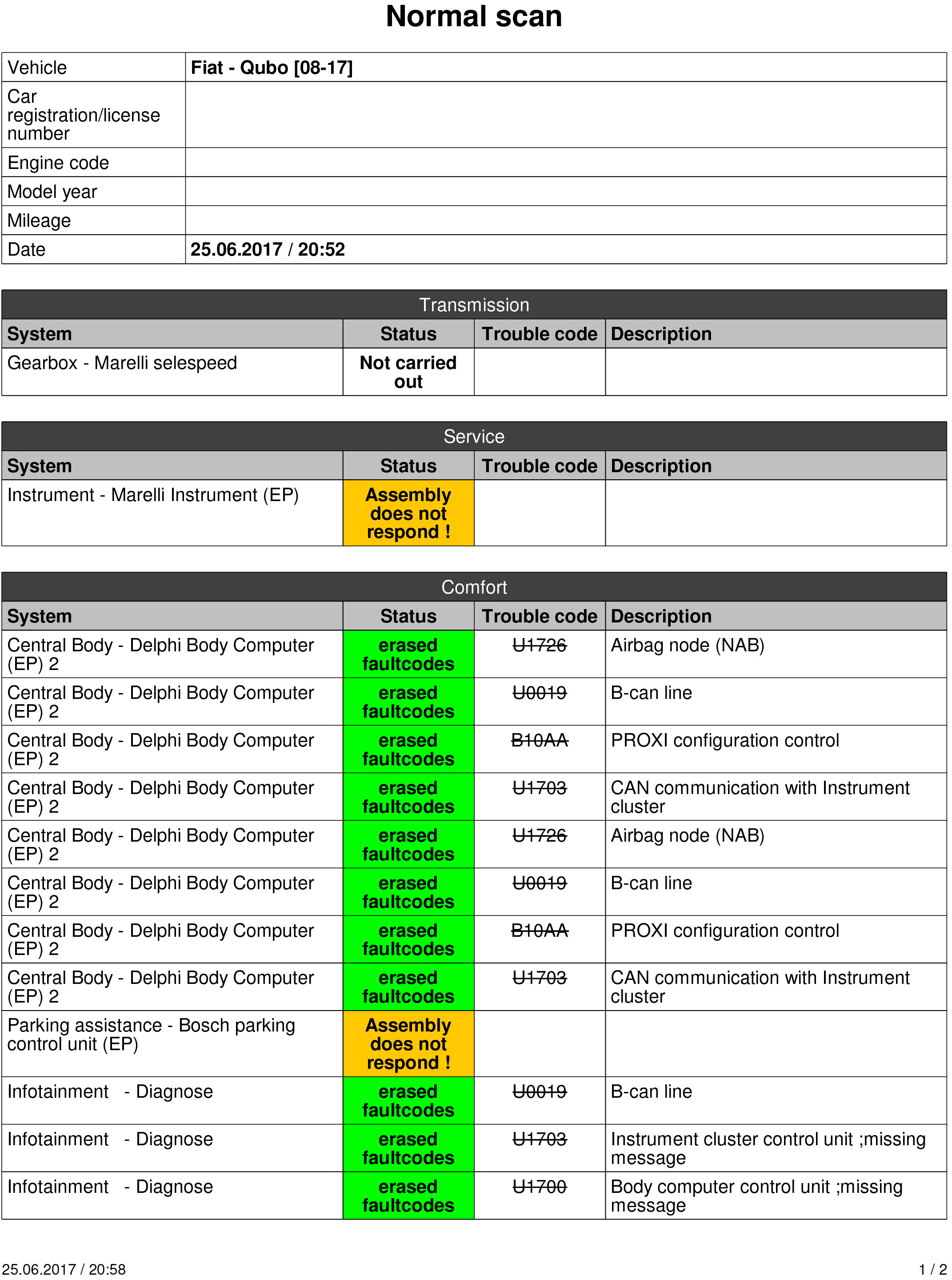

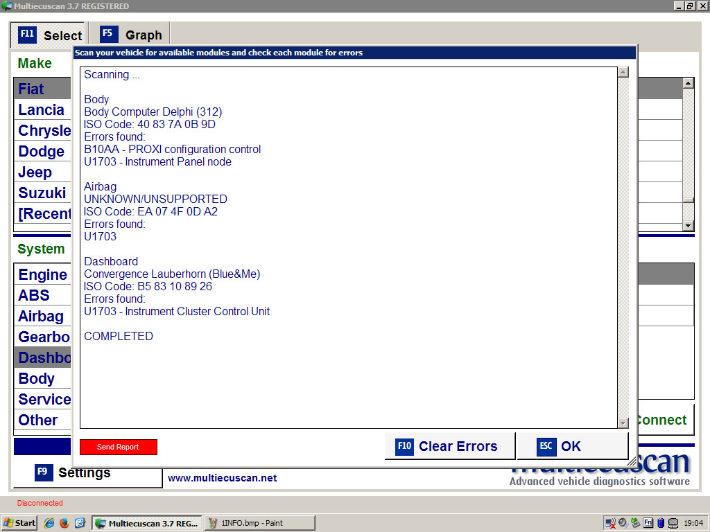

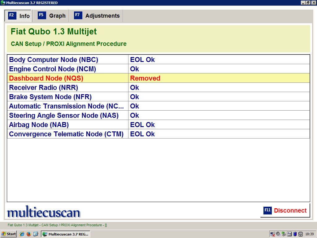

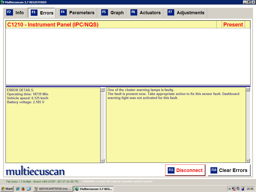

Okay!! Get ready for this...

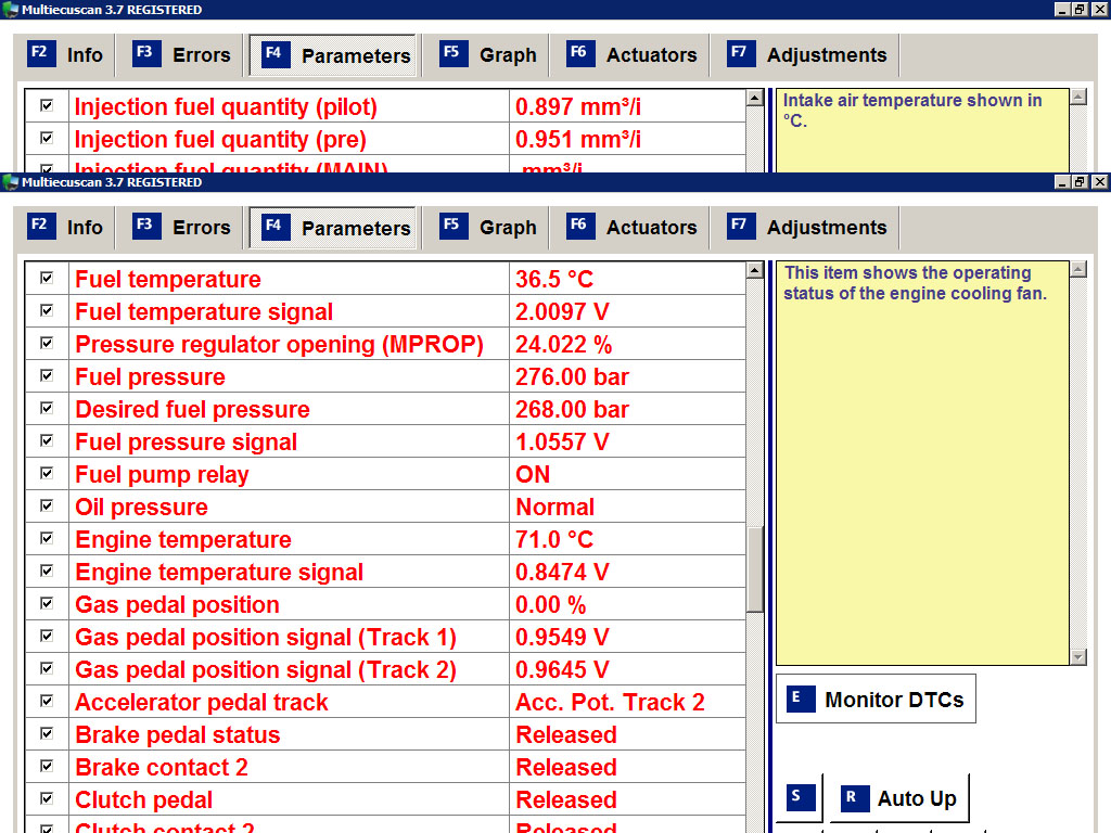

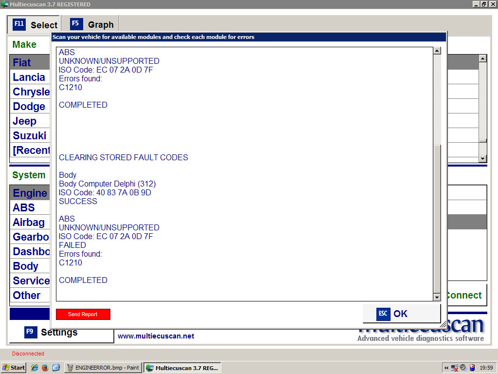

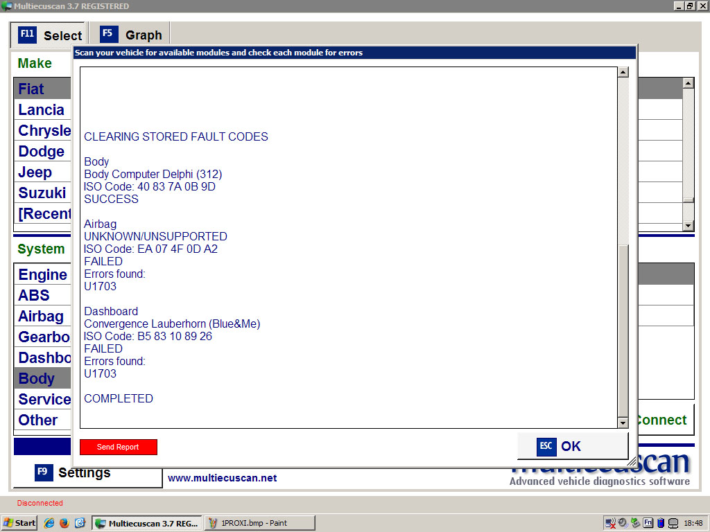

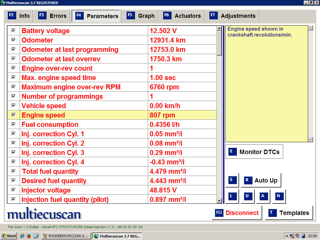

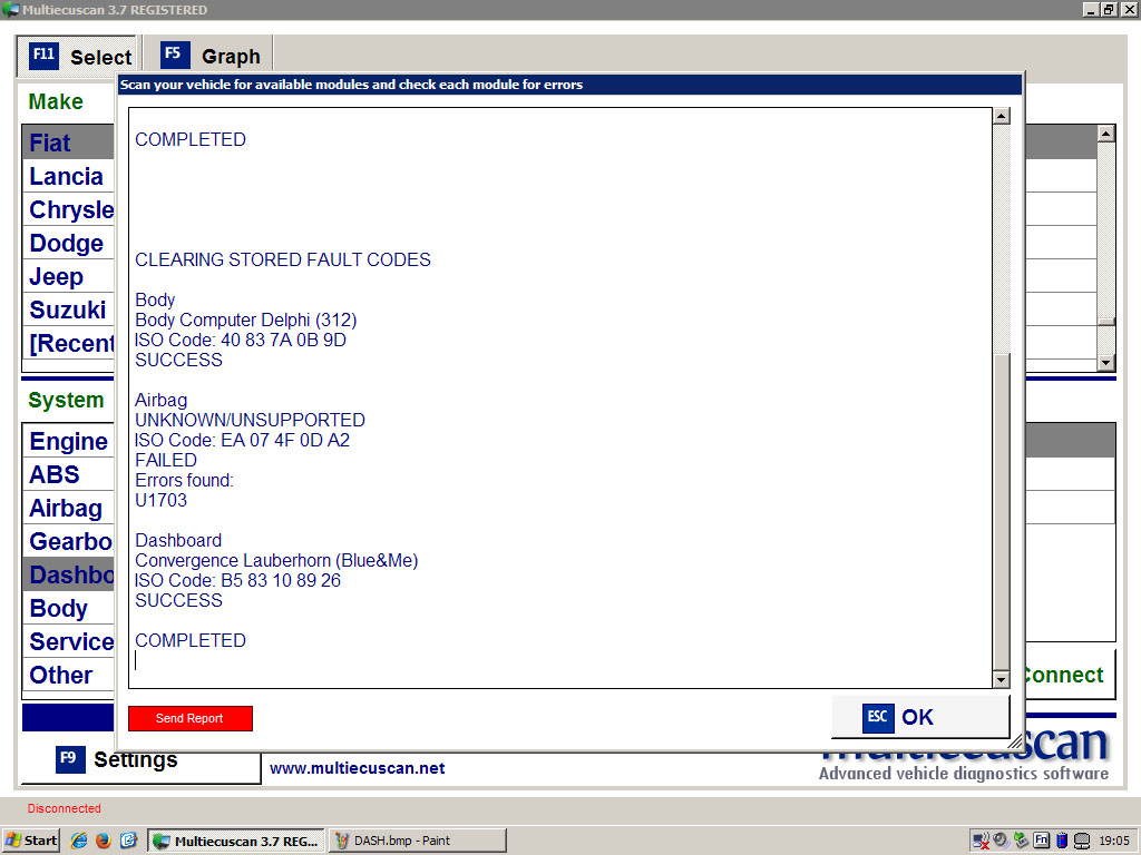

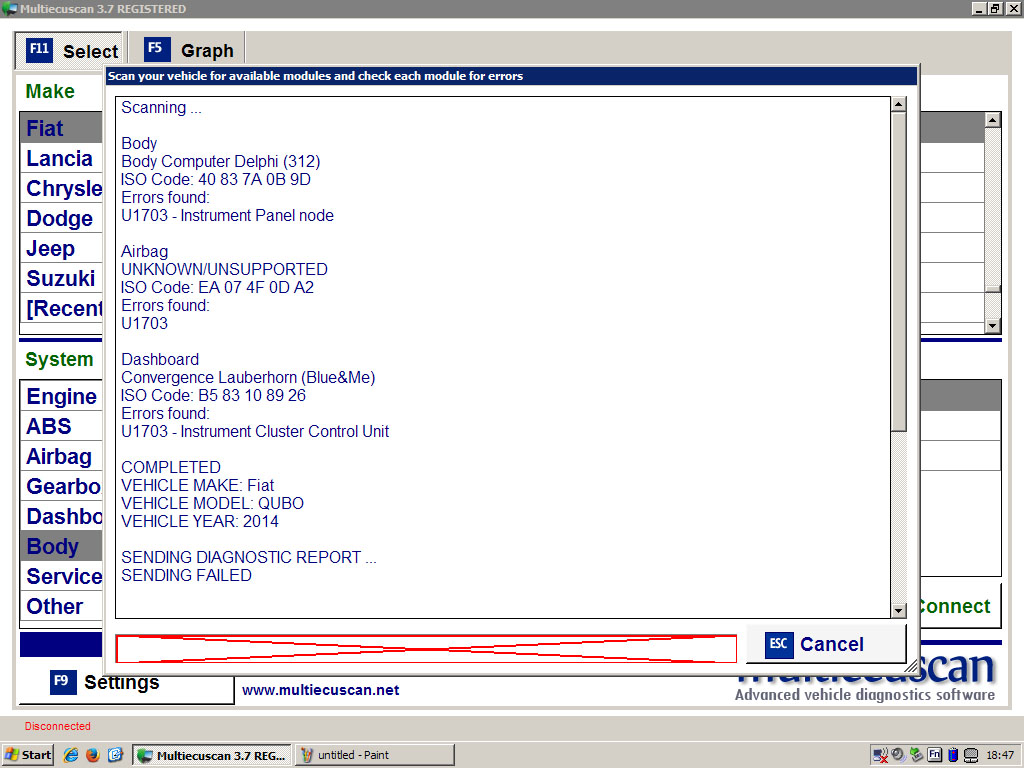

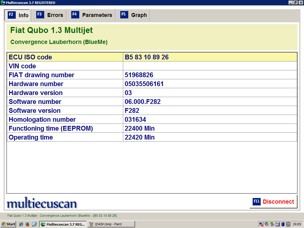

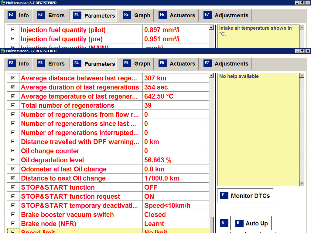

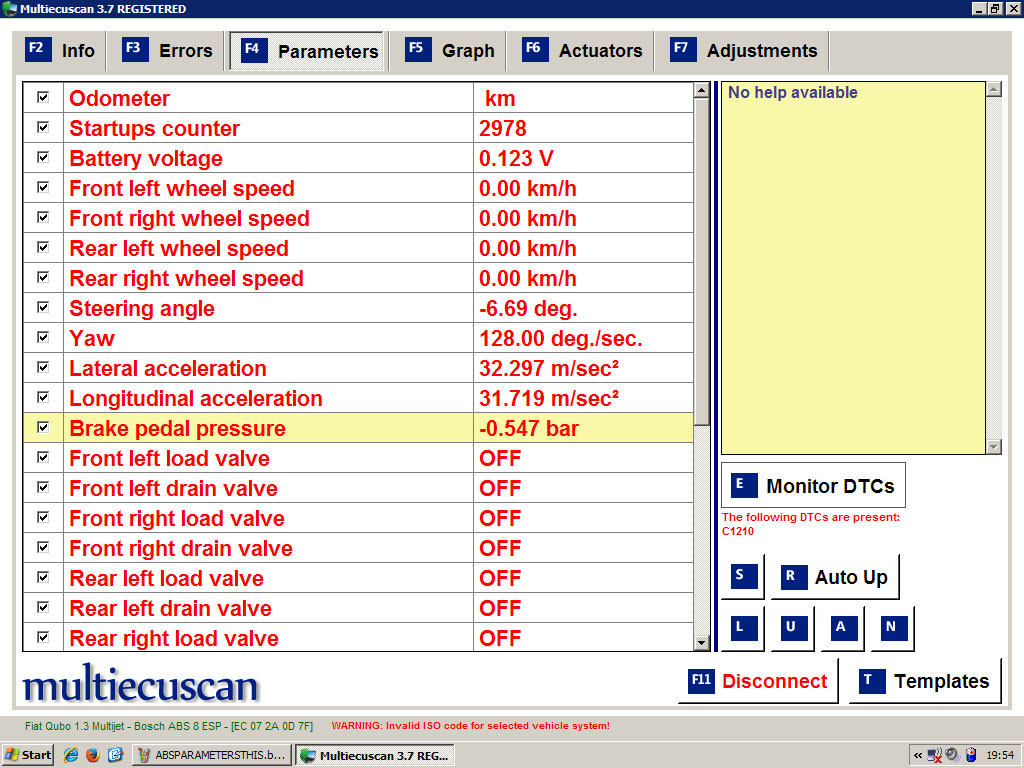

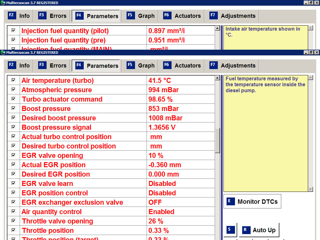

Great guys at Gendan in Swansea set up my Panasonic toughbook with a genuine 3.7 Multiecuscan and OBDLink SX kit and did a full diagnostic as well...
Here are the results log, screen print etc of my Airbat Fault etc... Any ideas after reading the this very lengthy post?

:D After advice from Yani at MutiECUscan in email, (BIG THANKS MATE and respect!)
Tonight I checked the wiring from the instrument cluster and managed to clear the fault. It was in the wiring on the fuse line for the cluster giving a low voltage and throwing up the fault. All clear now :) parts used 20cm of wire soldered in place and heat shrink to cover. Clear faults, proxi alinment not needed! All great. No thanks to Fiat dealer who left me high and dry when vehicle is still under warranty! And vehicle disabled adaptation specialist who said the fault was not theirs! Bloke in a wheelchair with a MultiECUscan and laptop and support from Yani got this sorted. Brilliant! Thanks :-D
