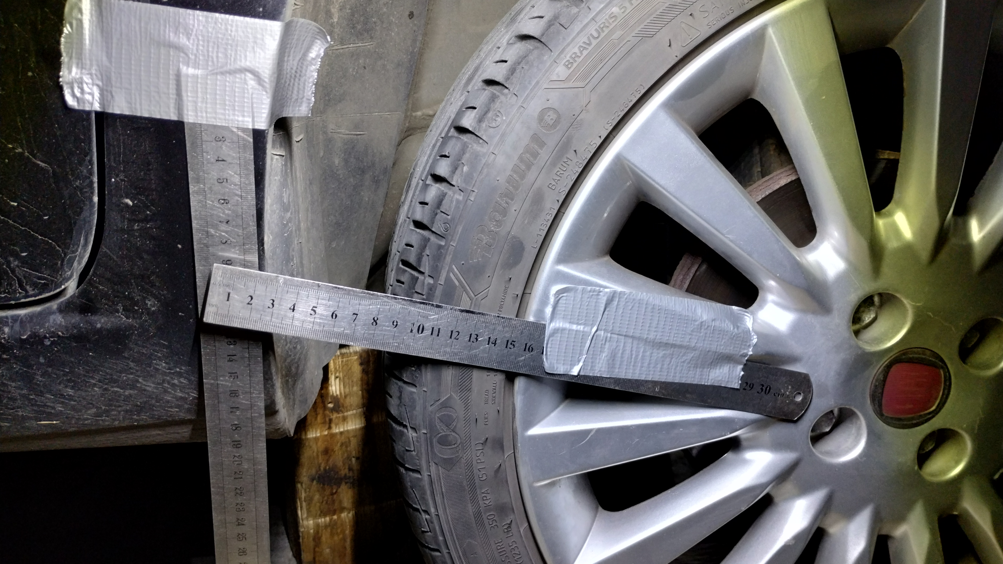

Back to the subject. I did some lame quick "test". "Play" in the gearbox. Right wheel (long axle) off the ground.
Results (gear, play in centimeters).
1 - 5 cm
2 - 6 cm
3 - 8 cm
4 - 8,5 cm
5 - 10 cm
R - 5,5 cm
Example video (R gear).
Completely non-scientific (should be angular measurement), but we have something to compare now.
Stationary "test drive" (video is too big) was also done = no "jerking" like in the thread author case.

Today I did test with right wheel. I used two piece of wood, full straight.
I used level gauge to tape vertical wood in vertical position.
Wood on wheel in taped to center of wheel.
I put masking tape on wood, mark with pen then measure for every gear.
Here are the resaults:
1 – 5.5 cm
2 - 6 cm
3 - 7 cm
4 - 7,5 cm
5 – 8.5 cm
R - 5 cm
I know this is improvisation and not precise measurement but I would say mine measures are more consistent than your’s. :)
Maybe that play in diferential is so small it cant be measured like this? But cause big impact on drivetrain.

The "test" shows, that mine g-box is probably worn more, but there is no "clunk/jerk" whatsoever like in your videos.
So what's (or where is) the difference between cars?
Example (what could be wrong, resulting in violent operation of the clutch).

As an amateurs/hobbyists, we have no better "tests" (the point was to spot excessive "play" in one of the cars). Next thing is what...remove the gearbox and inspect it (and the clutch)?
OP claims, that suspension/mounts "are OK". What else is there, CV joints/axles...probably "OK" too(?).
Not really sure what the wheel test thing was doing, every car I've had (with no gearbox problem) moves that way in a clunky manner
