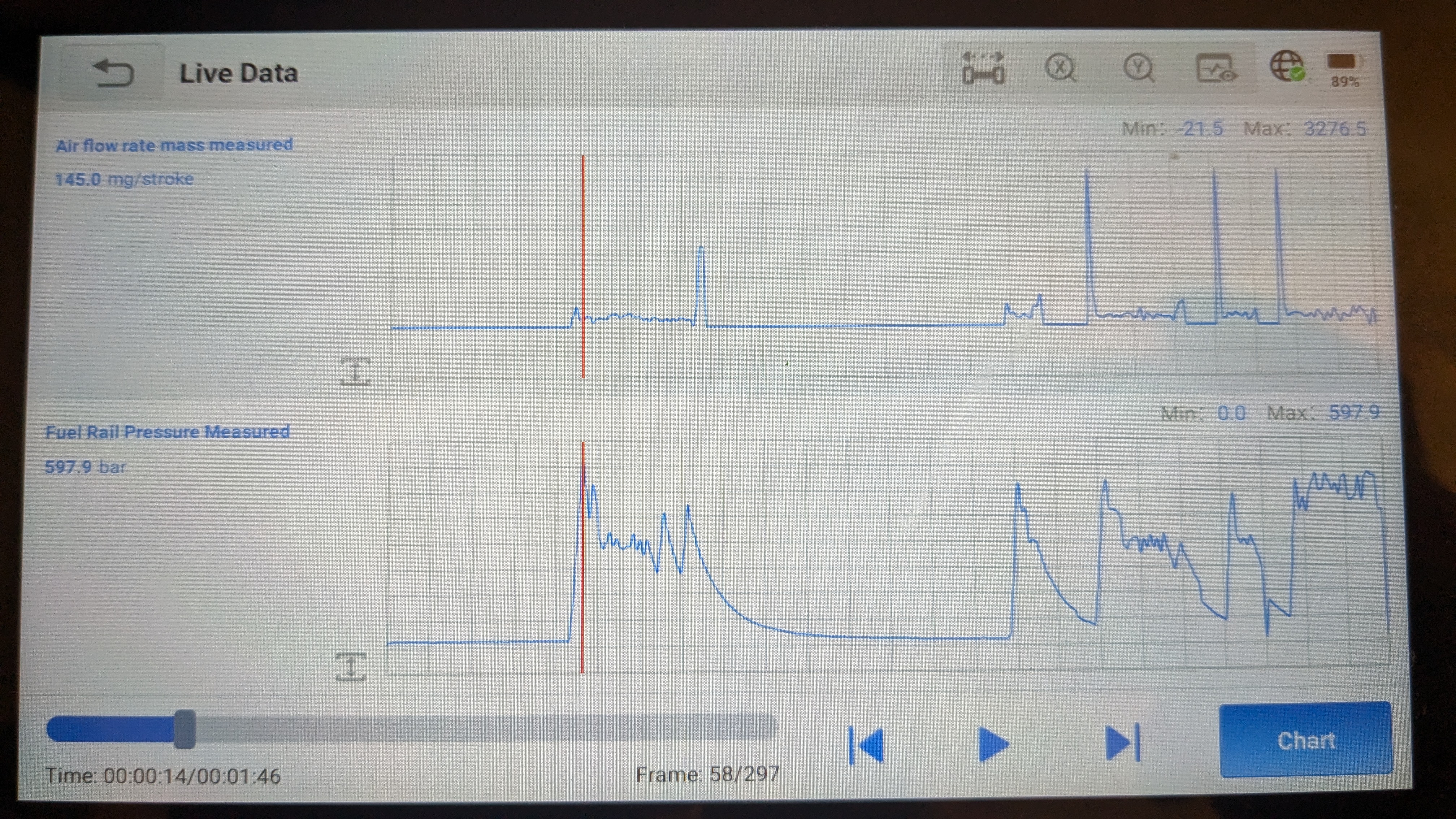

Fuel rail pressure reaches 600 bar but drops right off after cranking. Cranks about 680 rpm at the peak point

The ECU needs to see High pressures in the rail or it won't permit injection
IF it runs briefly.. See what rail pressures show then 🤔

As in the previous pic of the graph,the rail pressure reaches 600 bar at cranking. My friend just tested his traffic and that reached 300 bar for a turn when it fired it went down to 250 bar when running.
I need to know what pressure at cranking should be . If 600 is too high will it cut of the fuel? I need to check the fuel cut off relay is not energised etc
I disconnected 1 injector at a time to see if 1 was open causing pressure drop but no difference.
Just found this statement
  • The pressure to deliver fuel from the high pressure pump to the rail/injectors at cranking is around 200 bars, at idle the pressure should be around 300 bars. When the vehicle is running the pressure ranges from 1200 bar to 2000 bar.
