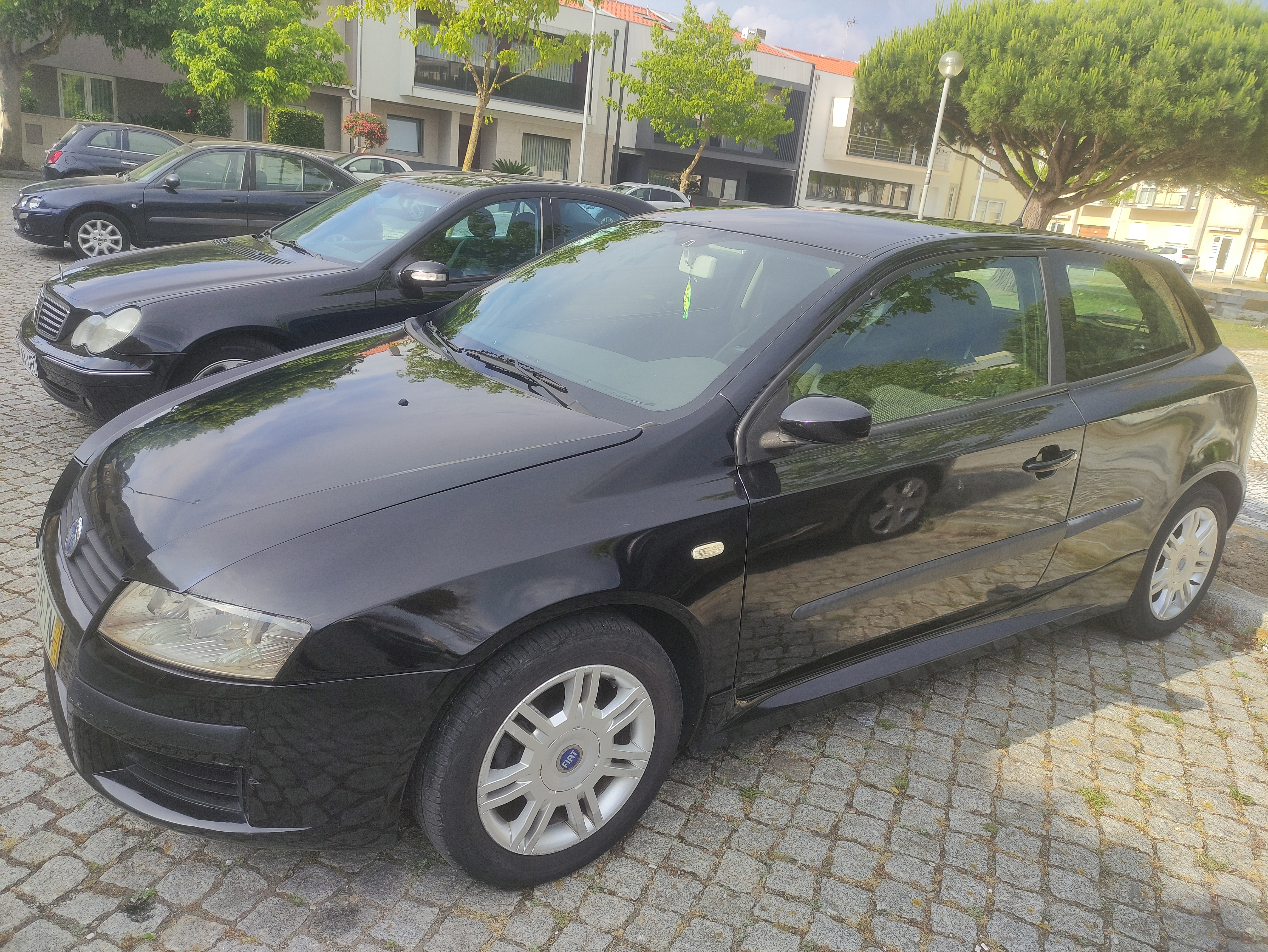

Yes, I changed all this, tested 3 air mass sensors, I just didn't change the TBI body, looked at the engine psychologicals. And I gave up, I sold the car today, the same happiness I bought for liking the car, and being several years old (it doesn't compare because it was in Brazil), and the same happiness of having sold it here in Europe. haha I'll be quiet for a while, and then I'll see what trouble I get into, after all, my life is about solving problems and solving them, and then looking for more problems. 😅😅
I appreciate your great help, thank you very much!
Black is the problematic European.
And gray is what I had in Brazil, it was just happiness.

I have to strip this 'Black' one down again cannot get oil pressure, so cam belt off again and sump off. must check the big ends for any damage. Probleo when you buy cars that have a broken cambelt? lol All good fun in the great metropolis. Hey Buenos suertes para ti gusta mucho gente de Español ee Latina gente tienes mucho corazon. Escucha mi en Áudiomack ee SoundCloud yo es en Spotify tambien algo triente plaza´s en el mundo los Musica de Campo. Country Music . Hope you understand my Spanish I learned it in the street of the 6 years I was in Spain Hasta la luego Guix. Like the pics.

The black one is exactly like mine!
Congratulations! Fiats are quite poorly kept so take your time to find another hidden gem that does not have issues. (y) Usually most of the car electronics just don't fail like that unless it had been in a flood or someone drove it to the sea. Good luck!
