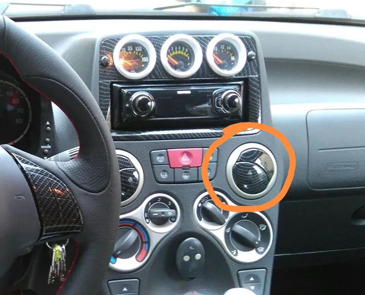

I kindly need your help with the airvent of Fiat Panda 169 from 2008. My small kid pull of one of the central airvents ornament and put in the car keys and also the keys of our apartment. Is there any possibility to recover the keys from the air system? What parts are needed to be removed to have access at the area where the keys may be?

Here's an old post describing removing the vents, in case you need it. Good luck!
If you look inside the vents you can see clips that goes out and locks the vent in place.
Use a small srewdriver to move the clips to the center off the vents and pull the vent at the sametime, If you start with the one there is broken I'm sure you see what I mean.
