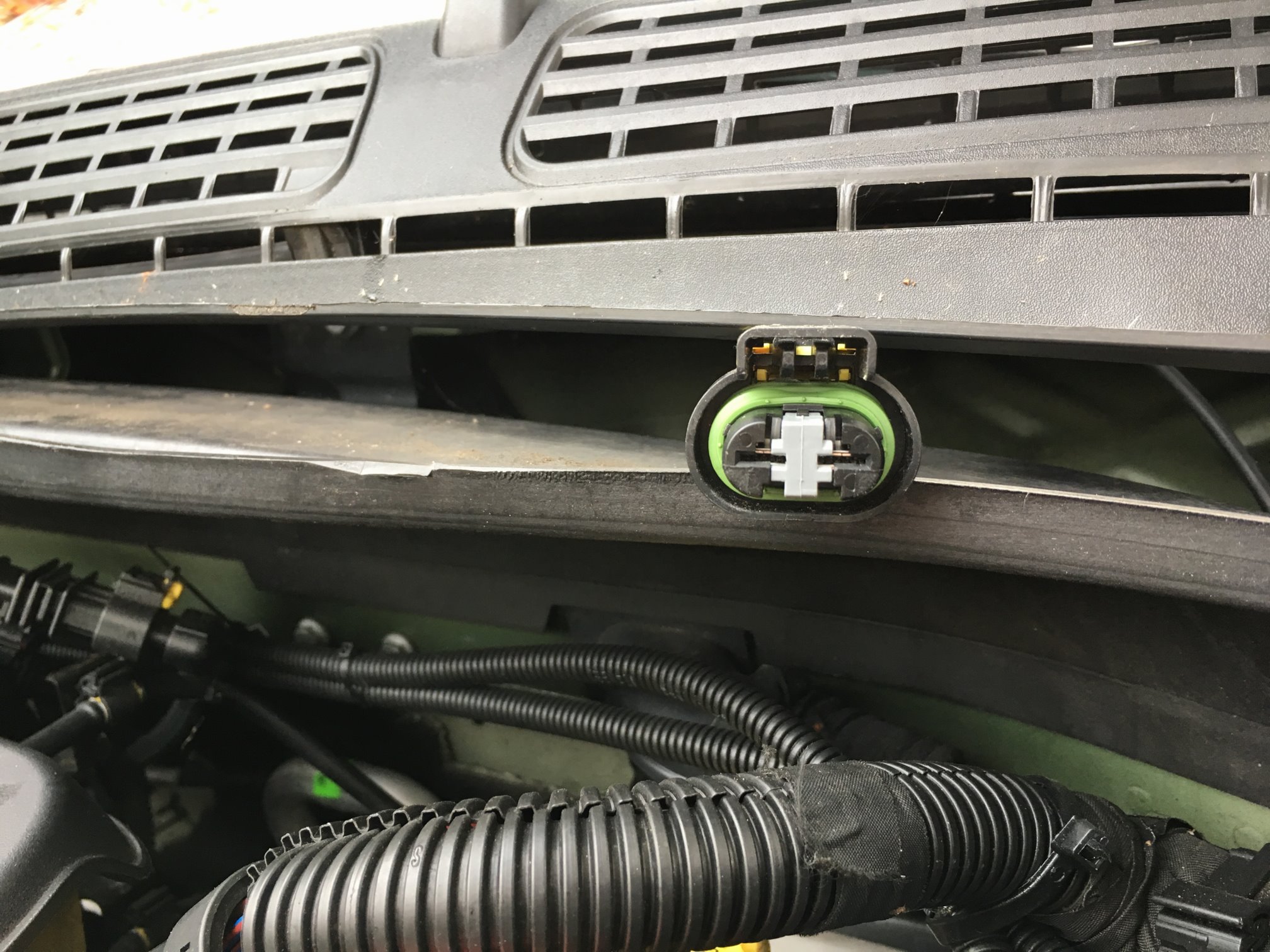

There are definitely two connectors one per side underneath the windscreen scuttle. When my screen was replaced these had to be disconnected/reconnected. The panel was easy to remove and the connectors clip into a moulded plastic clip on each side. Certainly an easy thing to check and fix if it's just a corroded connector.

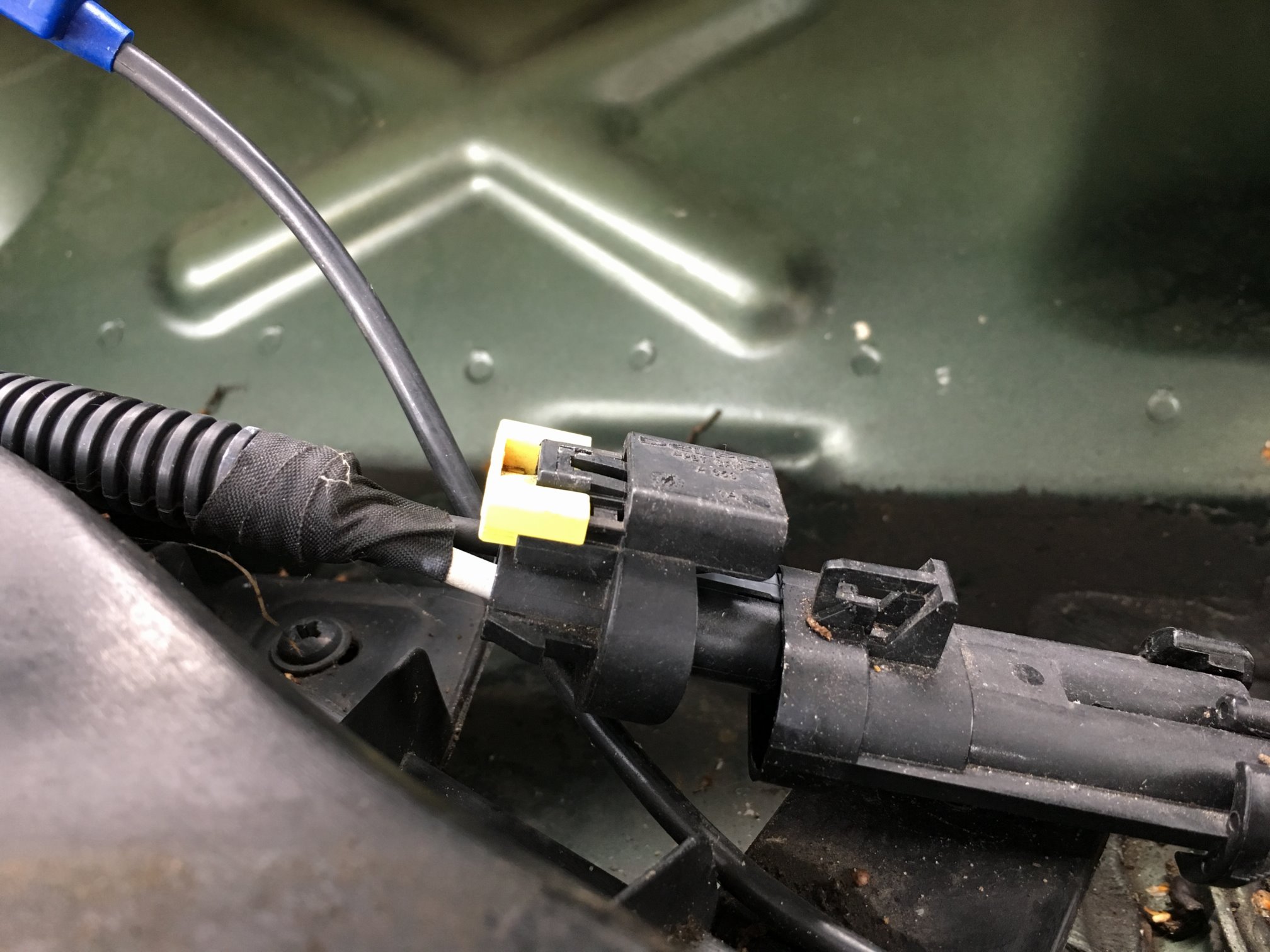

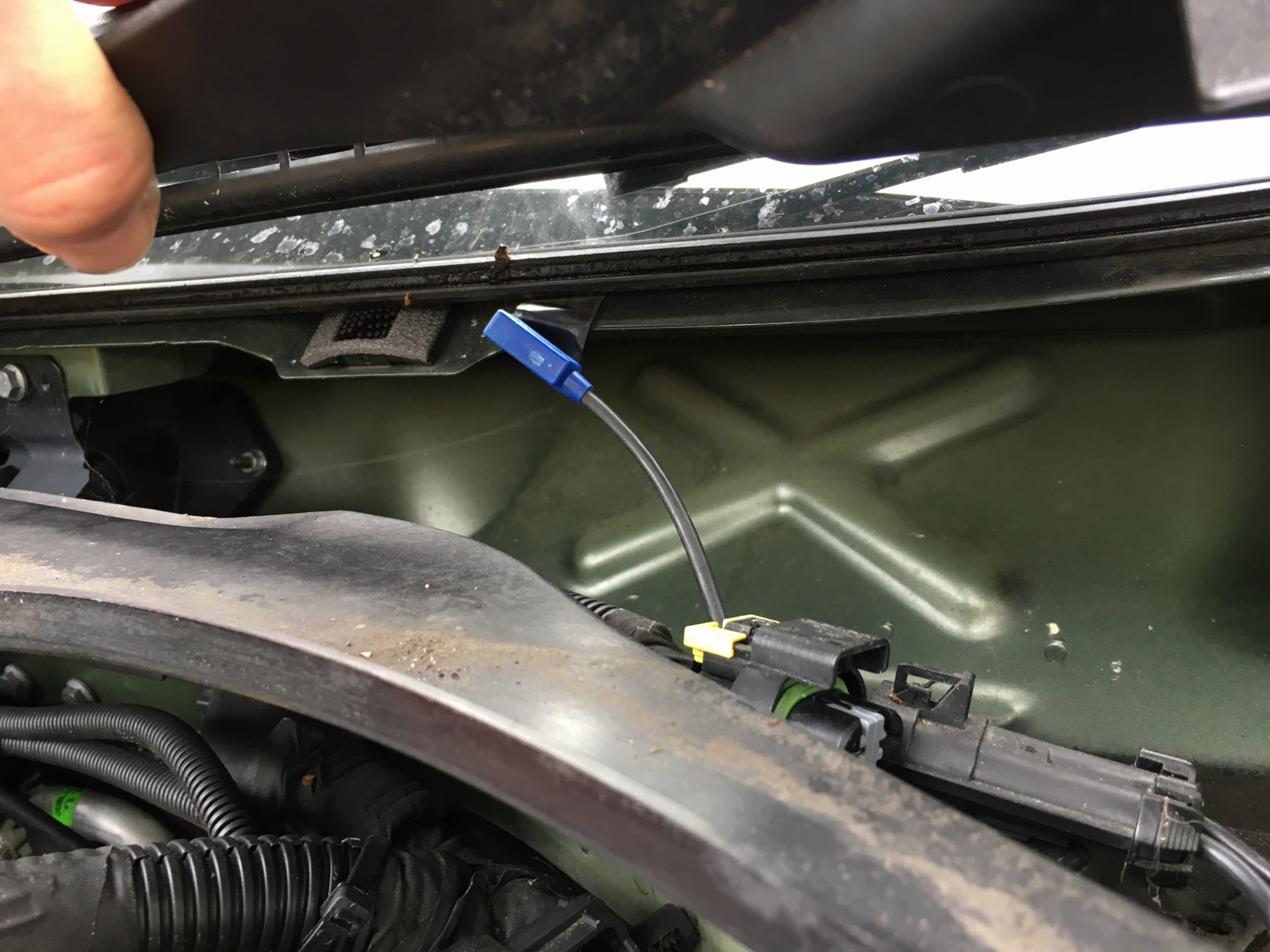

An update on progress so far, albeit one without a solution as yet. Scuttle easy to remove and as other have said, the connections are easy to see. One pair of flexible 'ribbon' type connection on each side - a Positive and a Negative, going into a typical waterproof harness plug. So far so good.

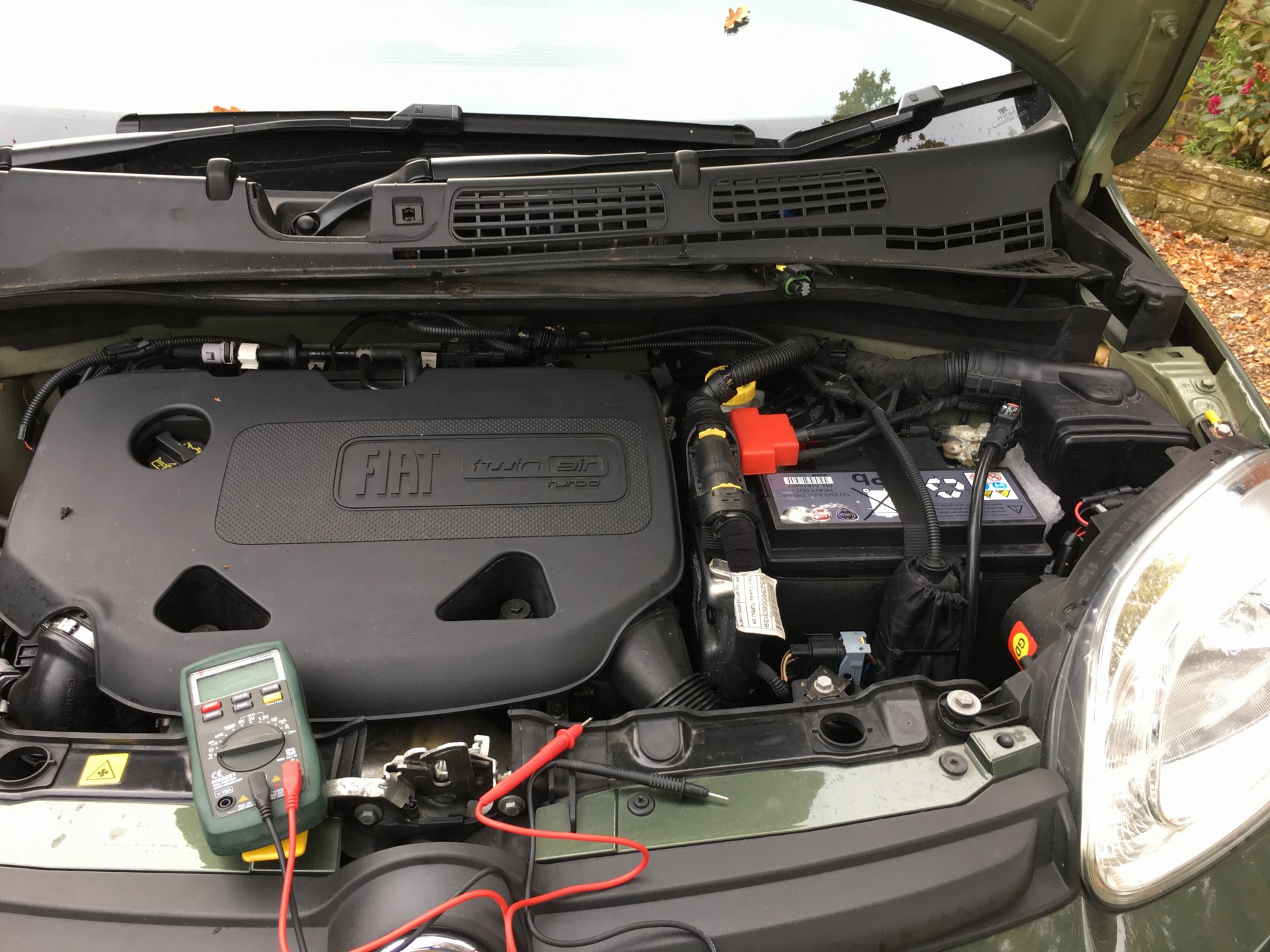

I switch the screen on and having disconnected the 'broken' side connector, tested for +12v at the harness terminal - nothing. OK, so that looked to be the problem. As a check, let's do the same on the 'working' side plug to make sure that +12v is available there when the screen is on - Nothing too. Ar$e. Suspect there's some CANbus or relay magic going on somewhere, so little else I can check at that point. (NB: Since then I've found a very sharp and pointy testing tool that is designed to pierce a tiny hole though the insulation of a closed connection like this and I will try again to see if there's any juice flowing). It then began to rain hard, so I put the car back together and retired to consider next tests.
So today I plan to pop the connections once more and this time test continuity across each side of the screen. Clearly the 'working' side will measure continuity, but maybe the 'broken' side will not. Those ribbon connectors do look fragile and prone to fatigue failure, so I need to see if this is the case. If it proves to be, then a new screen is in order of course. If the screen is OK though, then I am struggling, as all of the fuses I can check are OK.

More tests later then..... but in the meantime, some pics of the connections for future info.

Further update, but with the definitive issue identified. Having discovered I had one of those very sharp, tiny needle-like electrical testers, I was able to fire up the screen with it connected and then 'probe' the power feed for 12v. Both sides of the screen are being powered, so that discounts any fuse or relay problems, which is good.
I then tested continuity on both elements and sure enough, the passenger side is open circuit. No manner of bending, tweaking and rustling the ribbon connections made a difference, so it looks like a new screen is required. Maybe this is the prompt I needed to deal with the massive stone chip on that side too....
Anyway, just glad that it's not a deeply buried wiring issue anywhere! Still annoying, but easily fixed I suspect, as long as I can get the screen with the City Brake Control format of course.
