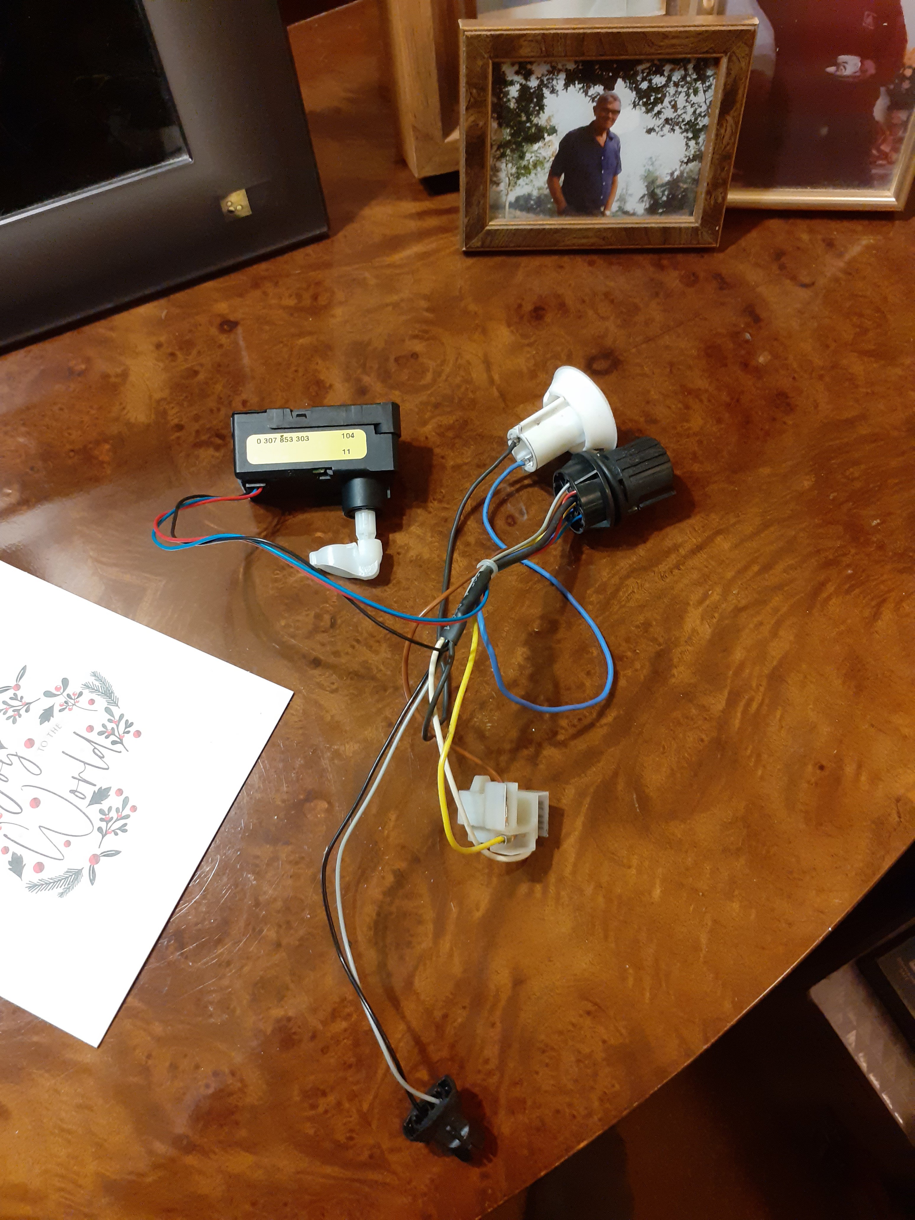

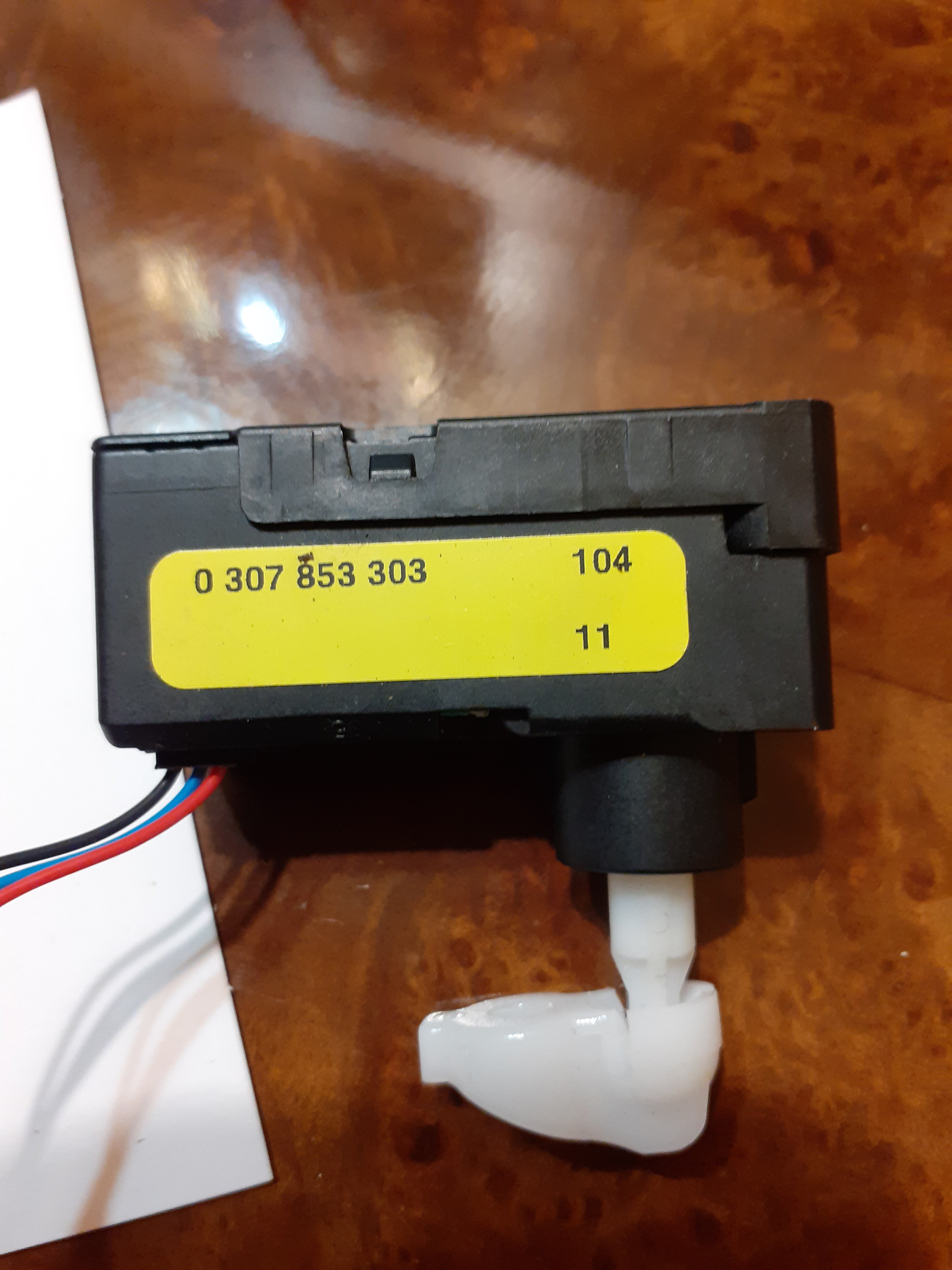

This is the spaghetti from inside a Panda headlight. The part number on the motor is visible. If this part is of any use to anyone I have it available and dont want it. Just kept out of curiosity. It might be common to lots of headlights
