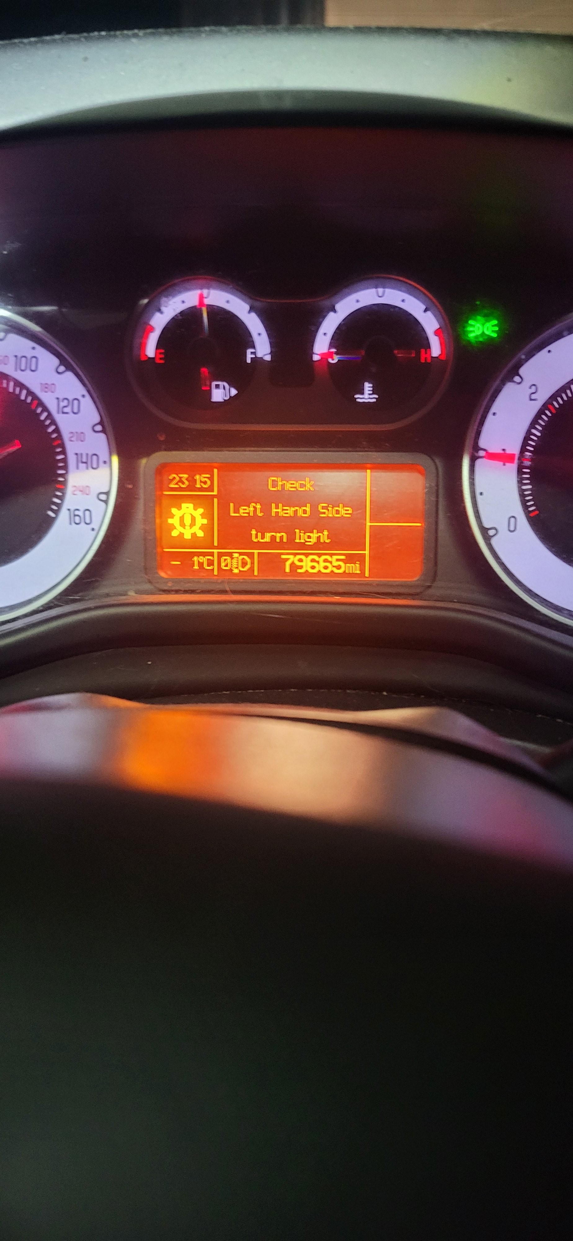

F Fiat5Scunnered New member Joined Nov 23, 2024 Messages 4 Points 2 Location Uk Nov 23, 2024 #1 Getting this message on my 2012 Fiat500L but all the lights are working including the orange ones on the side and the turning lights. The left indicator ticks quickly when put on but again all lights are working properly. Any ideas? Cheers Model 500L Year 2012 Mileage 79665
V varesecrazy Patron member Parked in the garage Written 10+ guides Written a review Joined Apr 27, 2011 Messages 37,039 Points 10,560 Location Near the M4 Nov 23, 2024 #2 Fiat5Scunnered said: View attachment 455740Getting this message on my 2012 Fiat500L but all the lights are working including the orange ones on the side and the turning lights. The left indicator ticks quickly when put on but again all lights are working properly. Any ideas? Cheers Click to expand... Have you changed any bulbs? The cars monitoring system gauges power used.. The fitting of LED, or other changes of wattage can have this effect
OP OP F Fiat5Scunnered New member Joined Nov 23, 2024 Messages 4 Points 2 Location Uk Nov 23, 2024 #3 Yeah I replaced them with two new bulbs today and it still does it
OP OP F Fiat5Scunnered New member Joined Nov 23, 2024 Messages 4 Points 2 Location Uk Nov 24, 2024 #4 Well went and bought another new rear indicator bulb and the message went away. Maybe got a bad one, thank goodness, mystery solved
