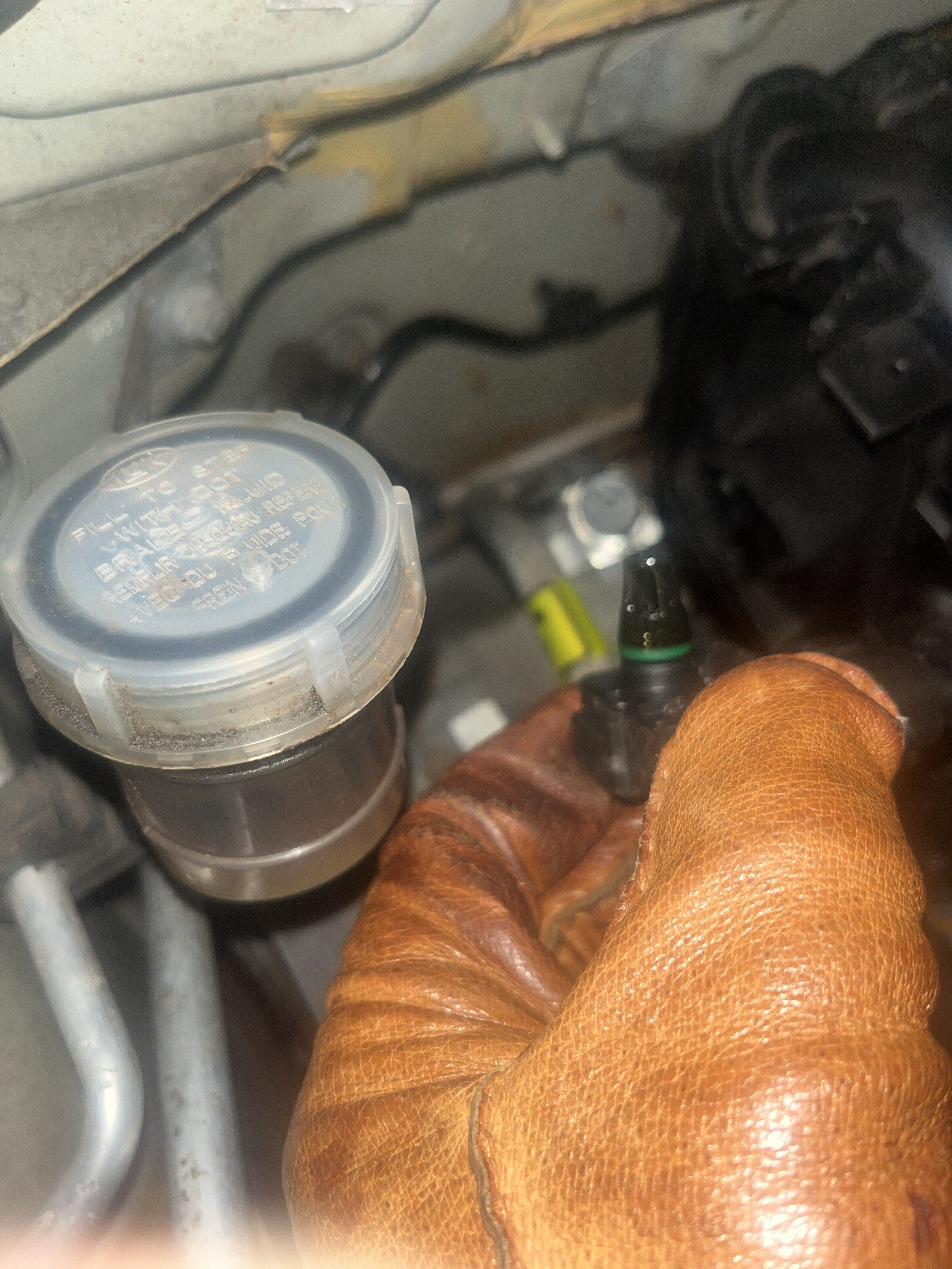

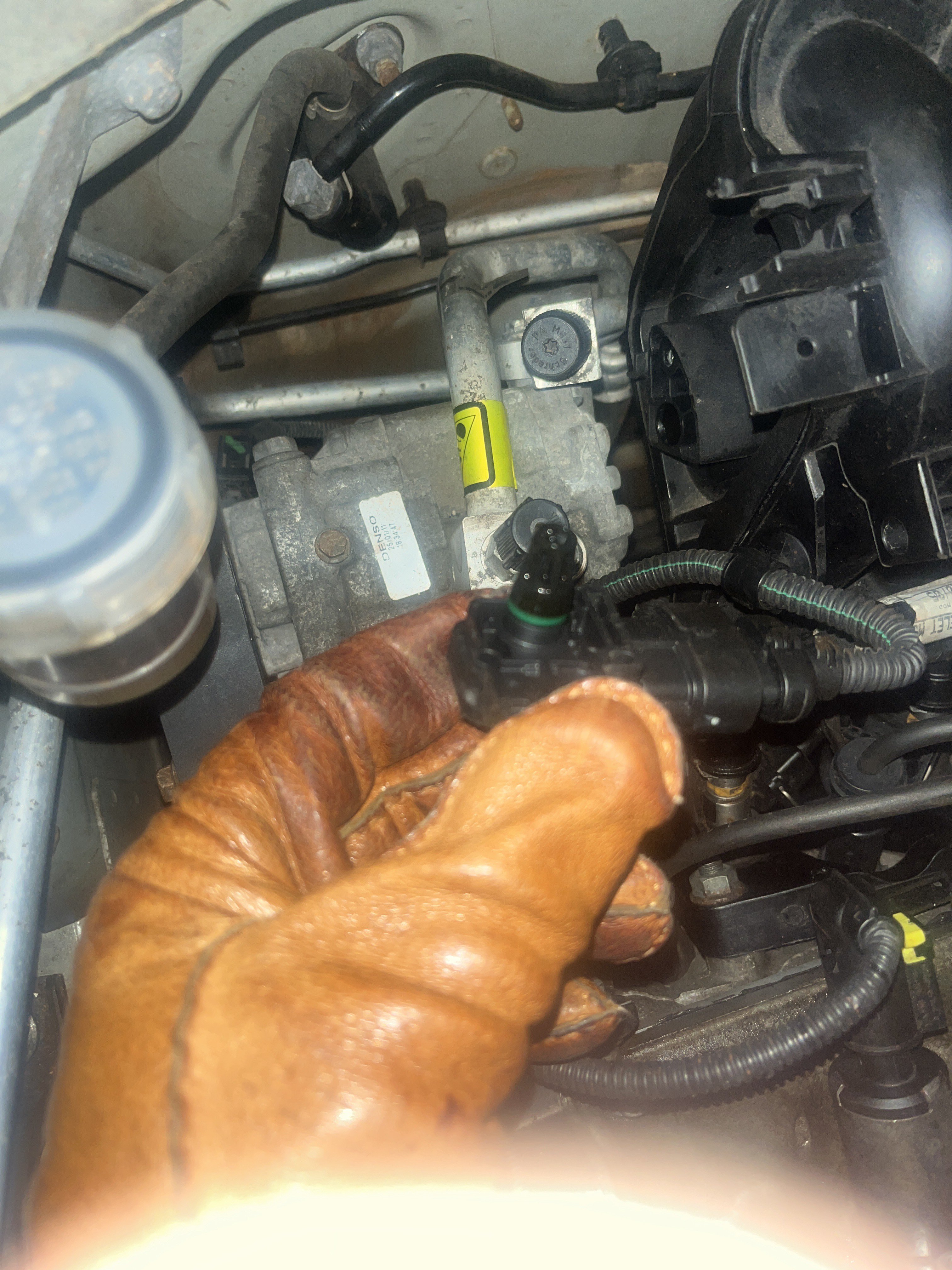

Take the MAP sensor out, one bolt no need to disconnect the electrical cable, look at the top
Is it dry
Is it covered in oil like this
Or is it covered in mayo

Looks like just oil

Hard to see in the photos
But a drop of oil on the centre of the MAP is enough to cause the fueling to be out
Poor performance, acceleration, idling
It was pretty wet with oil — just dark out and would focus (and camera has too many scratches lol)
How would oil get there?
How would I best clean it?
