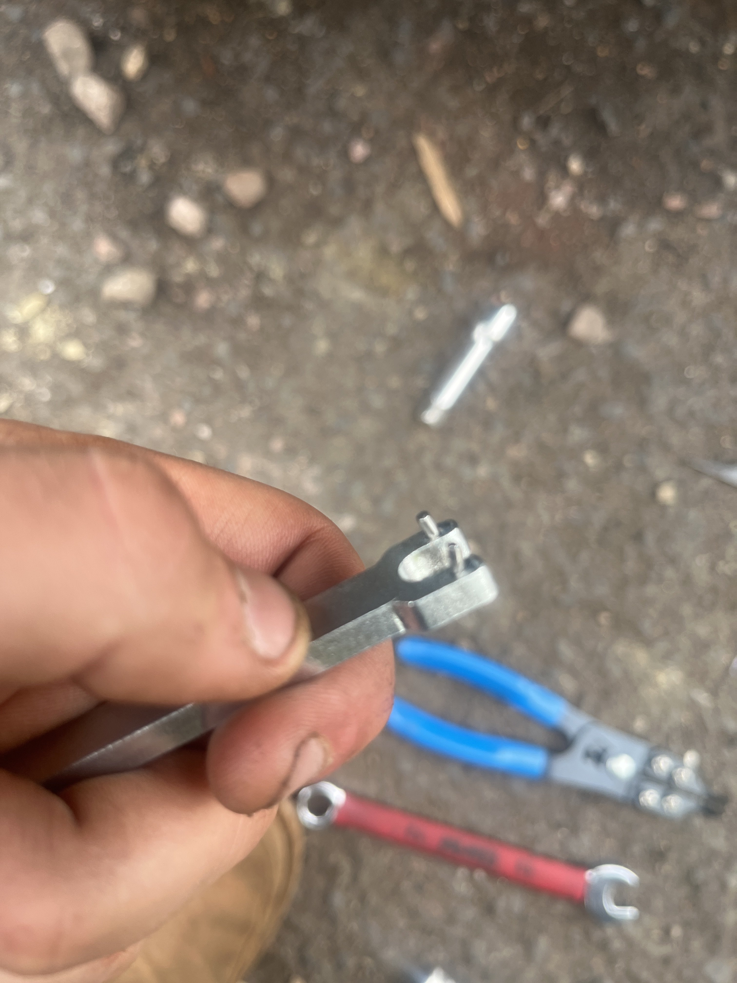

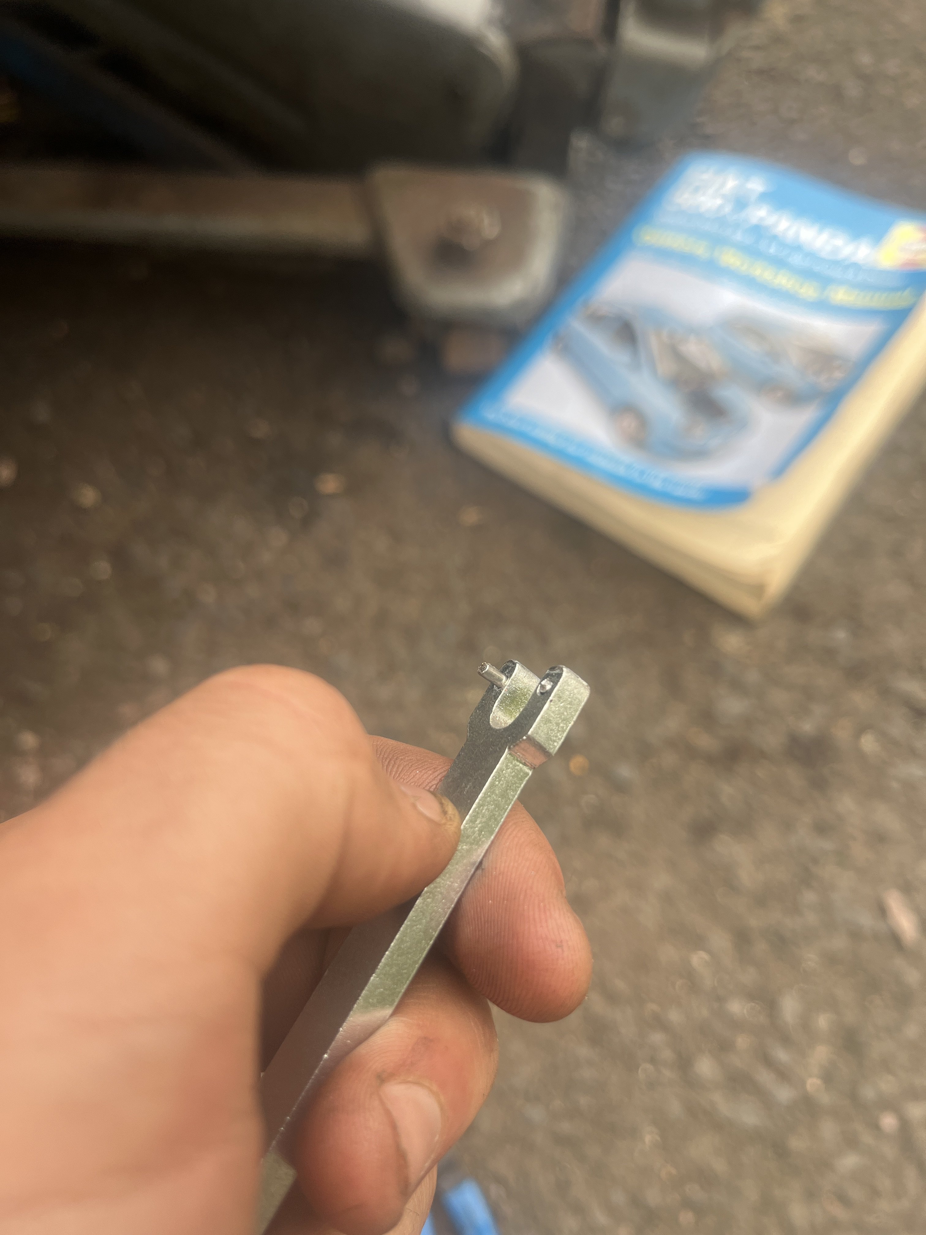

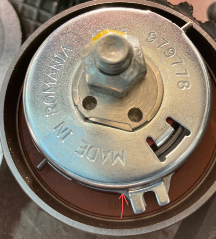

Really having a hard time with the tensioner and the flimsy toolView attachment 450480
Now really bad luck
Yep there rubbish metal, mine broke too

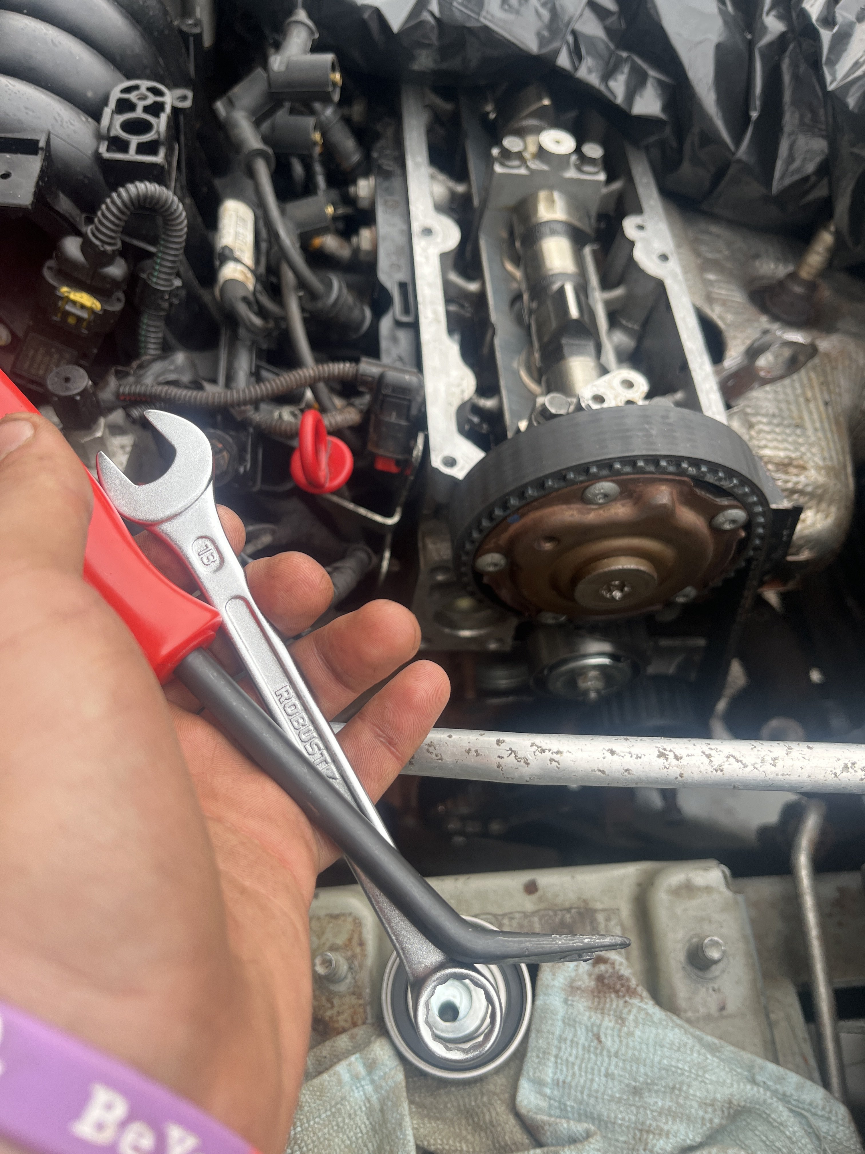

I made my own
Bit of old gearbox selector and two masonry nails, technically it's using part of itself to fix itself, which I find amusing

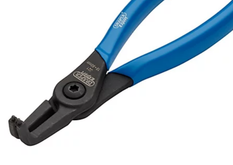

90 degrees circlip pliers also work
If you can find some
90 degrees circlip pliers are a good investment anyhow
Photo above post 262
B&Q and motor factors use to have them
Thank you — the hardware store next to me didn’t have any like what I need — will have to see if Amazon can get them here quick lol
Also just started it up after trying it the way suggested on this thread
Let it run for 15 minutes, no trouble codes yet!
Felt only slightly bumpy at times, but it’s still jacked up on one side and first start after tearing it apart a bit is never best
