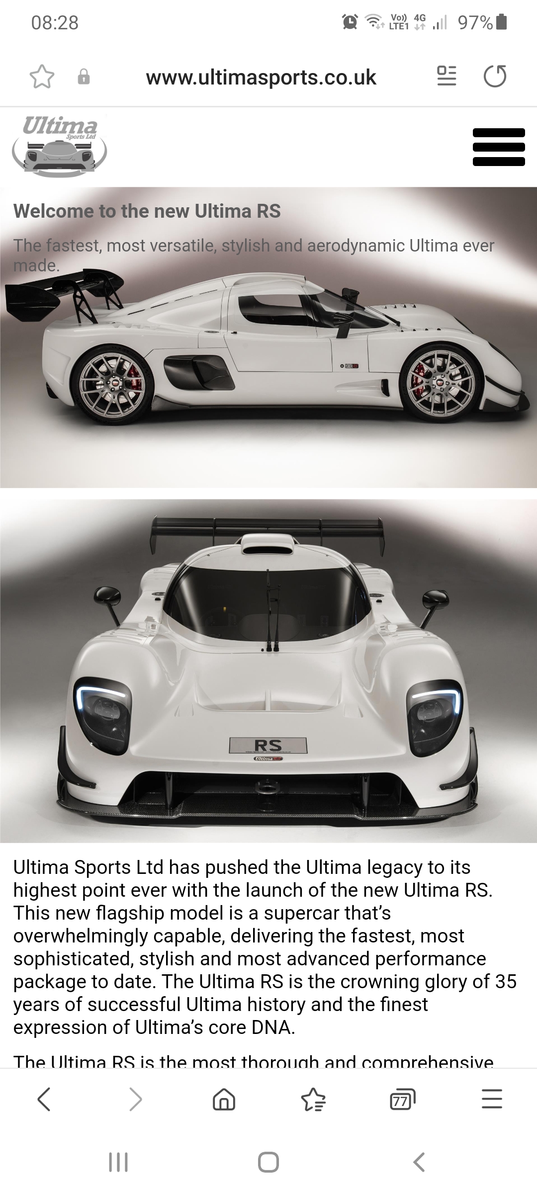

So putting a modern engine (Chevrolet)with all the emissions requirements in an aerodynamic body of minimal weight ie under 1000kg would be an interesting thought.
