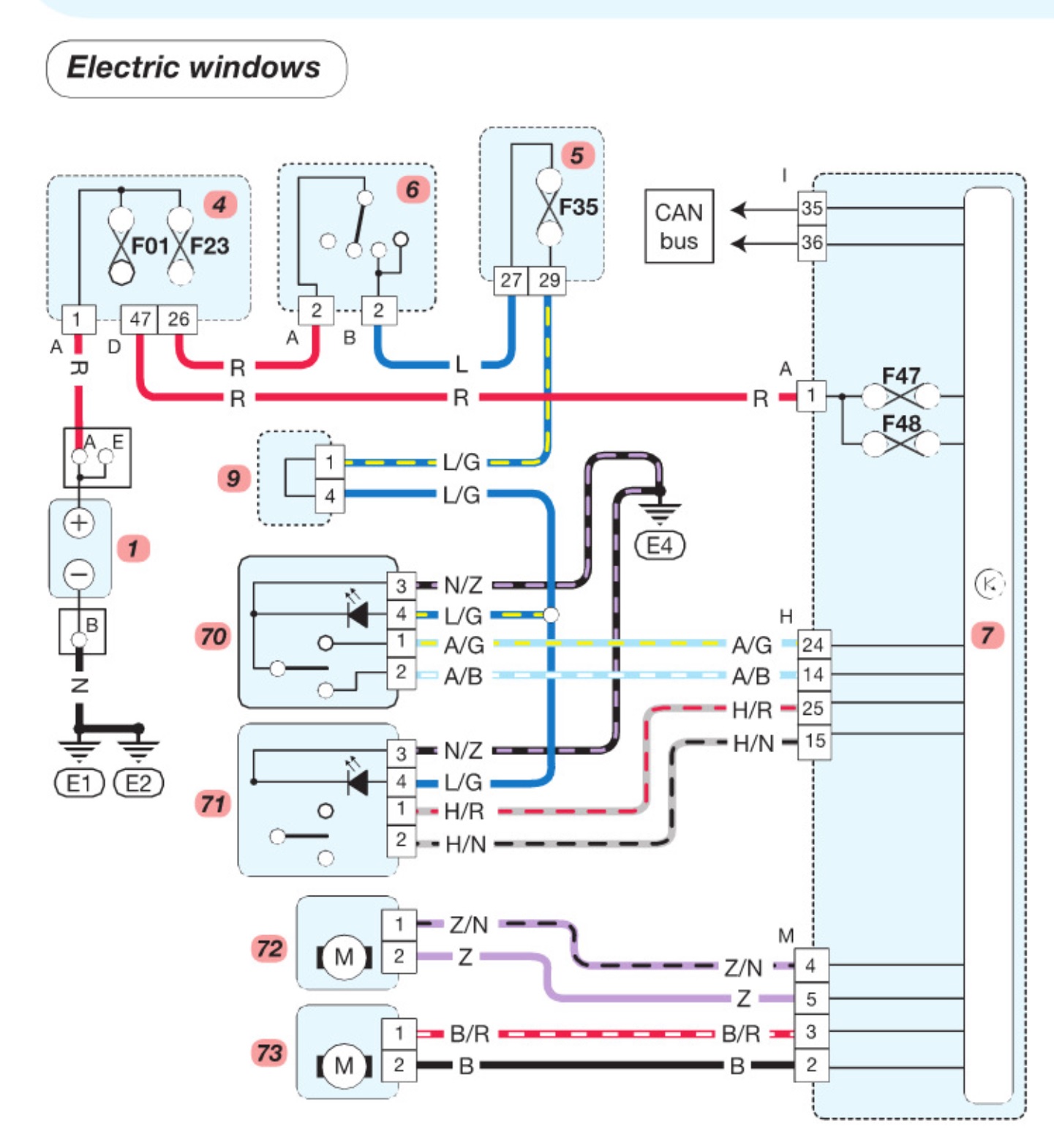

Following the Haynes circuit diagram, 72 is the motor in the drivers door with two wires (Z/N) Purple/Black to pin 1 of the motor and a (Z) Purple to pin 2 with the reverse connected via the door to M4 and M5 of the Body Computer Module (7). The sensory circuit within (7) monitors the load of the motor and stops it automatically at the end of travel. Unlike most cars, these are standard motors not stepper motors - as a result, there is not a serious of steps for the BCU to memorize, only the increased load. Therefore, to check the cables and the motor, disconnect the multiplug that is at the footwell driver side and using a 9v square battery connected only to the wires that go to the motor, see if the motor drives the window up / down while flexing the cables. It might be a good idea to replace the two wires (Z/N, Z)
The second issue that could be causeing problems are within the drivers side switch (70), so to test that, unplug it and check for continuity between pin 1 to 3 and pins 2 to 3 depending which way you press the button. If you have intermittent contacts in the switch, replace same as they are realitively cheap / available in car breakers etc.

View attachment 429085Following the Haynes circuit diagram, 72 is the motor in the drivers door with two wires (Z/N) Purple/Black to pin 1 of the motor and a (Z) Purple to pin 2 with the reverse connected via the door to M4 and M5 of the Body Computer Module (7). The sensory circuit within (7) monitors the load of the motor and stops it automatically at the end of travel. Unlike most cars, these are standard motors not stepper motors - as a result, there is not a serious of steps for the BCU to memorize, only the increased load.
The wiring diagram is incorrect, it was changed in 2008
