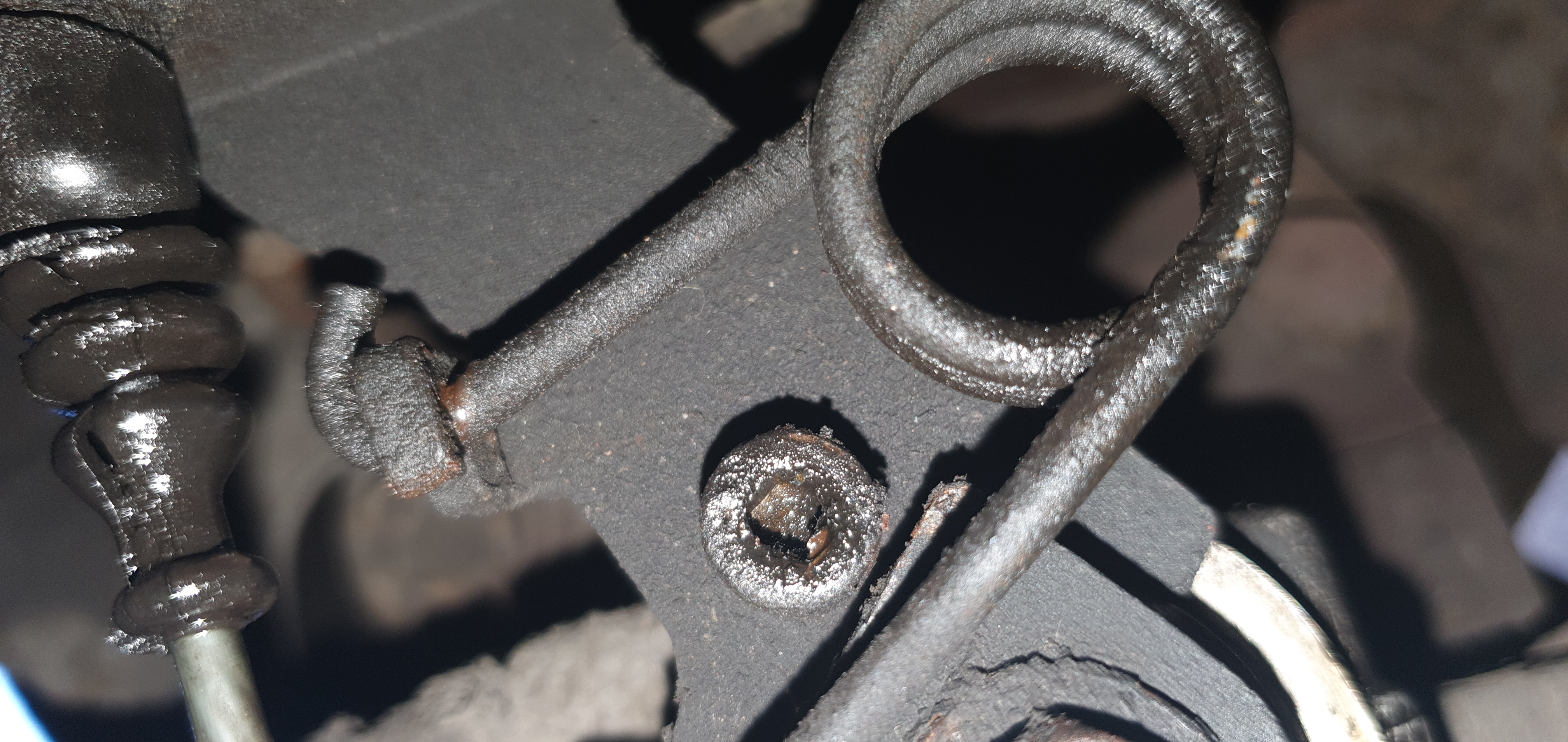

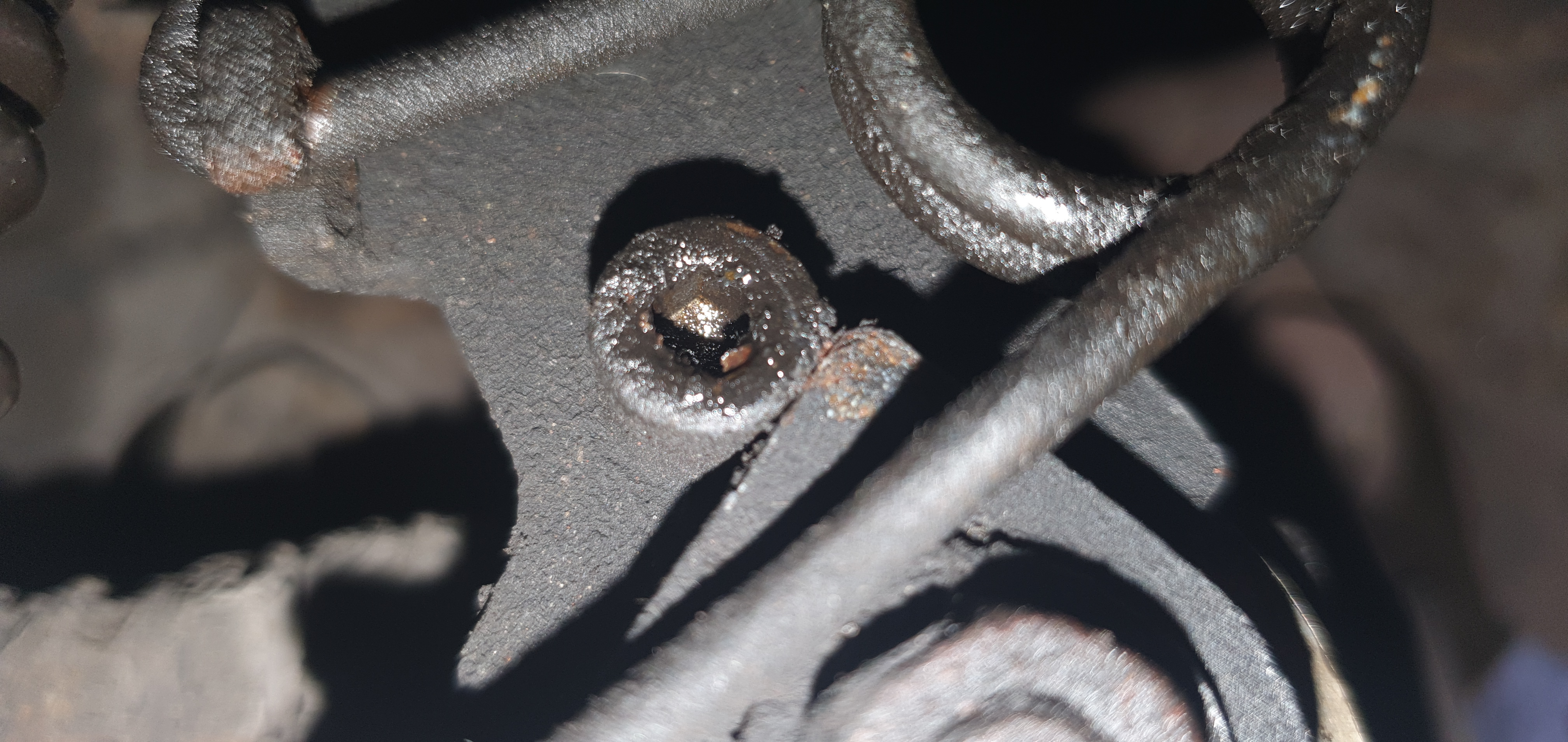

Right , I've slackened right off the adjustment and tightened it so that the lever in the car has very little free movement , and basically the handbrake still comes up about 6 clicks to hold the car on a slight hill , weird eh ...also the foot brake actually feels better but that might be just a pseudo effect lol I'll leave it until it needs rear pads again and get it properly sorted then , cheers
Hi Edgie. Comes up 6 clicks? Think about this for a minute. Back in the days when hand/rear brakes were not self adjusting it was common to adjust the rear brake linings with the manual adjuster until the shoes were just dragging on the drum and then adjust the handbrake until, typically, the lever would come up 3 clicks. Now though we have self adjusters which require the hand brake levers (at the wheels) - be it disc caliper or drum type - to be just a "smidgeon" off their resting stop. This is necessary for the self adjusting mechanisms (and there's more than one type) to return to the position where they can engage with the next "segment" of the self adjuster's ratchet mechanism (for simplicity think of it as a ratchet, like on a ratchet in your tool kit. Although there are other types.) If the cable is tightened too much the lever will not return far enough to "catch" the next tooth on the ratchet so the self adjuster stops self adjusting. Because of this you invariably find that hand brakes these days often pull up further than was previously thought to be acceptable. Factor a wee bit of wear into the cables, clevis pins, and other bits and pieces and your 6 clicks may not be too outrageous at all!
If you've got the cable/s adjusted so the levers at the wheels are just off their rests and the cables look to be in good order with no obvious wear in other parts and the hand brake is holding well on an incline, then that's probably as good as it's going to get. Don't be too obsessed with trying to achieve a very short "pull up" on the lever.
Hi , thanks for your reply , basically I've now got it so the little bit of lift in the h/b lever has gone and the amount of clicks is the same as it was when I had tightened the cable up so the auto adjust must be working , it's pulling equally off the stops on both sides and it's resting against the stops on both sides too so both sides are moving , I've attached 2 pics , one off the stop one on , both sides are the same , they're wet due to wd40 lol
