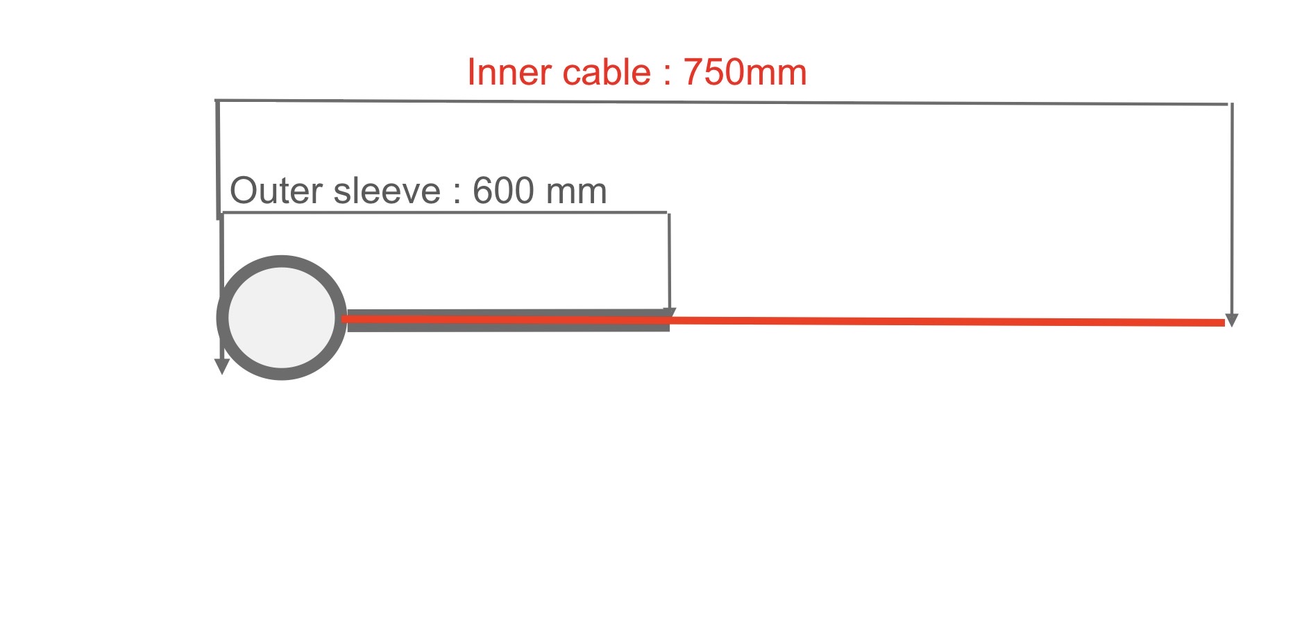

I need to replace my hand throttle but it seems longer than the stock carried by both Autobella or Ricambio.
Dimensions are outer sleeve c. 600mm.
Inner cable c. 750mm.
Ideas anybody as it seems there was only ever one size for this cable ?

After some research ( private response from someone who knows) , I have in fact answered my own question!
For anybody who is interested, despite what others have said , THERE ARE 2 DIFFERENT CABLE LENGTHS with two different original part numbers from Fiat.
The 110N/D models do have different hand throttle cables to the 110F/L/R.. The heater splitter channels are also different.
The 110F series are Fiat I/C 4126364 and without clip Fiat I/C 811731. 110N/D Fiat I/C 992788. without clip Fiat I/C 811731 “P” clips retain the cable to the floor.
All I know is the F/L/R is shorter and is the one that is readily available unlike the N/D
Dimensions of the earlier N/D as per the attached.
