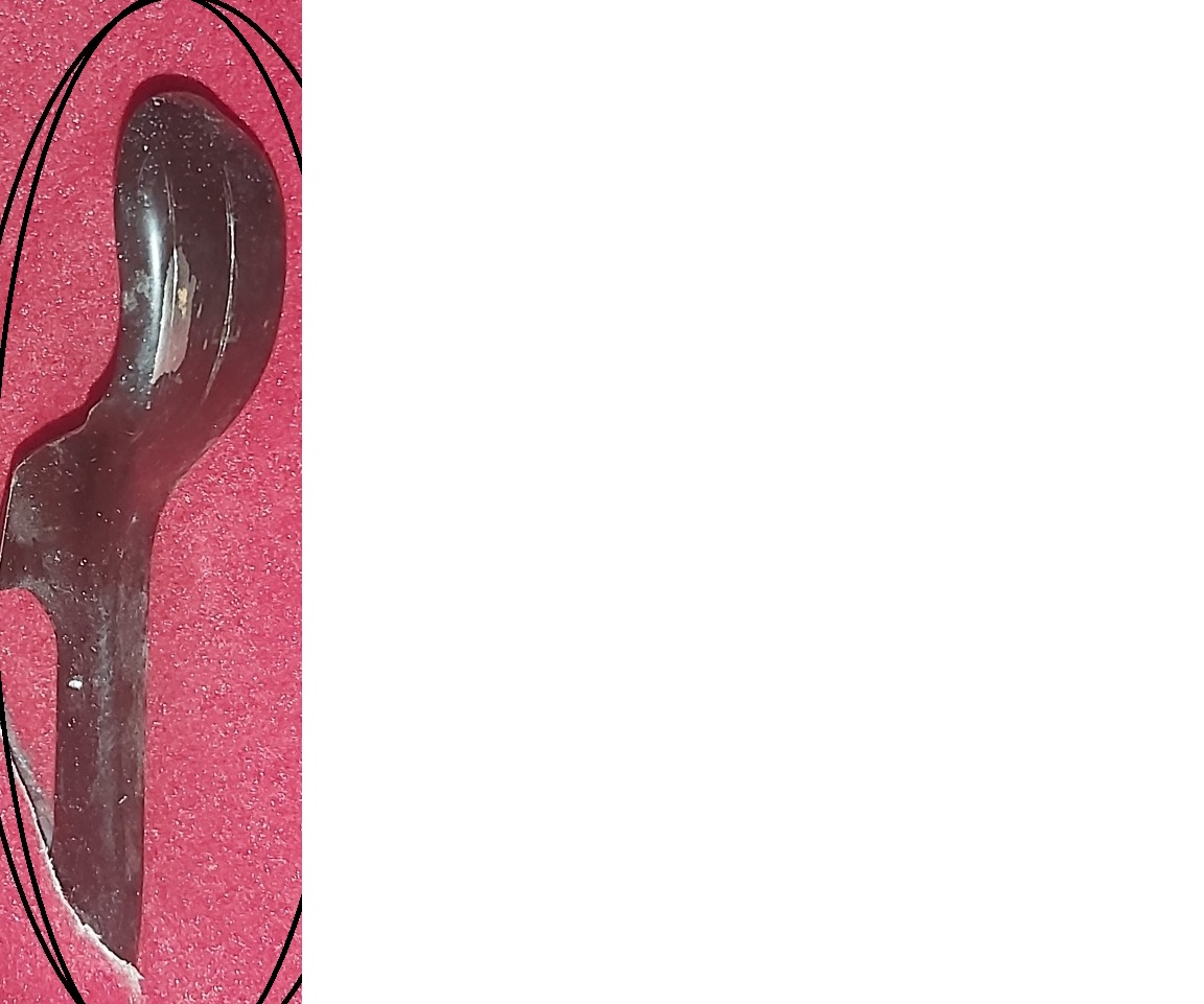

Hello all
can anyone please verify if the pedal (pic attached) is as per the original, which had the hand throttle cable attached, or if it has been butchered, missing part or just wrong.

The 'hand-throttle' is linked to the the throttle assembly under the carpet, at the same point that the cable to the carb is connected. If that hasn'tbeen butchered, then it might be able to re-establis the 'hand-throttle'. Check that point first.

Will do thanks. The hand throttle at the pedal end seems to be a loop of wire; is that correct?

Yes, the hand-throttle cable has a loop in it at the trottle pedal cross-shaft end---held on to the pin by a penny-washer and a slit-pin. The cable then goes up under the dash to a small bracket. The outer of the bit you pull is held onto this bracket by a special clip. Please note--this only to be used as method of holding up the revs for a quicker warm-up---NEVER as a 'cruise-control'
