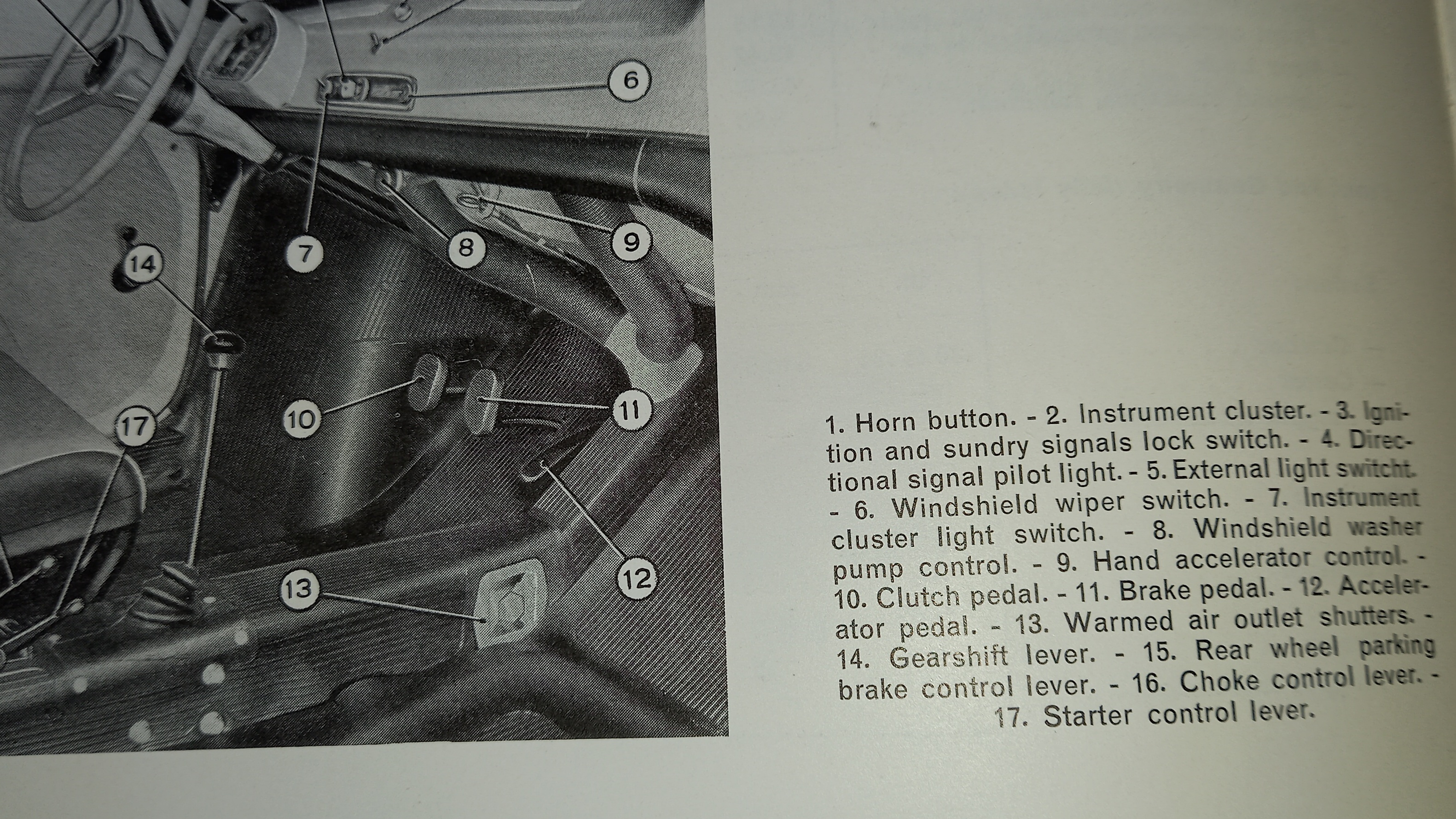

Does anyone know
1) why you need this when you have a choke lever?
2) where it connects to, mine has no cable attached.
Item 9 on attached drg.
Assume the 500 has one also, cant quite remember on my last one.
Does anyone know
Ther should be a short cable running down from the handle of the 'hand-throttle' to the back of the accelerator pedal. I have always assumed that is there so that the throttle can be held open slightly for a fast warm-up---the choke has to be progressively 'shut-down'. It is NOT a cruise-control as somebody (on this forum) once thought that it was.
As Tom says, it's useful for cold starts. It's generally advised to put in the choke as soon as possible (the theory being that over-richening can wash oil from the bores), so I tend to use it to run a fast idle after starting whilst doing my 'pre-flight' checks (lights etc.).
