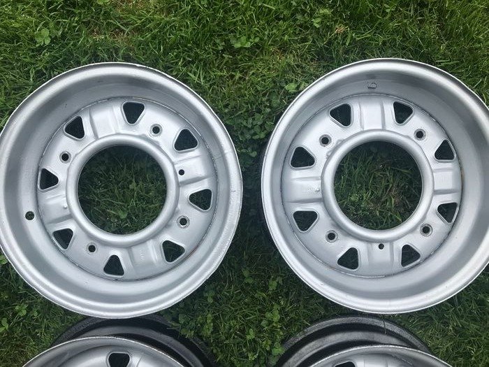

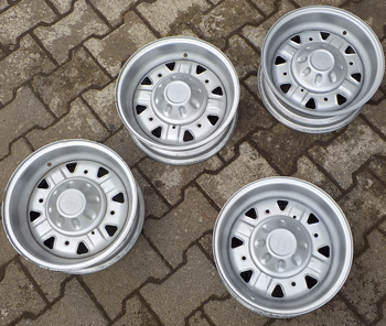

yours are 1970-80s wheels...
early wheels are 1 peice (lots of repros now)
you can get a round or fluted hub cap set often with a scorpion logo....
I wowed the Inner circle of the Fiat 5oo Club of Turin with my 4"x12 set of 5 CMR wheels
they didn't know of another set as CMR are as I said normally wide and used for racing hence why they are often referred to as Abarth wheels..
If peopel look carefully they turn up... I brought a set of late 60s CMR wheels for £100
and for those of a certain age.. I have a set of COSMIC wheels 98PCD but would need flared arches...
you can't beat original period wheels
Any chance you might have one spare floating around of the 1 pc 4.00x12 CMR's? ;)
or know of a source?
The new 1 pcs i could find online have a different center cap fluting. and unfortunately im in need of one eventually.
