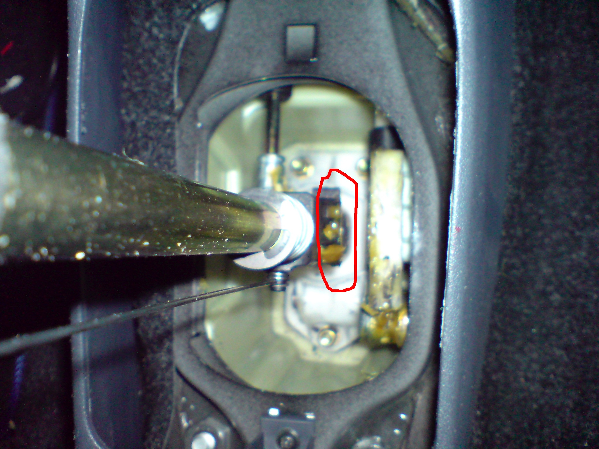

I can now select all the gears lol. Had to cut the inhibitor for reverse down a bit to get 5 and 6. You still have to pull to get reverse so its all nice and like you'd expect :)
