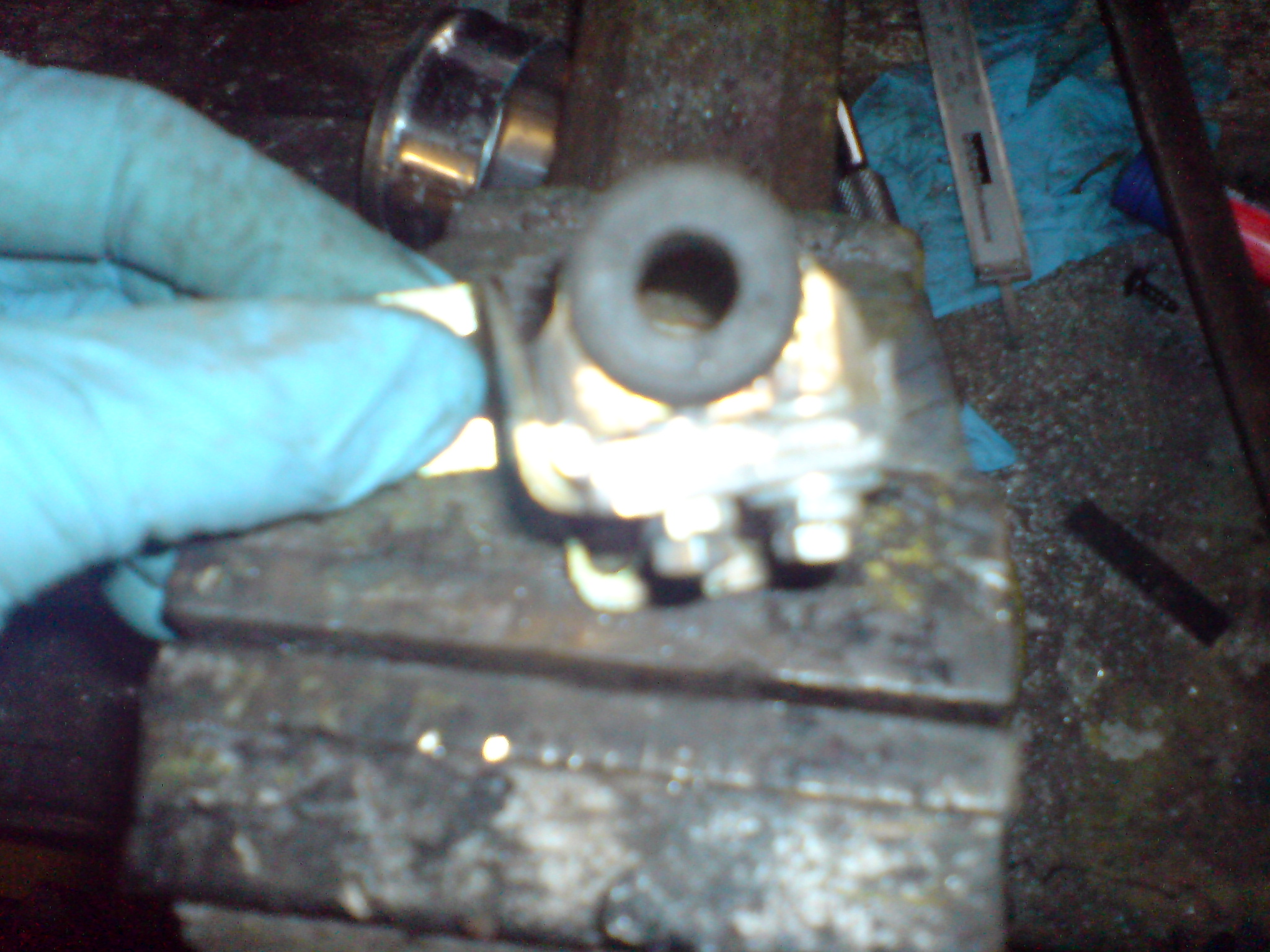

@ J333EVO - Thank you very muchley for the pictures. What has been done with the bracket, is exactly what i thought about doing as well (y) There have been no issues of the cable and rubber bung falling out of the bracket, because its open ended? I presume not else you'd have changed it (y)
Kristian
There is no chance of the rubber bung falling out, it is held in really tight, you have to prise it out, and getting it in is challenging. :)

I was going to go the same route as emma's sei for the throttle body, but sadly my vac line for the brake servo got int the way (differnet position), so i removed the 1.4 charcoal cannister, cut it off, butchered the sei mpi throttle cable bracket, drilled and bolted it on.
It sits not entirely true with the mechanism, but doesn't slip out of the runner , so should be the job :D

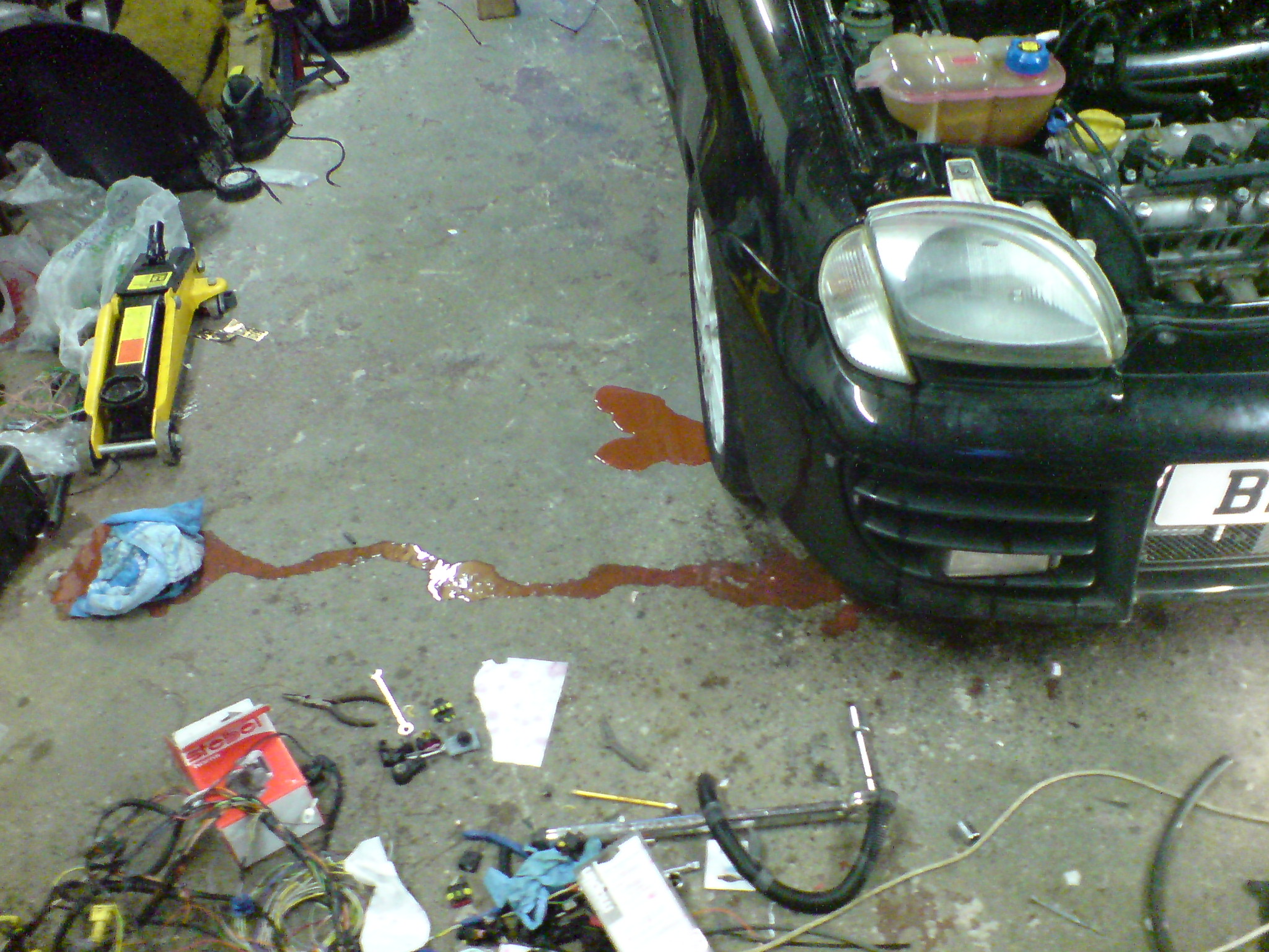

then my coolant hose blew off at 91 degrees, and blasted red hot coolant all over the engine and garage.
I think the hose is my fault as it was a bodge job. The proper fiat hose its two diameters at either end, so i just wrapped tape round the barb to make it bigger, and then clamped it on.
Thats what i'm hoping at least. Noisy top and bottom ends and hoses blowing off doesn't sound the best combination! Maybe a compression test in the morning :(

Here's the disaster earlier. The return hose blew off at full temp and dumped all of the expansion tank coolant over the floor. I looked round the shops for a step down hose adapter adn a smaller hoes but no joy. For now it is now ptfe'd and two clamps holding it on now. It seems to be doing the job ... phew!
After topping up and trying again it didn't blow and i got it warmped up and idling, albeit not perfect, but better than earlier.

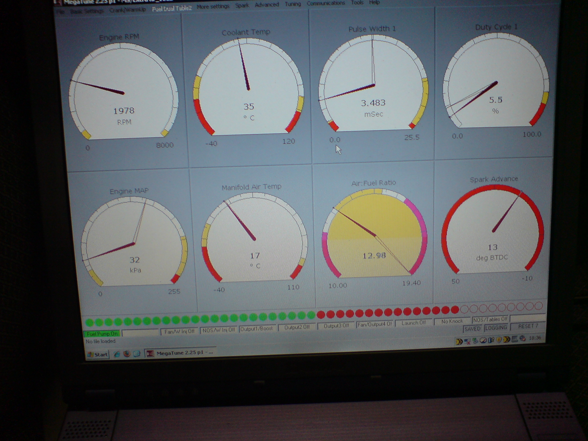

Here are a few video's I youtube'd as I can embed them in here, something i can't seem to grasp with the forum software.
The engine seems to be hunting a fair bit with ego correction, but disabled it's ok.
