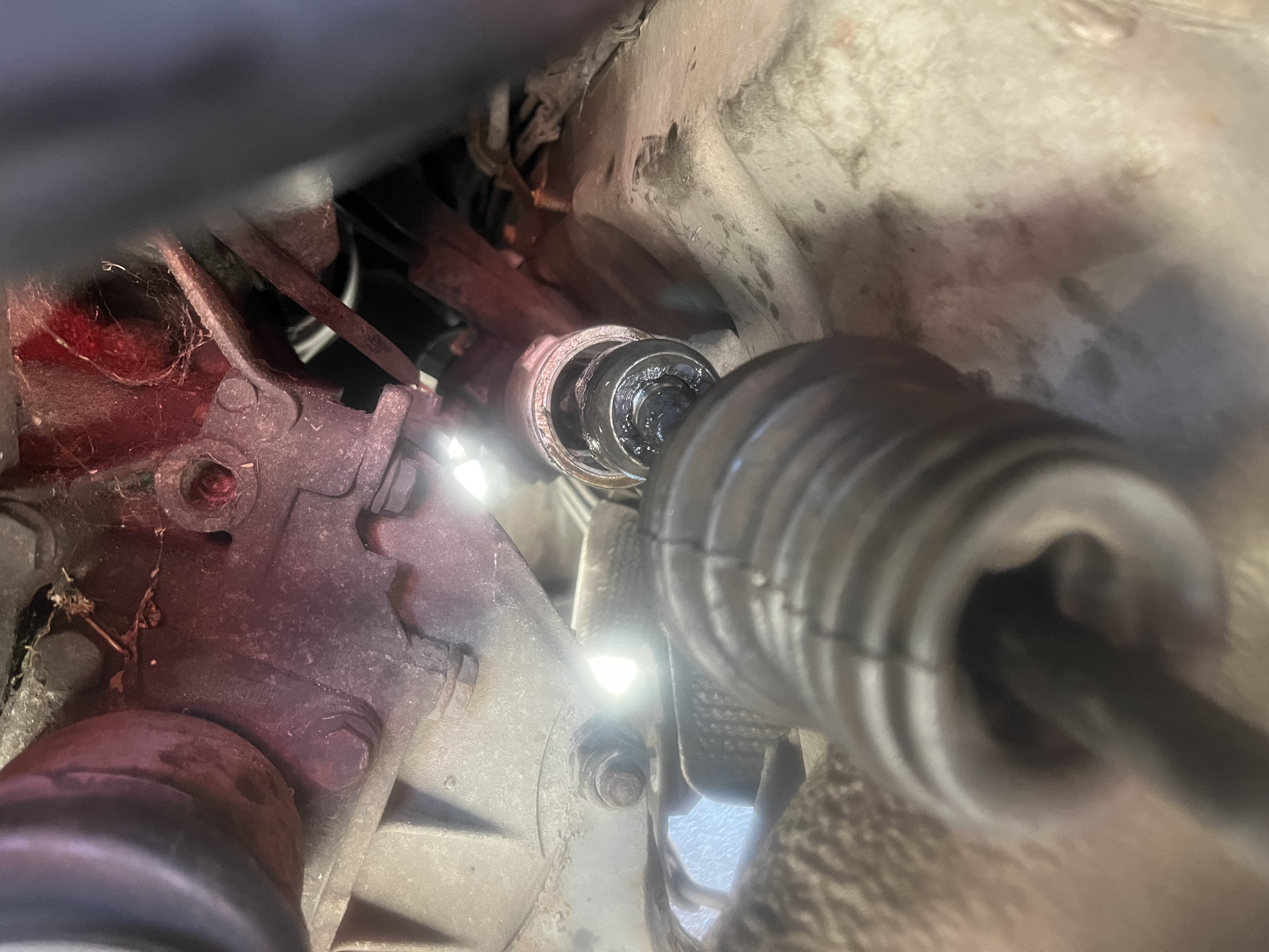

As far as the job was concerned, the track rod to hub knuckle nuts came off without a fight, but the inner tie rods were a major pain in the proverbial because of space. Yes, I could have taken the rack off, but time is the issue with the kids and the wife working and being the ‘reliable’ car.
The driver side on a 2000 1108 sporting has a little more room, I managed to break it free initially with a rather large adjustable spanner (32mm) [I think the actual size on the flats is 1 3/16] then work it off with a pair of locking mole-grip as it was being replaced, but the passenger side (uk left)… the space is next to nothing thanks to the gearbox. Time was very limited so I resorted to buying one of those obscene ‘universal tie rod tools’ that Amazon sells. It actually did the job and gave me the leverage that i needed to initially break it free, with three extension bars, but the tool is a headache itself. Next time, I won’t think my tool collection is so complete. The proper tie-rod tube tool on this car next time, if ever!
Also, if you’re going to tackle this job with the rack in-situ, another thing to consider is fitting the new boot that ‘slides’ over the rack. It did not want to go on and how I finally did it was by sliding a smallish, blunt screwdriver under the boot and working round it to send it home, while laying under the car giving it my might with brute force (I’m a lanky sod so my smallish hands did help).
