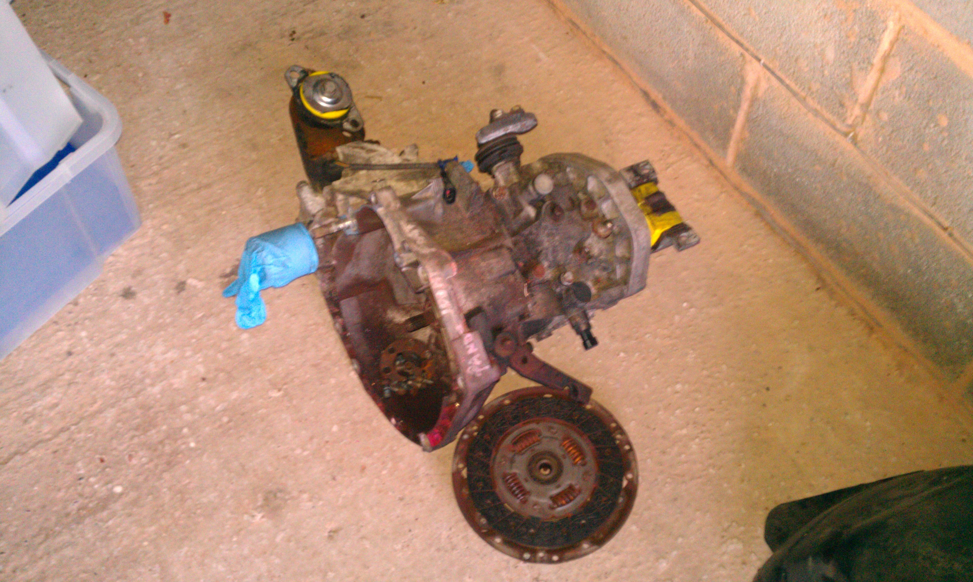

Well, new starter on order from ebay, should be hear tomorrow, so in anticipation, i pulled off the box.

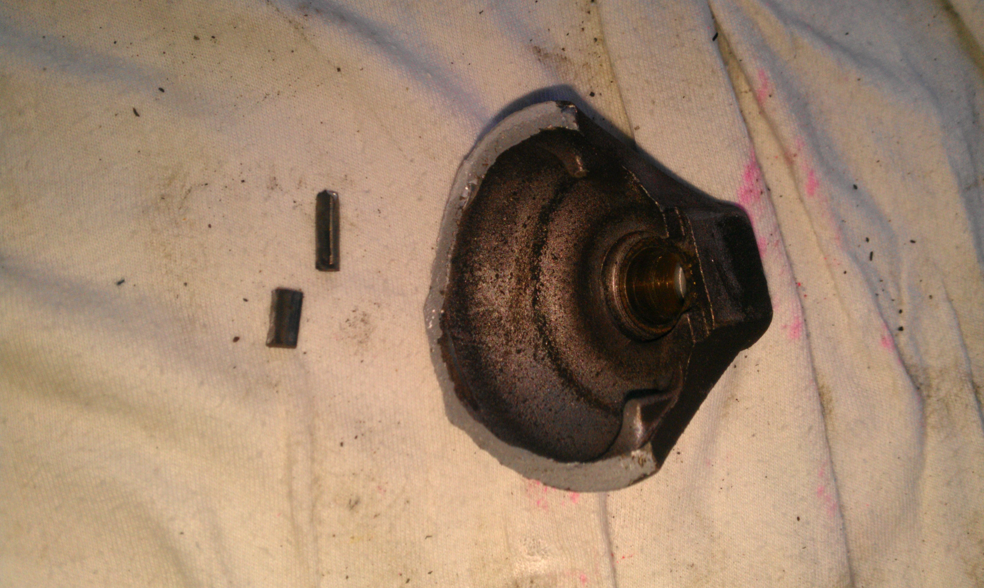

Removed this from the bell housing:

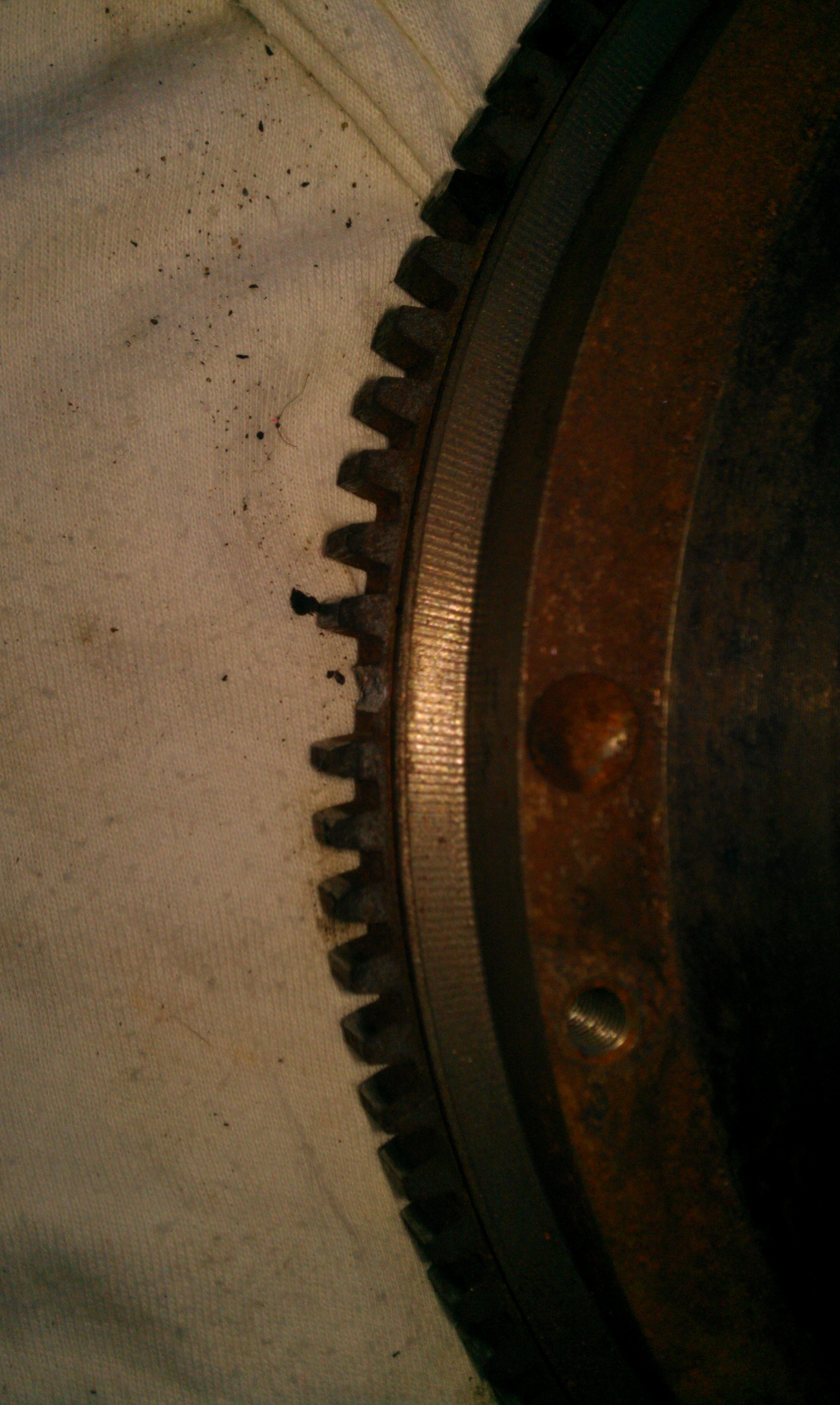

Not the best thing to be floating about in there....however, I noticed there were two teeth, and only one snapped off the starter...Checked the flywheel:
Doh! :bang:
Fitted the new mounts anyway, just to be slightly productive:
Now I have to source a new flywheel from somewhere.
The ring gear option sounds the better depending on how much i can get a cheap cento flywheel for.....if it's not much cheaper to get a 200mm then i'll just get another. This one has a little bit of weight off the outer edge, but not too fused about an unlighted one.
Was driving the coil pack wrongly after a bit of diagnosis, and so timing was way out and kicking back the engine casing the death. Hopefuly, once back together I can sort that out.
