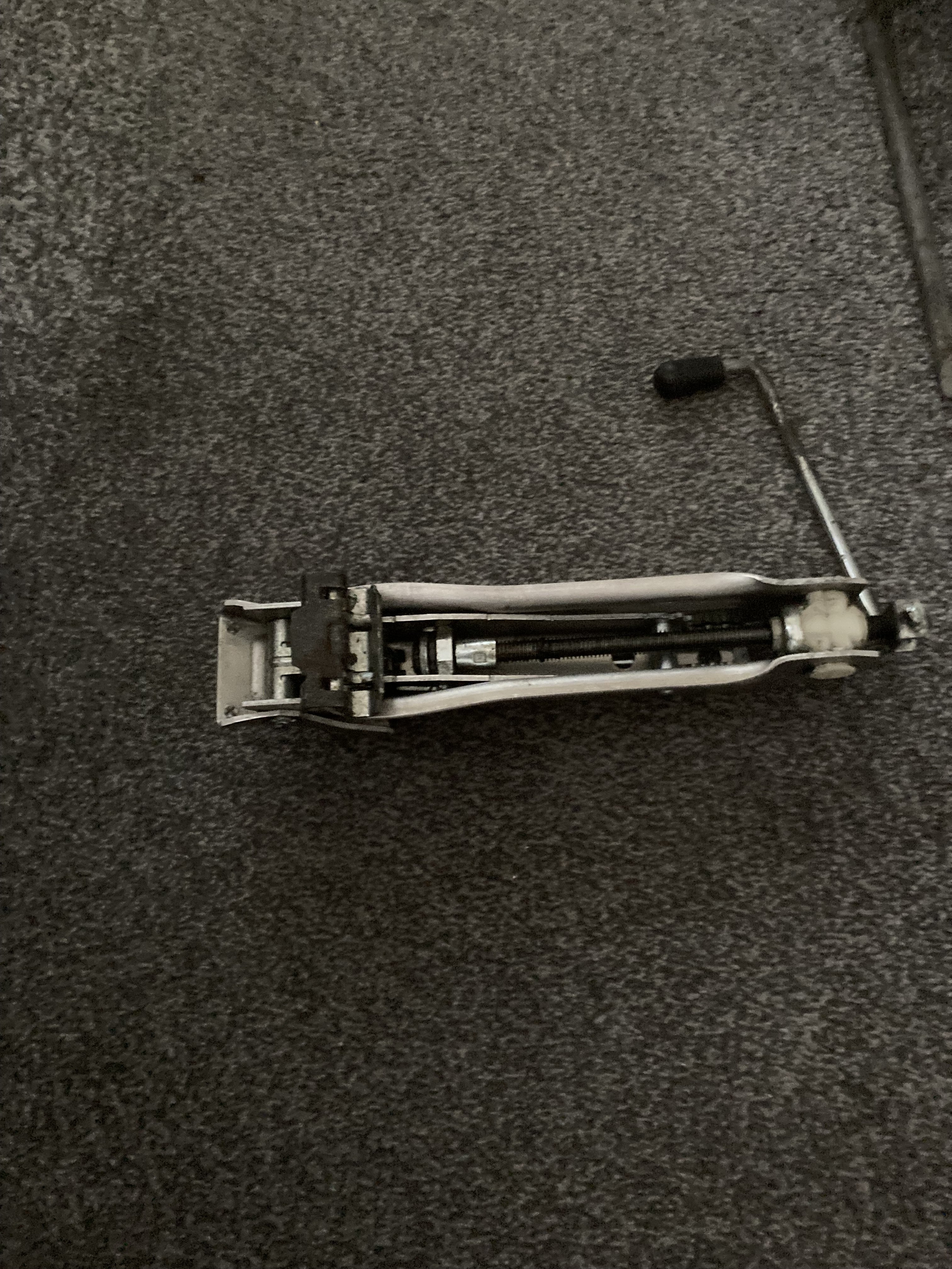

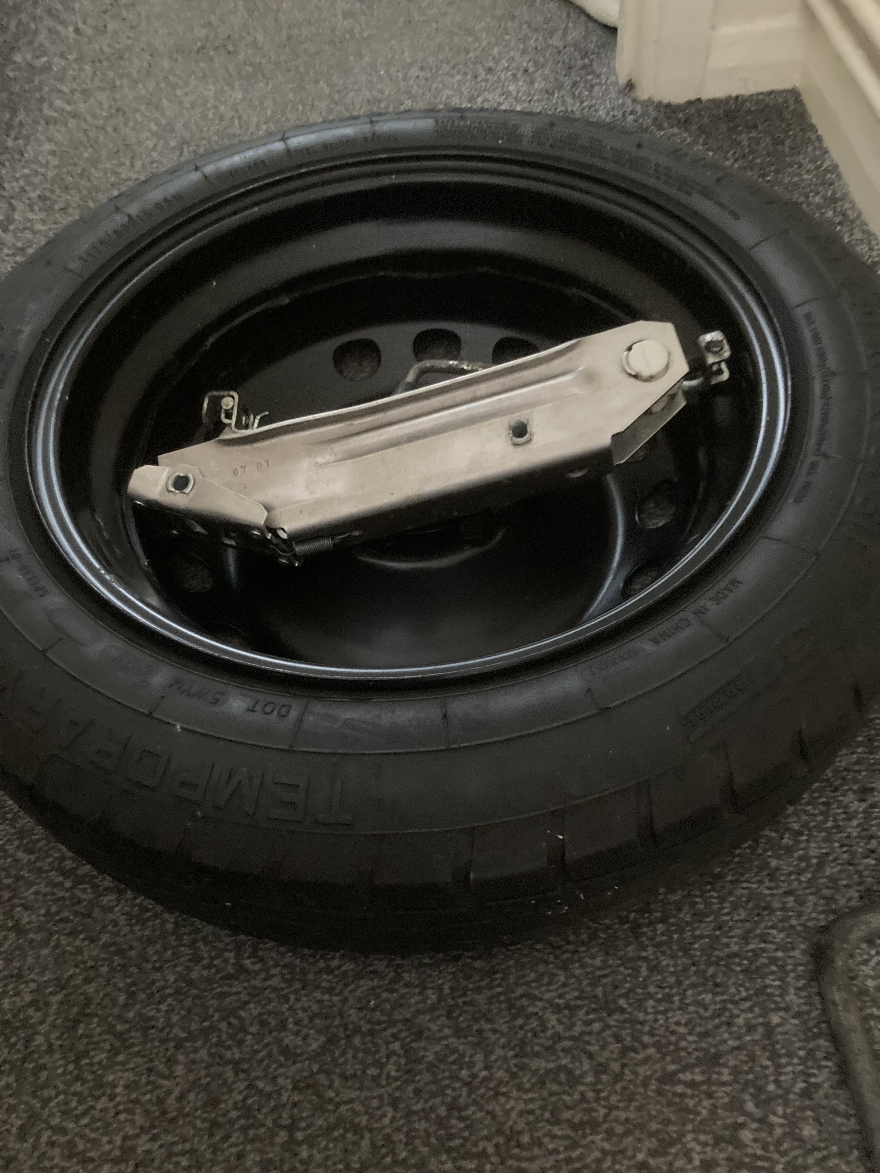

I’ve just got a 15” space saver wheel for my Trekking and if came with (what Google image search) tells me is Golf MK4 jack.
Has anyone ever tried one on either a Trekking or 4x4 ?
The weight and height capacities appear to ok for our cars and it’s compact enough to fit in the spare wheel

I’ve tried it on the car and it lifted it high enough to be able to remove a wheel, it did it with much less effort than the Halfords scissor jack I bought before I realised the spare I brought came with a jack.

I won't use any jack that fits on the sill. Too easy to cause damage.

Dont use that Golf jack its unsuitable.

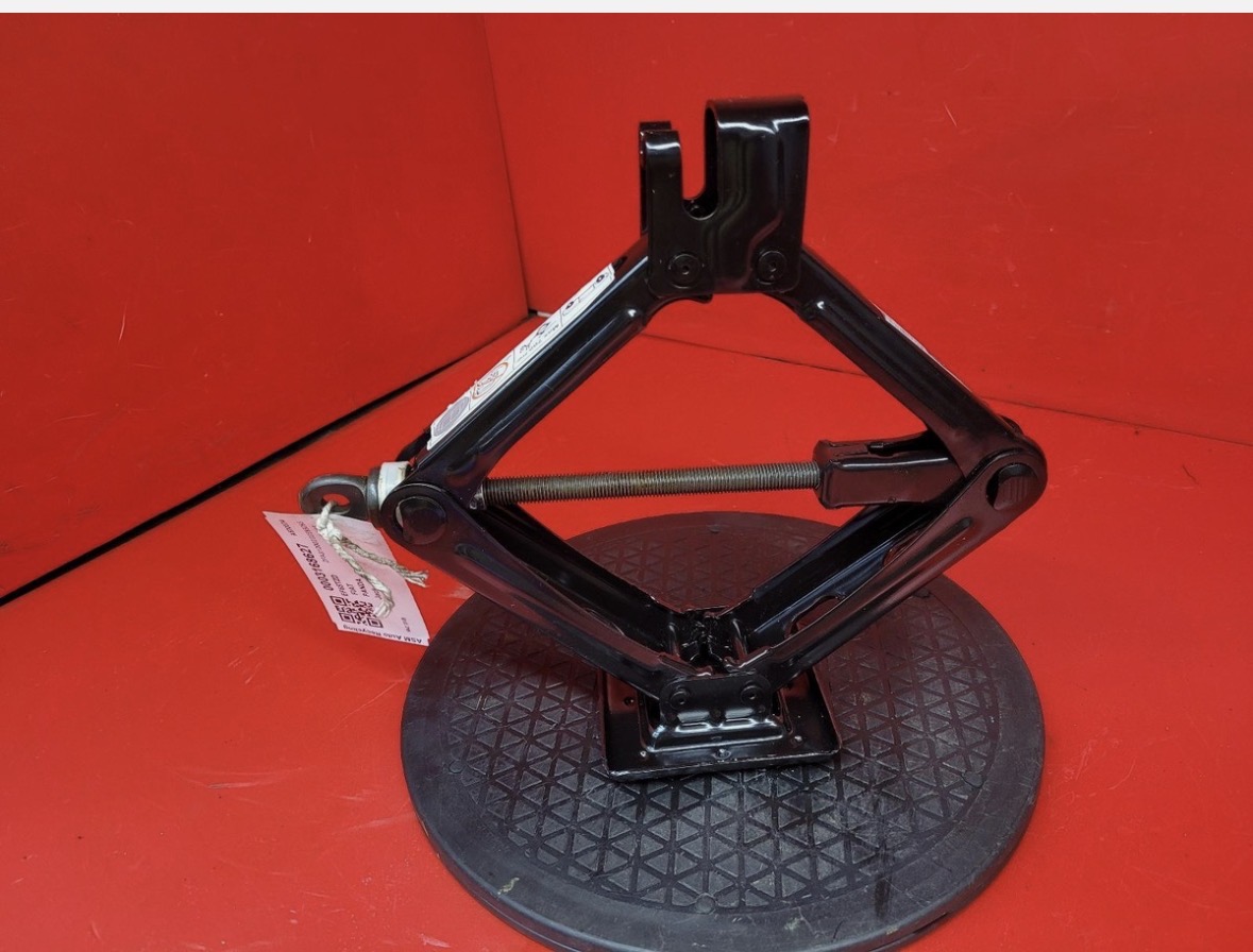

Thanks for the offer, after reading up on the Golf jack (apparently it’s not deemed a good design) I’m going to keep my Halfords scissor jack in the car somewhere .
@TonyM67 I bought a ‘generic’ jack for one of my Pandas… but then realised the genuine Fiat one is slightly different. The Halfords and others have a slot the sill weld locates in, and an area to either side of that that’s the same size and height.
But, the genuine Fiat one has a deeper slot (so the sill weld seam doesn’t touch the bottom of the slot in the jack), and, crucially the flat areas to either side of the slot are slightly different heights. This means the large flat areas of the sill sit on the flat parts of the jack, spreading the weight better. Also, the slot is offset to actually take more weight on the wider, inner edge of the sill. This prevents any crushing of the weld seam. (eBay photo…)

The Jack in that listing was for a non 4x4 Panda. The 4x4 uses a bigger/taller jack because the body already sits 50mm higher. There is a specific 4x4 jack but which is also used by the Doblo/Qubo model. It won’t ifit in the spare wheel and so lives in a supplied bag that goes under the front seat. (See my other thread for more info -
That.
I wouldn't jack a Panda or 500 anywhere on the sills, with anything, not even an OEM Fiat jack. Even if it does no visible harm, you could crack the sealant behind a seam, leading to corrosion issues down the line. And if the sills are already weakened by hidden corrosion (perhaps because someone has jacked it there in the past), it could even collapse dangerously.
For roadside tyre changing in an emergency, just keep a compact scissor jack in the car somewhere and use it under one of the chassis hardpoints. For anything else, use a trolley jack in the same places.
Read this thread for more information.
Looks the same as the Jack (albeit mine is black) that I have in the boot of my mk6 golf cabriolet which is quite a bit heavier than a normal golf.
What I’d say is it’s probably fine to lift the car to change a tire wheel but I would never use it for anything more than that.
It’s probably stronger or as strong as the Jack in any fiat, but it only lifts from one side and can be a little unstable
The VW jack may not avoid damage to the sill seam weld flange. Look back up to the photo of the Fiat jack (here: https://www.fiatforum.com/threads/golf-jack.523255/post-4869618) - it takes the weight on the sill 'beams' instead, which prevents damage to the weld seam. But for the 4x4 it's important to use the bigger (taller) jack for that model as the jack from a regular Panda can't lift it high enough.
This is the lifting point on the golf Jack taken from the picture above it is basically the same profile, might even be less likely to damage the sill as the width of the Jack is wider than the scissor Jack you linked to, the golf Jack will lift quite high but no idea how that compares to the oe fiat Jack
As I said before the golf Jack is not very stable because of the design so if there is the option of getting a better Jack I would but for the rare occasion you might need a Jack to change the spare on, then it would likely do the job
If the 4x4 Jack is higher then it doesn’t really matter if the golf Jack goes high enough to lift the wheel off the ground, I wouldn’t use either the golf or fiat Jack to lift a 4x4 in an off road situation
