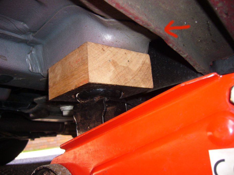

A 500 in the company of a trolley jack is about as safe as a chicken in the company of a wolf. A lot of cars have been damaged out there and I've heard an anecdotal rumour that AA patrolmen have been instructed to use only the jack supplied by FIAT when wheel changing at the roadside.
FIAT's official technical documentation is hopeless - it just says to use a 4 post lift on the workshop jacking points & absolutely forbids jacking on either the front wishbones or the rear axle.
If you use a trolley jack ANYWHERE on the outer sills, even at the arrowed jacking points, then you'll most likely damage the car. I know from experience that some main dealers raise the car on the inner sills at these points, but this too can cause some (admittedly superficial & non-visible) damage, & it just feels wrong to me to lift a car this way.
So I've had to work this one out for myself. What follows is entirely my own work, it's not endorsed by anyone; so use it at your own risk. It's served me well, though, & I've not had any problems since getting the car.
There are fairly obvious reinforced sections of bodywork at both front and rear (photos attached) on which the car can be safely raised on a trolley jack PROVIDED you use a suitable pad with it. Professional quality trolley jacks often come with a hard rubber pad, which should work fine. If you buy a cheap DIY jack, though, you'll need to improvise something & so I got the router out to fabricate something out of a bit of hardwood I had lying around (more photos).
Be aware that the car could slip off the pad if it's not on a reasonably level surface, so chock the wheels & always use axle stands if any part of you is planning on going underneath the vehicle.
BTW all these comments apply equally to the Panda.

Those pictures look pretty sound. I've fabricated an oak block that mimics the profile of the FIAT jack that I can use my trolley jack on, to jack in the arrowed places. Haven't tried it yet though. If it works, I'll make another and take them both with me when I need new tyres, and supervise the operation. There again, I could just put the wheels in the wife's car and take them to the tyre place!
Actually that was my first thought when I got the car and also the first thing I tried. One problem I found was that it wouldn't sit flat - the inner & outer sills aren't at exactly the same height & my first block started tipping sideways as soon as I tried to lift the car. That, combined with the very small load bearing area & the amount of load being placed on the very flimsy outer sill caused me to stop before I damaged anything. I put it straight in the trashcan & proceeded with the much more substantial arrangement I've shown here.
Do that. Don't let anyone else touch it tbh :)
