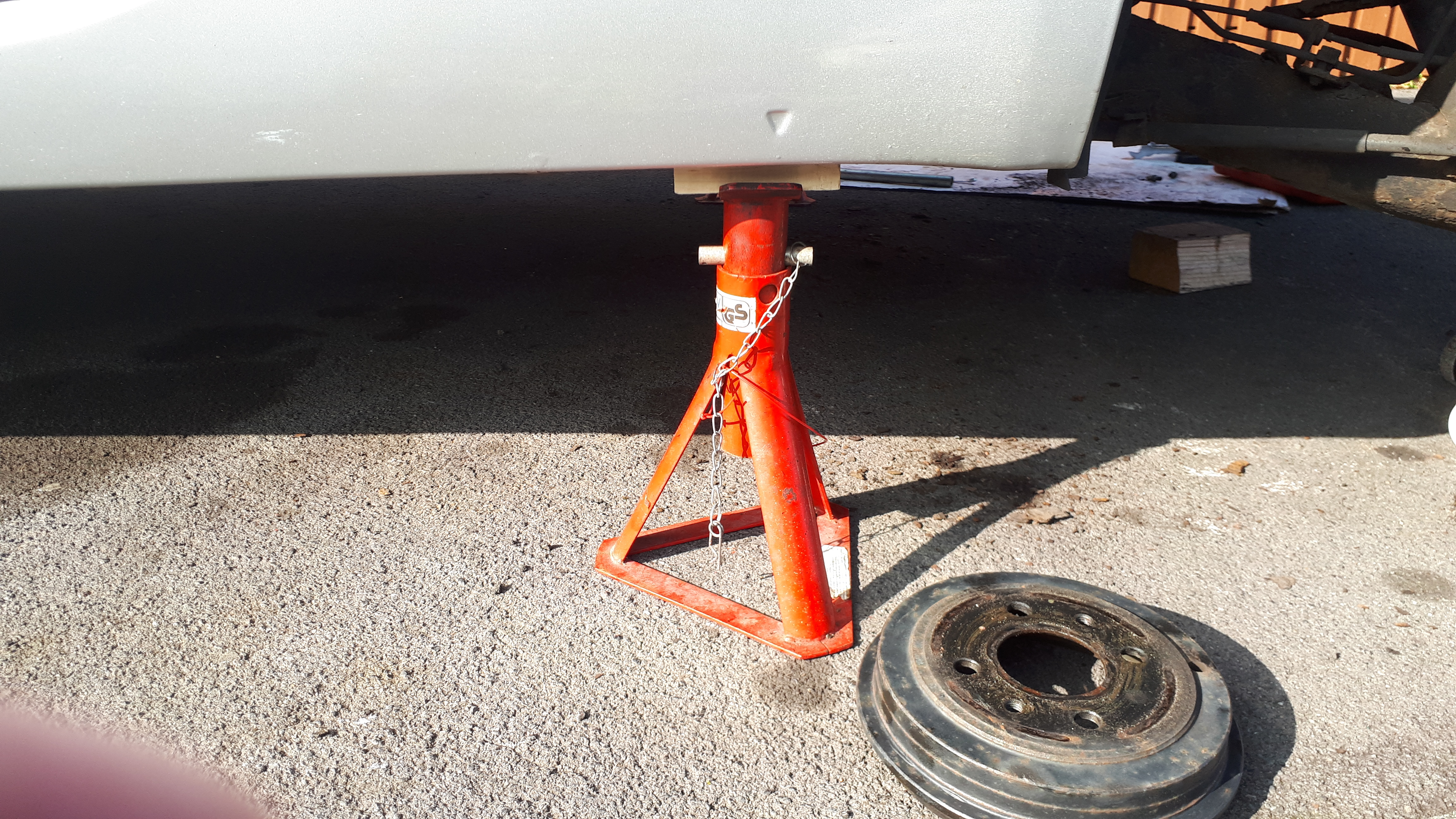

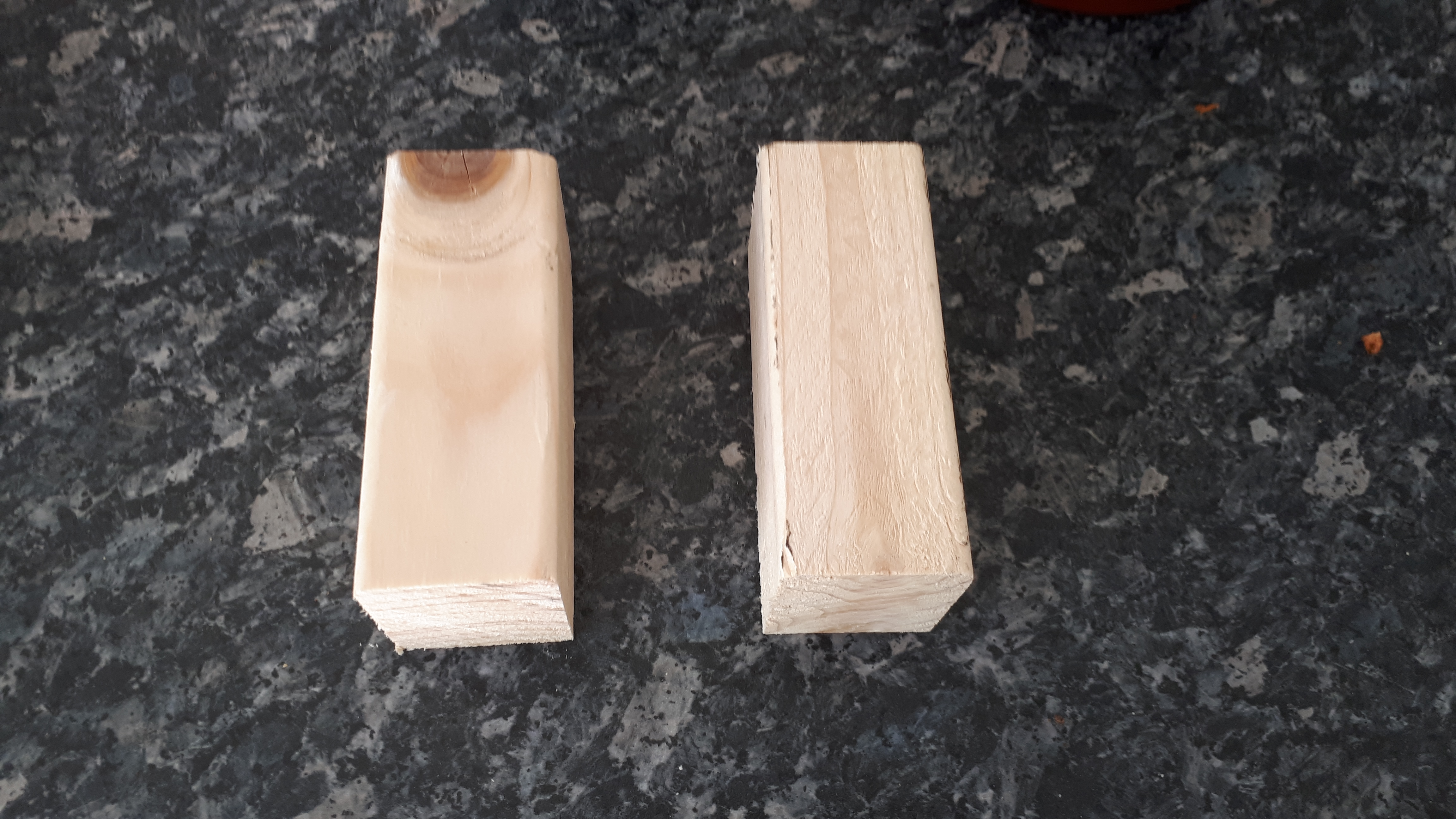

I used a trolley Jack to lift the car then made blocks to fit in the sill recess to support the car
