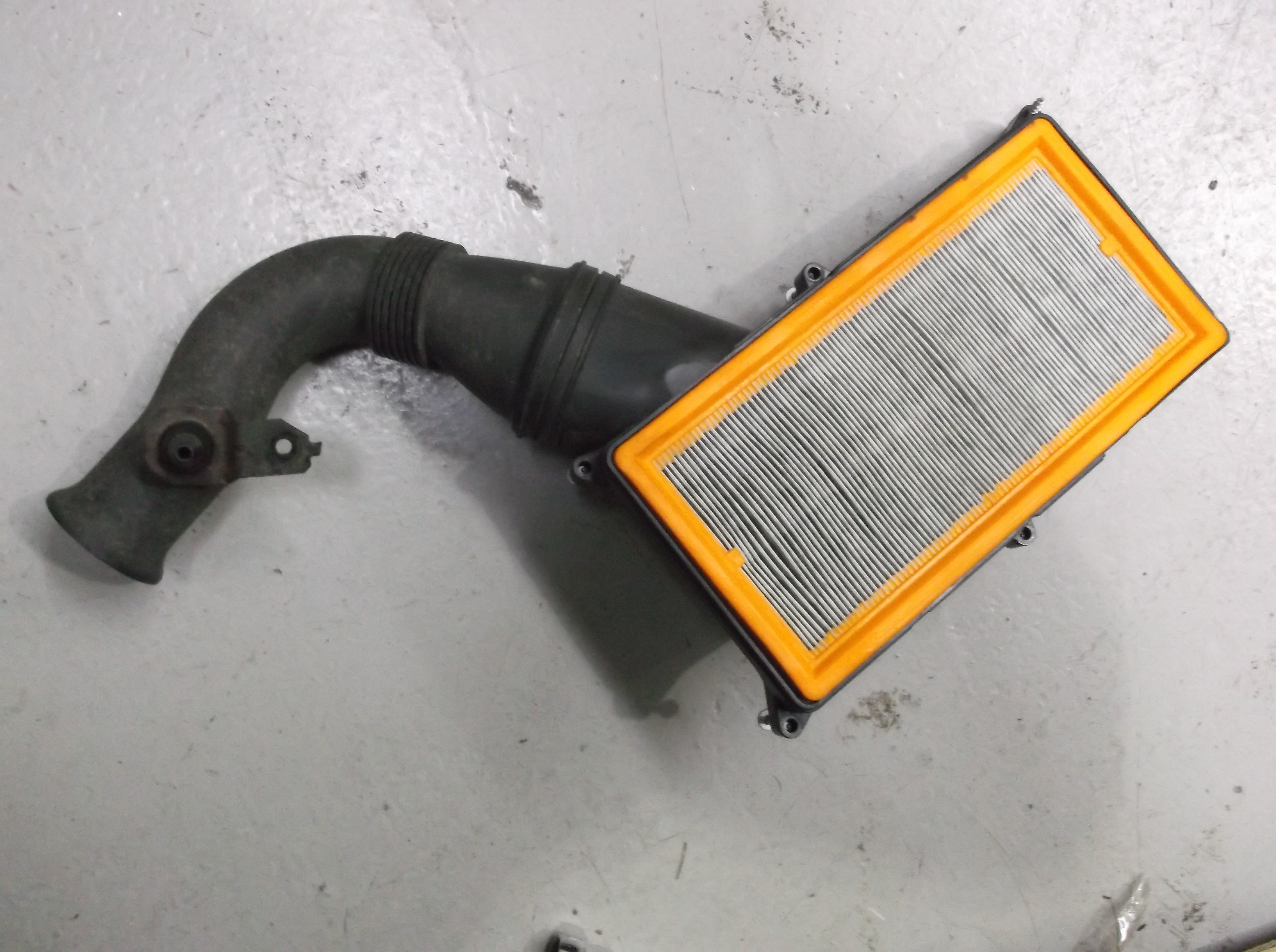

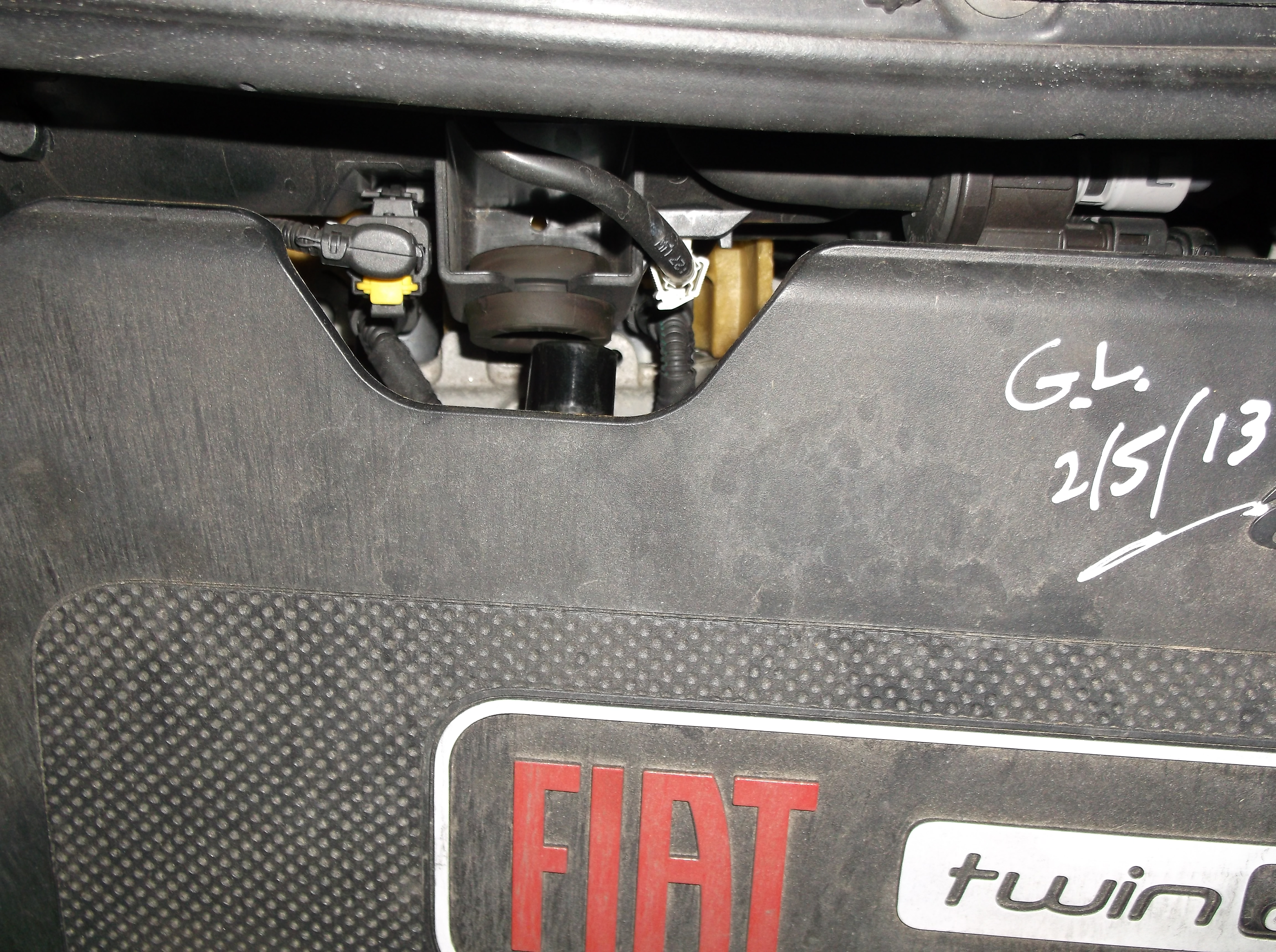

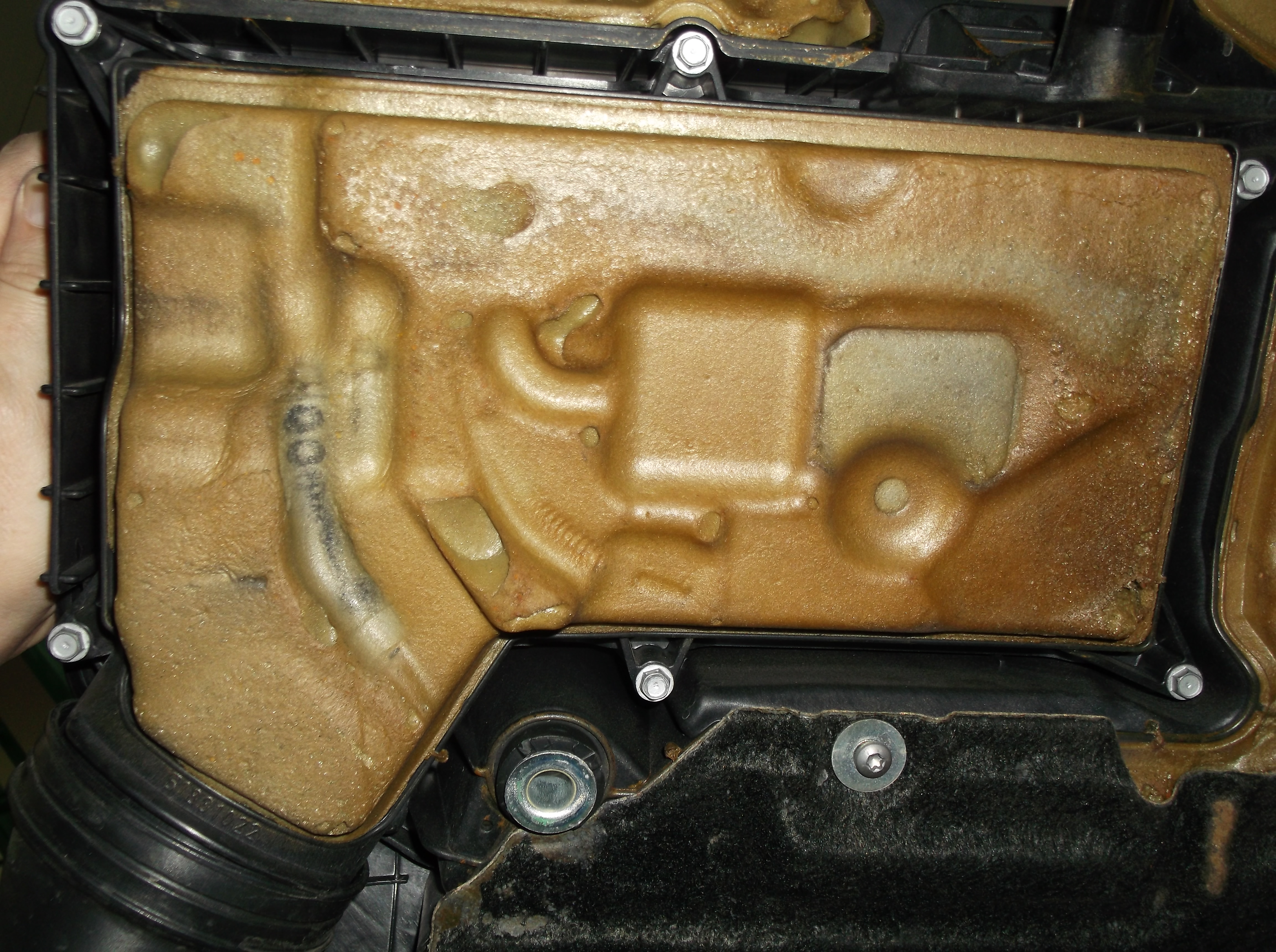

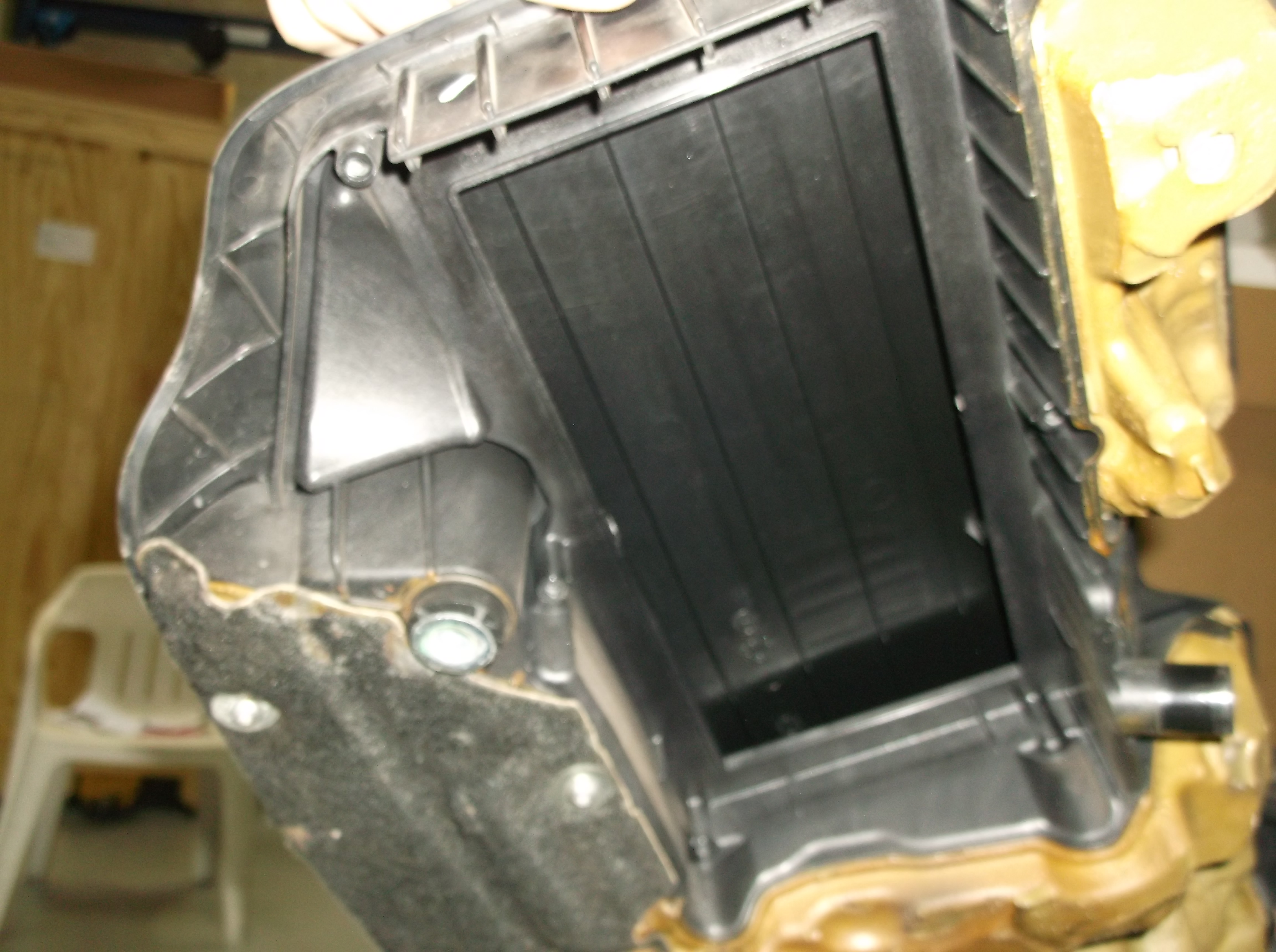

I'm not qualified to comment on what you might do with them, but here are a few pictures of the cover, air box and filter:

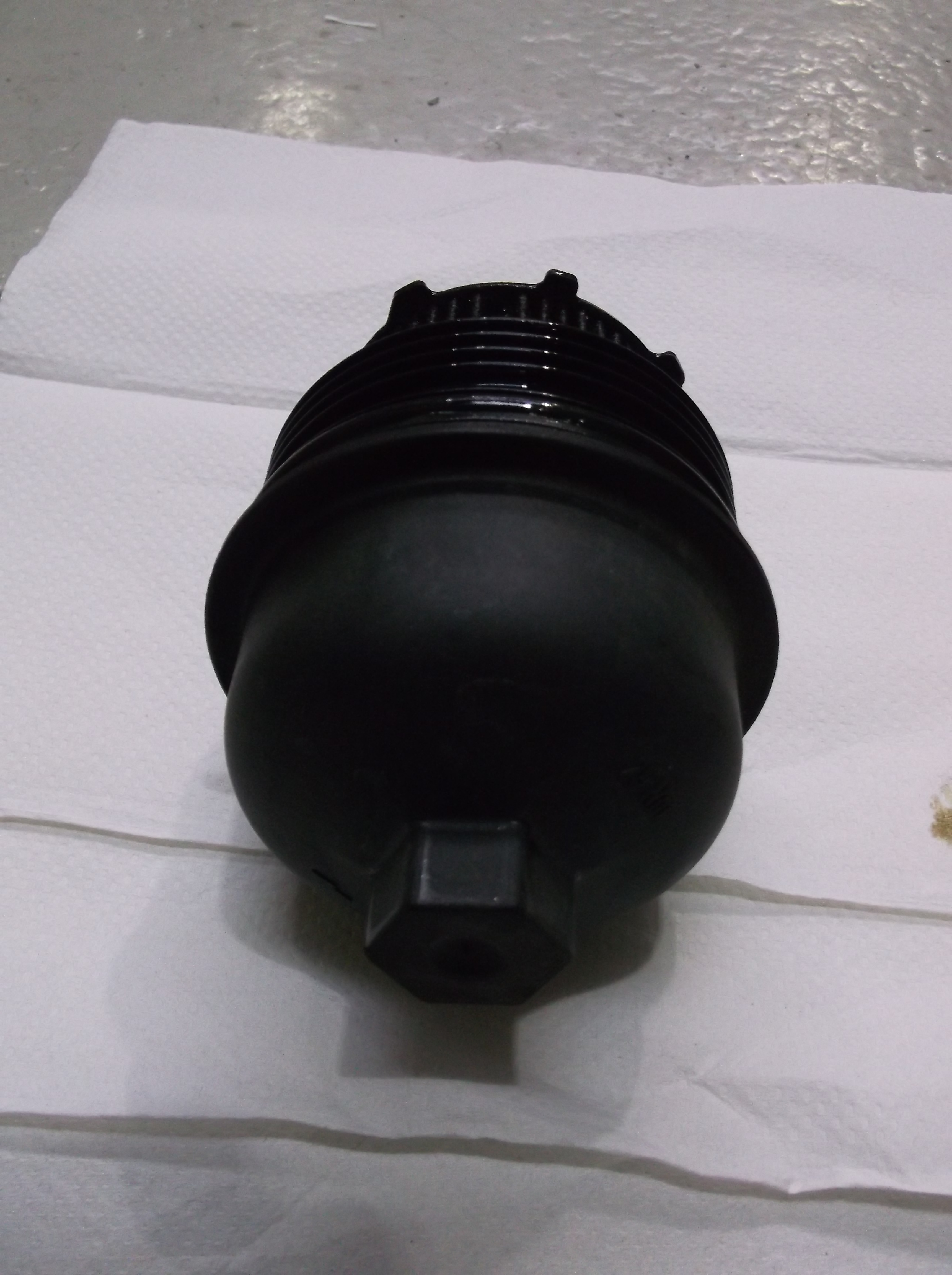

(Ignore the photo of the oil filter - I inserted this by mistake and it hasn't deleted !)

The air filter is on the underside of the engine cover.
It comes through the intake trumpet, up through the filter.
Through the gap above the filter then out the other end to the turbo pipe.
As the cover is so flat, the gap under the filter in the filter housing (dirty air side) is very tight, so most of the space is actually taken up be the filter.
(poor pics, sorry)
There is only really that small corner of the filter to the left that's not up tight against the bottom of the housing and that's just inside the joint with the intake trumpet.
(useless pic that's upside down! but this is the view through port with the trumpet removed)
Above the filter housing, out toward the turbo pipe is also quite narrow, perhaps a fingers width then is opens out where the turbo pipe fit's.
(opens up where you can see the lagging)
Seems to me the underside of the filter housing on the dirty side is very limited, most of it is blocked by the actual housing.
