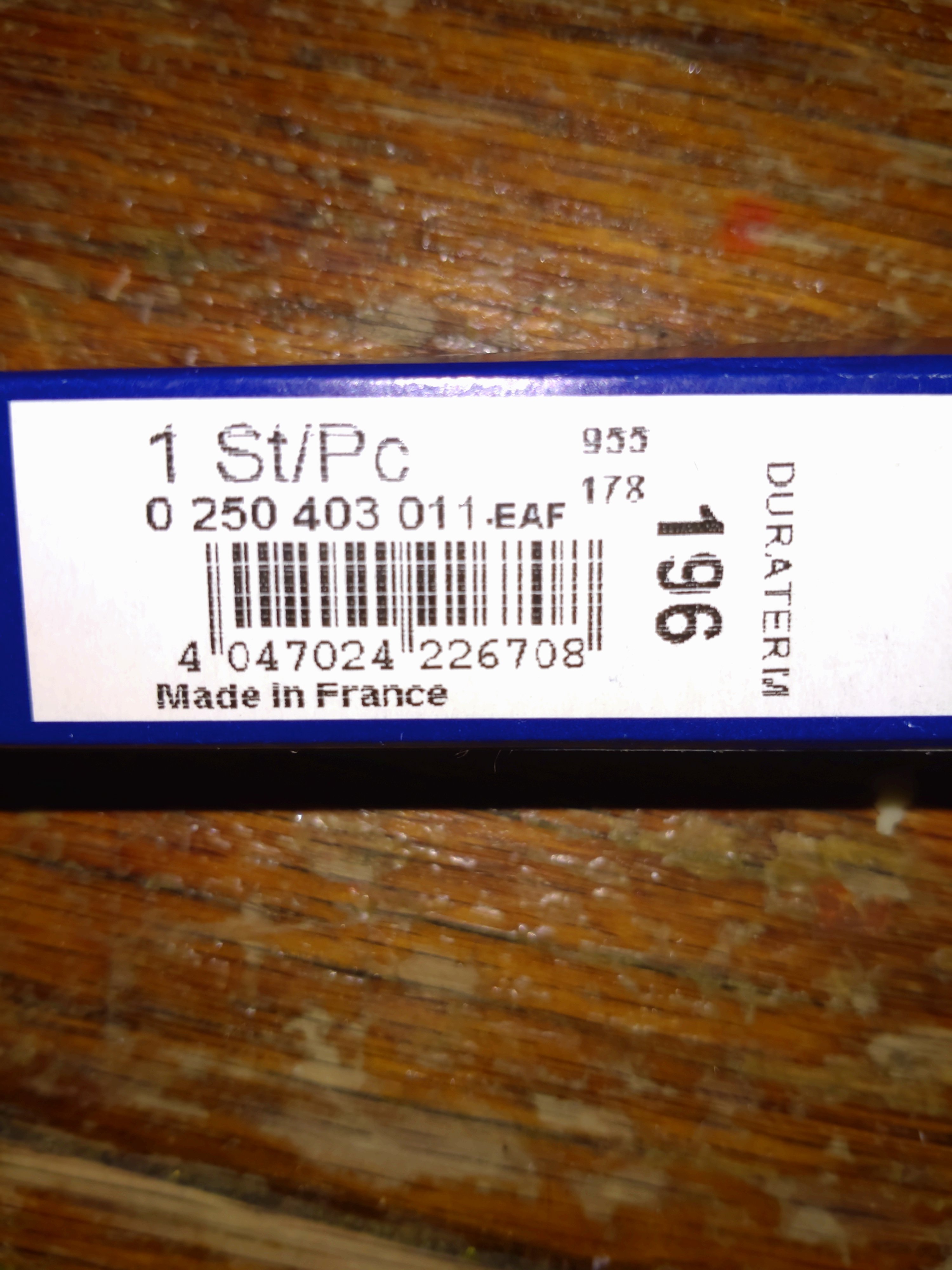

Hi, I literally did this on my 2015 doblo today. I'd been to euro car parts and gave my reg, so they gave me the correct bosch replacements. (Part code on side of box in pic below). They were 8mm thread, and required a 9mm deep socket, I didn't need to buy the specialist, glow plug socket, my deep ones fitted fine. Hope that answers your question, bit more of what I did below, which may help.

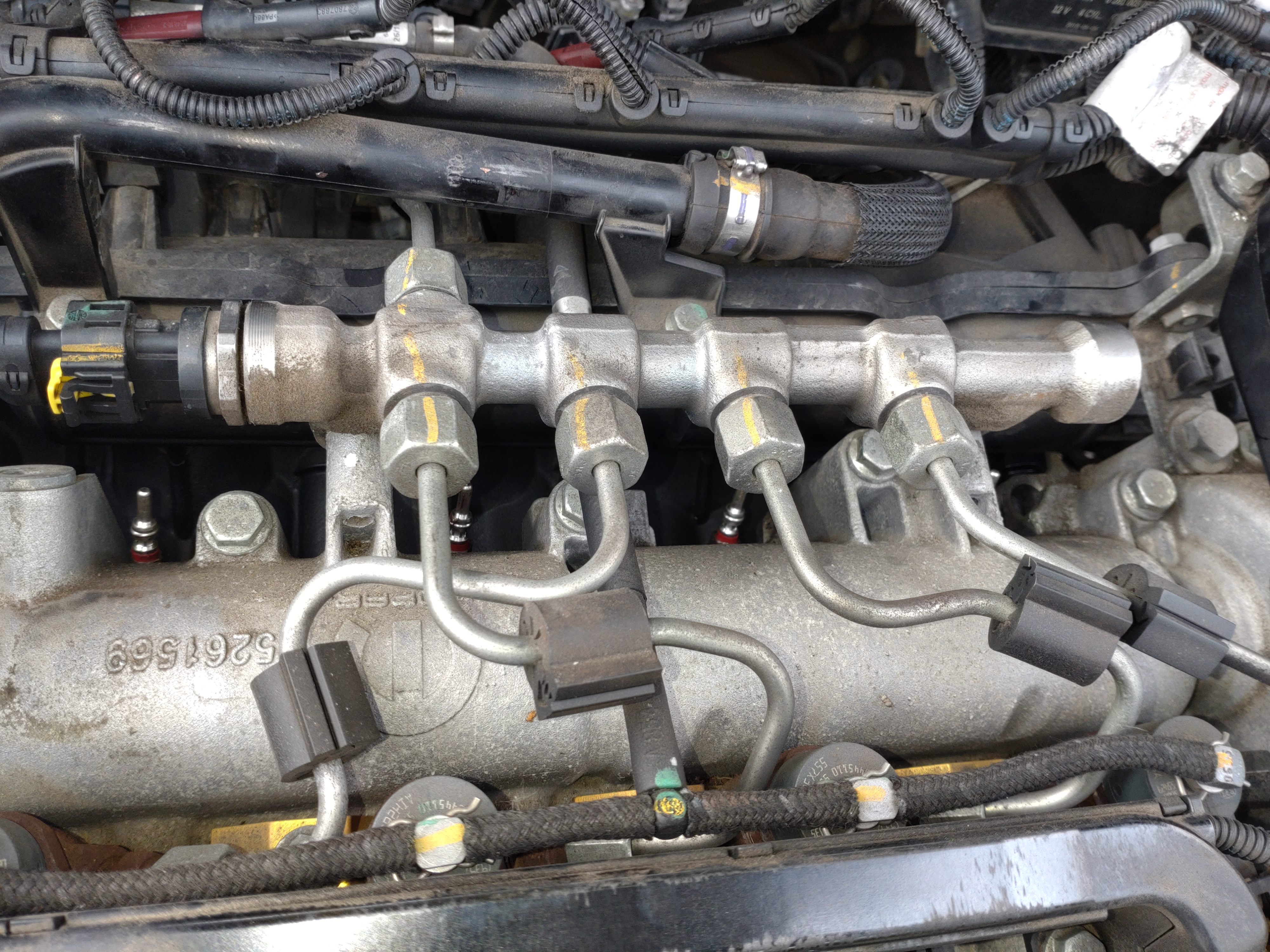

Other than the plastic engine cover, I didn't need to remove anything else to get good access. I had been giving them a liberal squirt of penetrant each evening for the last few days once I got home and while the engine was still warm. I used 1/4 inch ratchet set with its long extension and again while engine was still warm, another squirt of penetrant and they all came out without any real fuss. My doblo has done 80k as a guide as I read problems with sheared threads tend to happen on higher miliage vehicles.
Bit of copper slip on the new ones and they all seated niceley on way back in. I started to use my torque wrench, but to be honest It didn't feel right in comparison to how easily they undid, so I ended up just tightening them well as my wrench hasn't been calibrated for quite some time. If you are going for correct settings, I haven't found a decent version of the most recent doblo workshop manual online, but did find the Bosch literature (attached to post) for the duraterm plugs which are the correct ones.

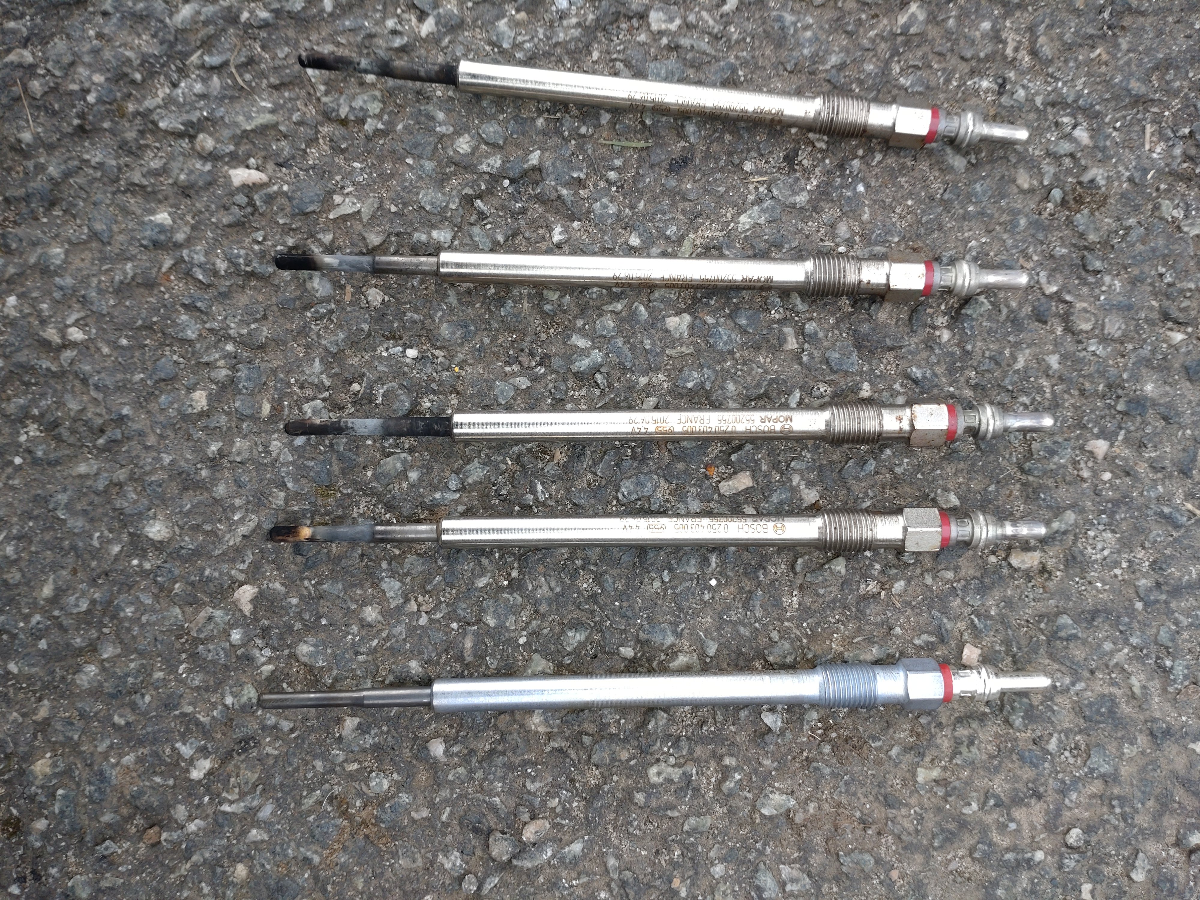

As you can see the old plugs came out with all threads in good condition when compared to the new ones.
