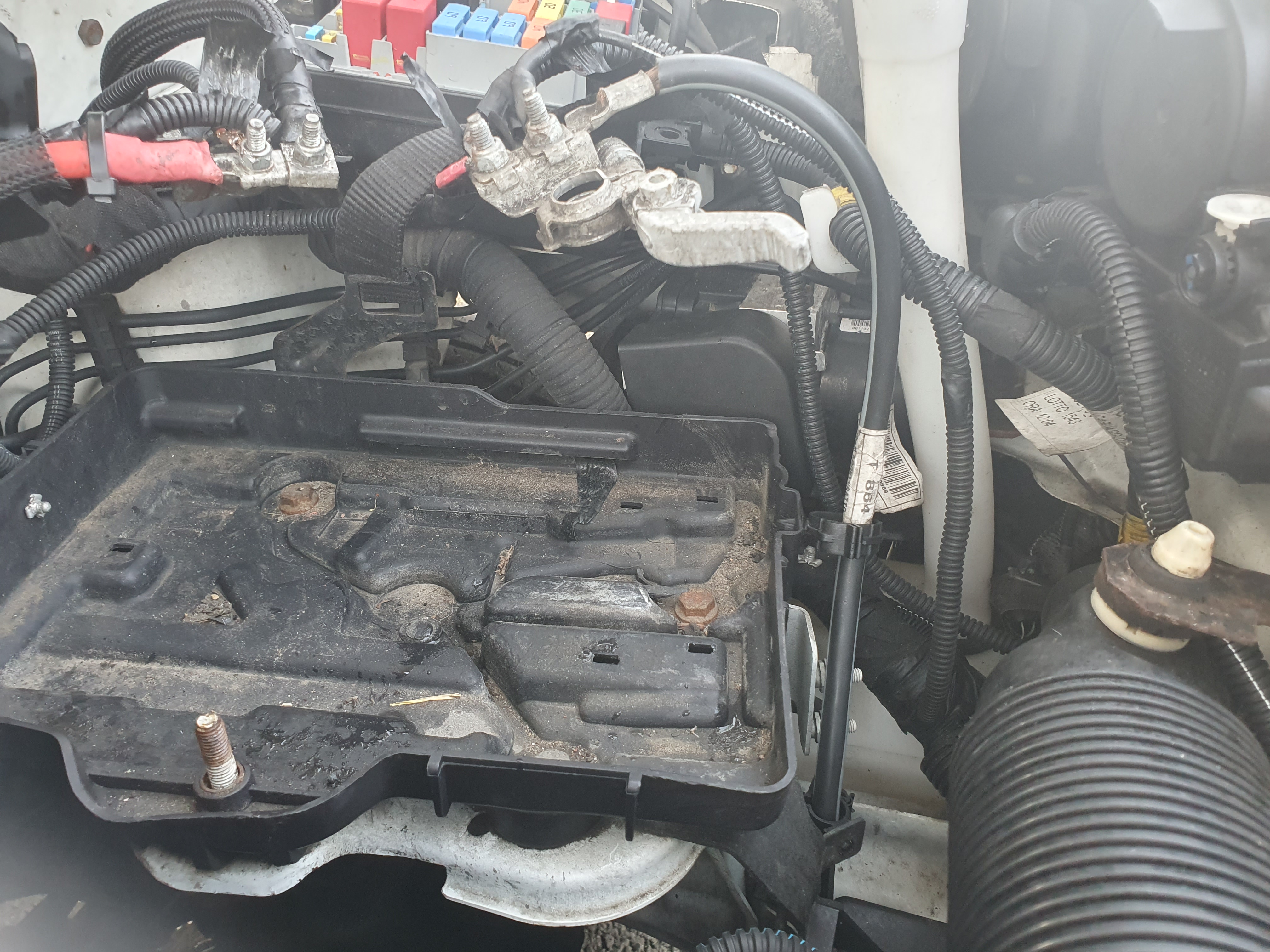

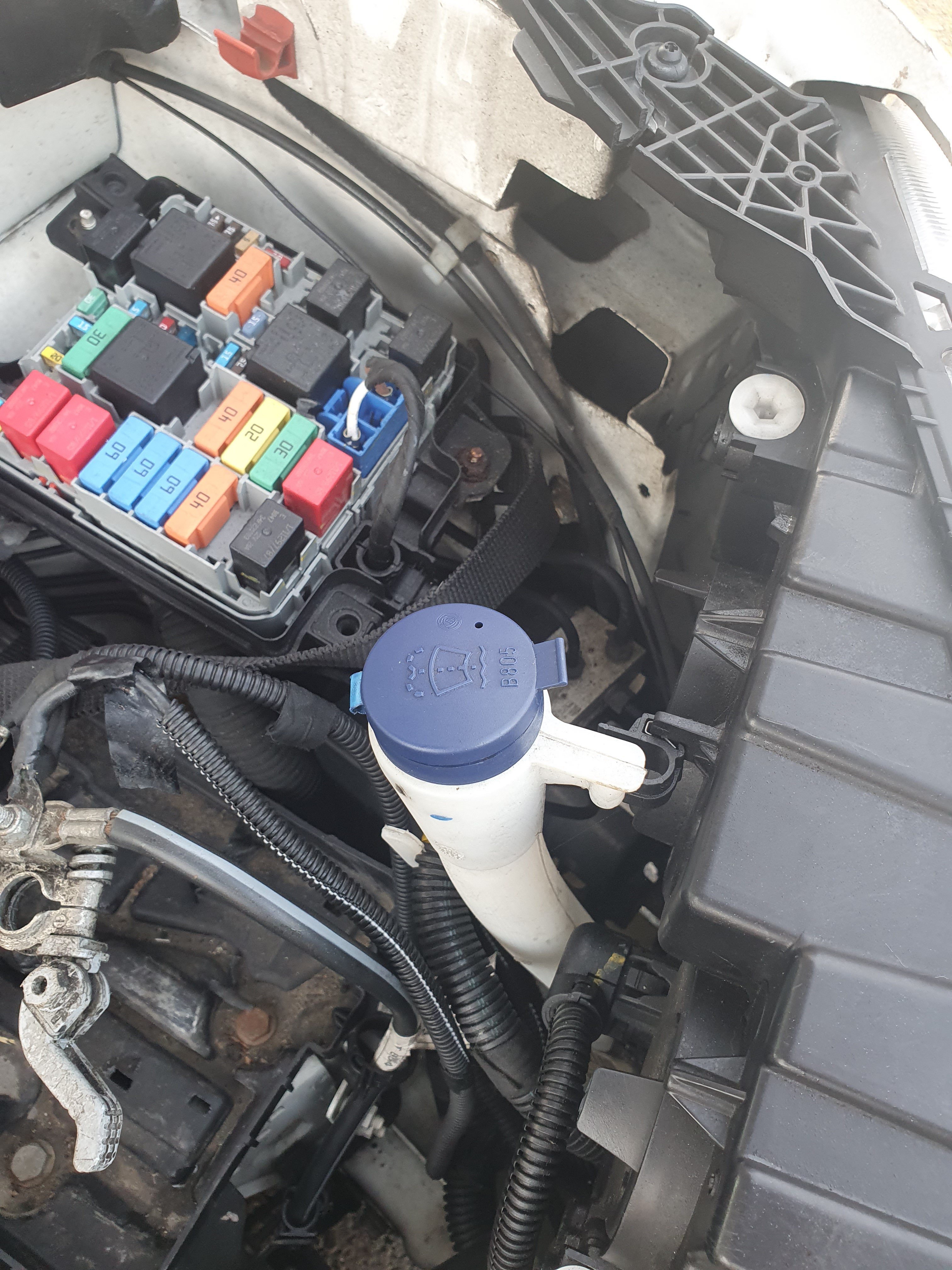

Hi Is this the glow plug heating module?
Nope dpf sensor for pressure levels
Glow plug module will be something like this depending on the car and engine

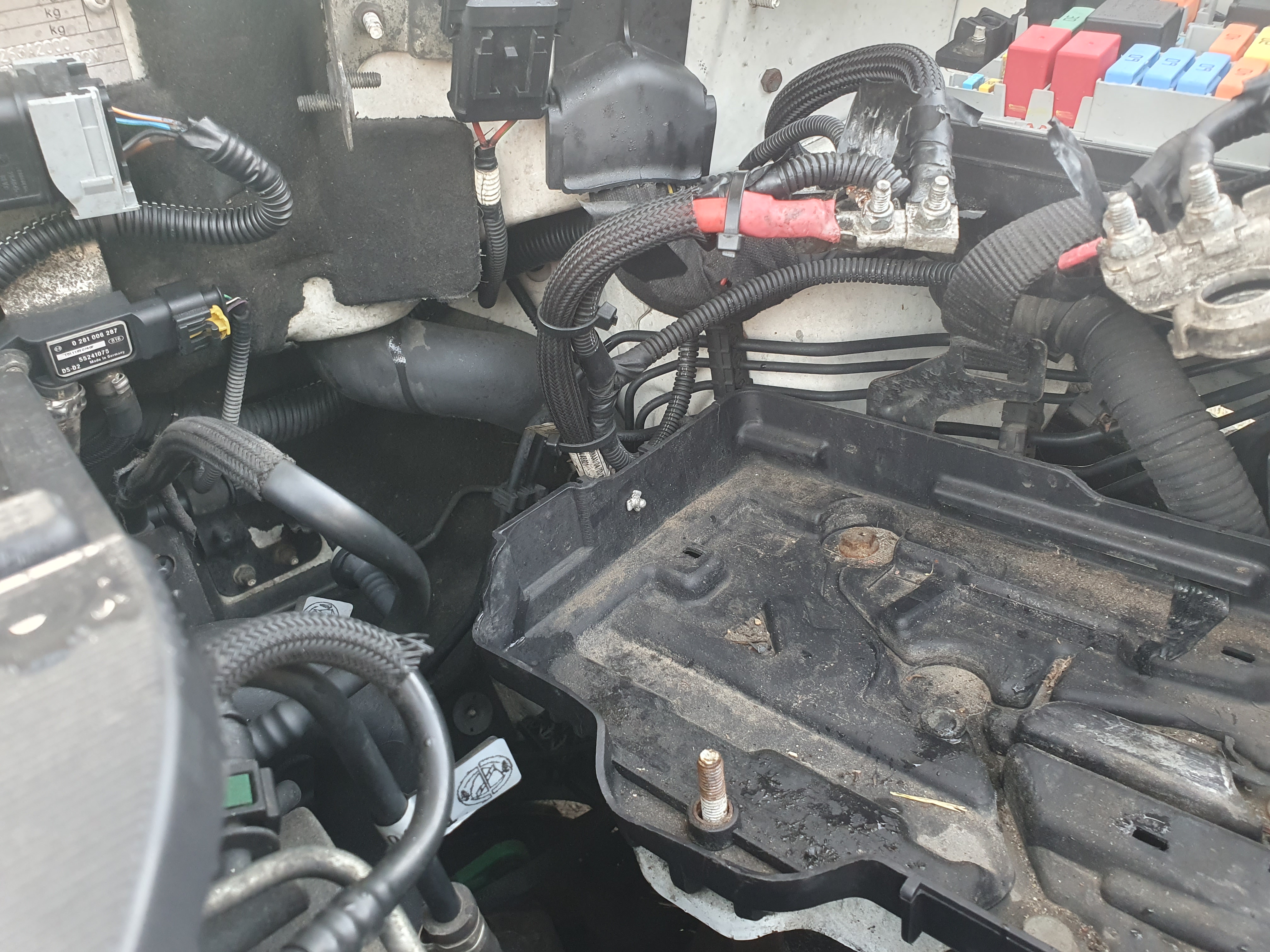

Hi 🙂
Ok.. Similar thread posted the other day 🤔
One of those RED cables bolted yo the Positive battery clamp "should". Be the feed for the Glow plug relay / controller
Follow it! 😉
Please DO post your findings on here 👍

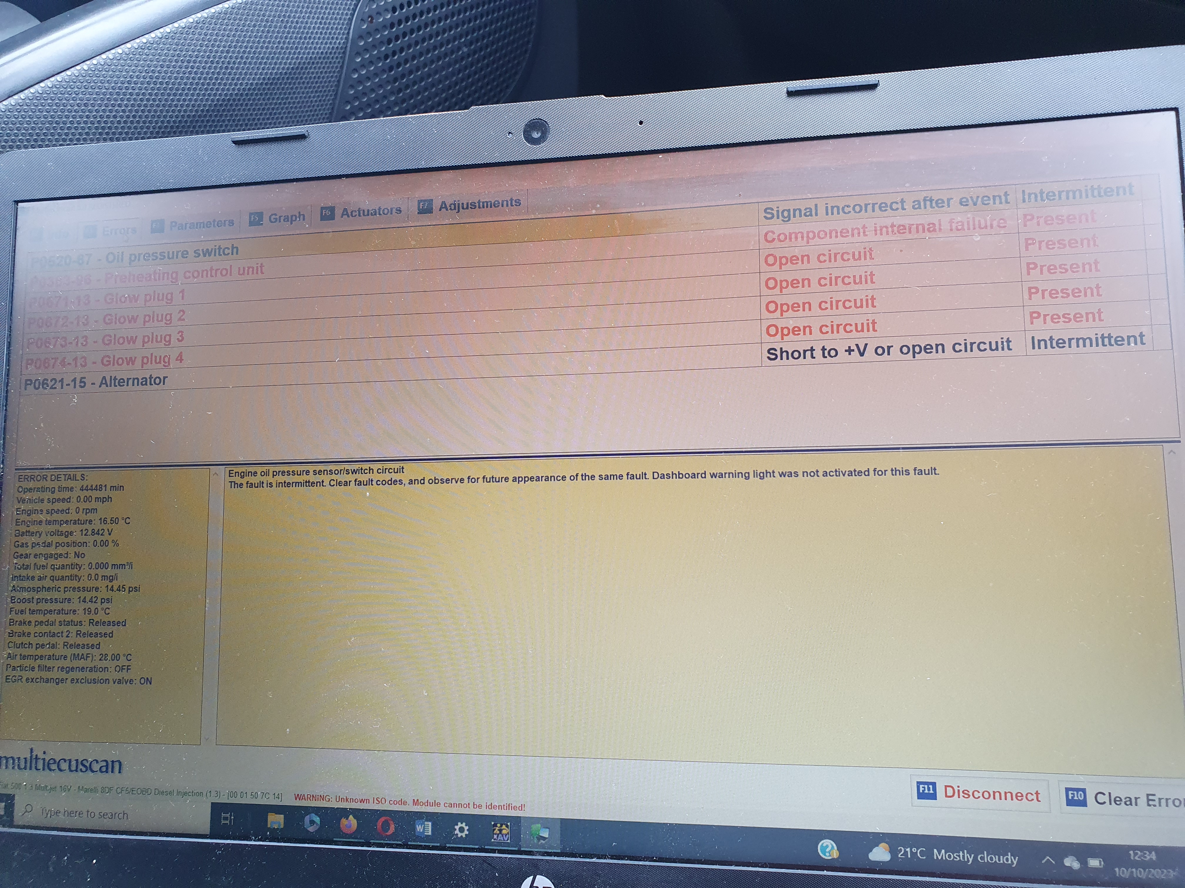

However...
your list of errors may mean you have a more fundamental issue

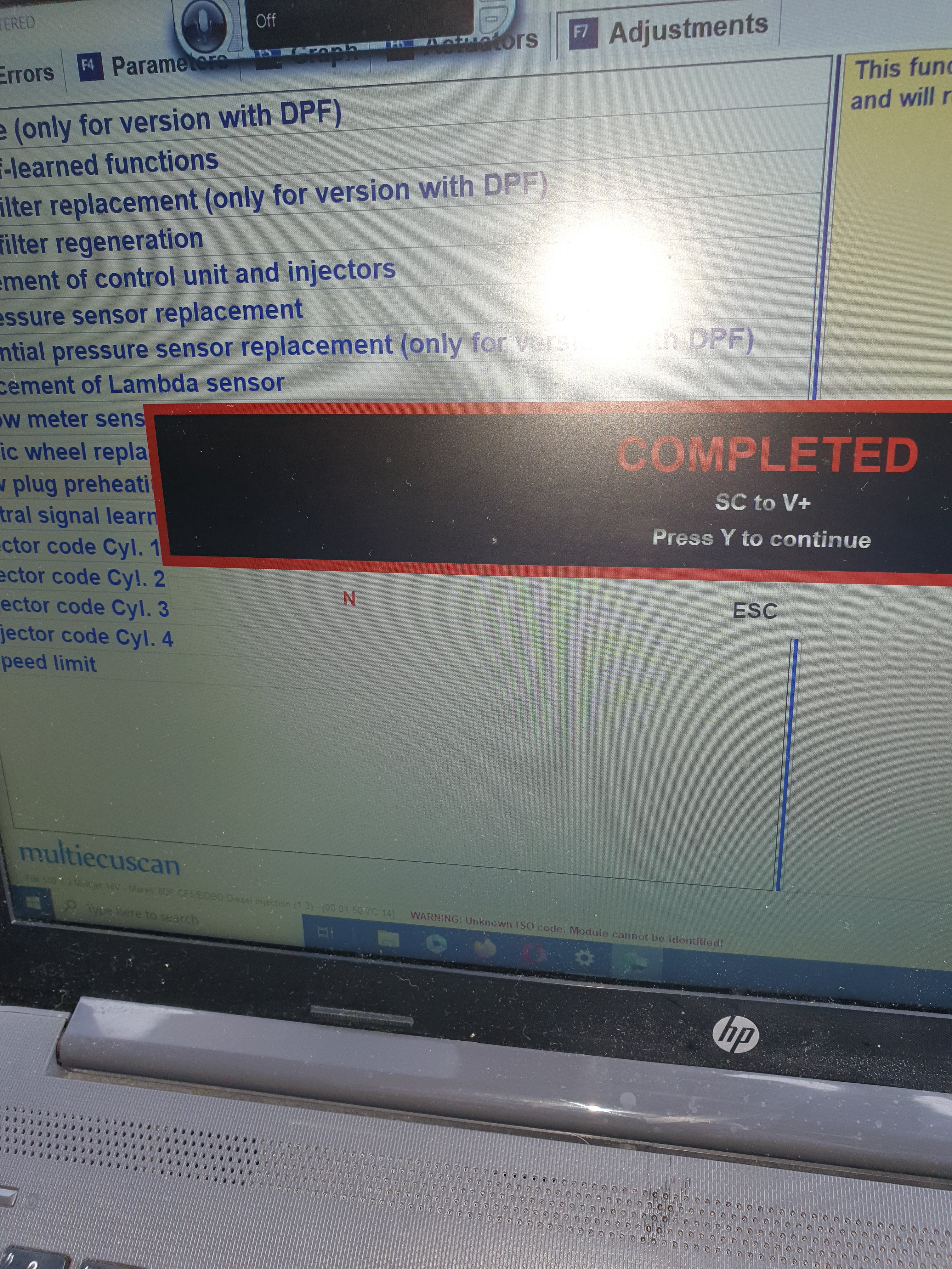

Hi all, found the relay and replaced it car still won't start. I've attached a vid of me trying to start it and screenshot of multiscan errors.
