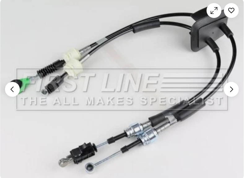

I think its more likely a gear change cable that has failed or is about to go completely. You can slip the ends off and see what happens when you pull on them. If it comes off in your hand it needs a new set!
That was my original thoughts, but does not explain the noise in engaging reverse?
How do I access the cables? take battery out and then tray etc, or can I access from underneath? these?
Is the noise grating . If the cables struggle to pull tge gear in cleanly it would explan that.
I would definitely remove battery. I think you have to go under to get the lever ends. The clutch release pivit has been kniw to seize solid I think @hertshillhopper has posted on this. I can see this occuring overnight too.

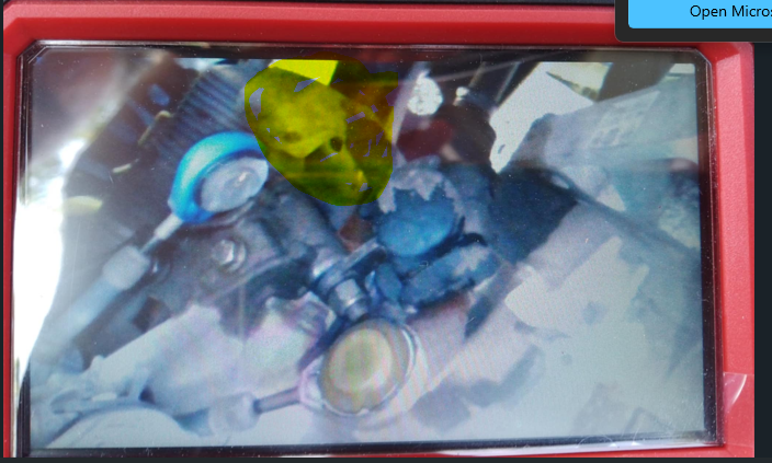

No grating noise on 1-5, cables seem to work, used a borescope to view. BUT, on activating the 1-2,3-4,5-R on the yellow terminated cable the piece highlighted in yellow moves ( ok), but seems odd that there are two holes in it and nothing connected? Battery, tray, ECU etc all coming out.
No grating noise on 1-5, cables seem to work, used a borescope to view. BUT, on activating the 1-2,3-4,5-R on the yellow terminated cable the piece highlighted in yellow moves ( ok), but seems odd that there are two holes in it and nothing connected? Battery, tray, ECU etc all coming out.View attachment 468457
Mine has those little holes I think they are some manufacturing thing.
I think the cables pop, off the ball joint underneath then you can push pull the ends directly. If it were the clutch / slave reverse is normally the first gear that gets very difficult. Bad cables will normally have some sort of bad feel, but they can continue to work right up until the last strand lets go. Can you post a vidoe of the lever action and any noises? That might give more to comment on. Haynes says pop them off using a spanner underneath and prise up. ONe thought, have you checked the oil level first?? MY Laguna ran 40K before I finally got fed up and did this. It had almost no oil in the box and had been like if from new. It was fine with oil in it....
