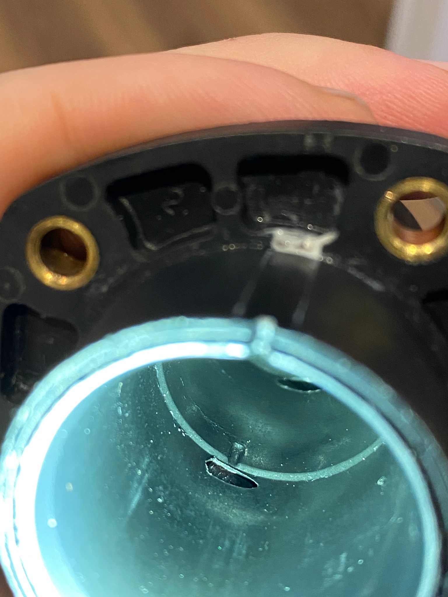

Probably worn clutch actuator (hydraulic valve or whatever it's called) out due to leaked hydraulic fluid (small cylindrical reservoir with dot4 fluid).
You can test this by opening clutch fluid bleed nipple and apply some pressure to the fluid reservoir. I just sacrificed reservoir cap - drilled hole in it and attached rubber tube with a hand pump at the other end. You can also use multiecuscan's clutch bleeding function.
If nothing comes out of the bleed nipple, you have a worn out clutch actuator cylinder which blocks passage of fluid to the cylinder.
Here is mine.. I don't think it's supposed to look like that. It's all worn out to the point of blocking that small groove which allows fluid to enter cylinder from reservoir. Although only the plastic part if worn, I could not find replacement for it. Also the seals can not be purchased separately.
So I replaced whole unit - around 700 euros on ebay (Part nr. 8001063895659 or 71751001) and some 2-3 hours of work. Always keep an eye on the fluid level and fix any leaks if you have them.
Also, be careful, there is high pressure hydraulic line (40bar I believe) connected to the clutch actuator. You need computer to depressurize it first before removing anything.
