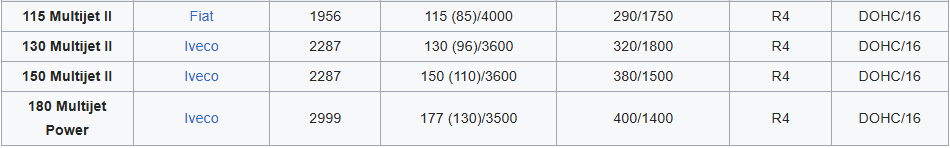

Until 2018 the following engines were available with the EUR 5 / EUR 6 norm:

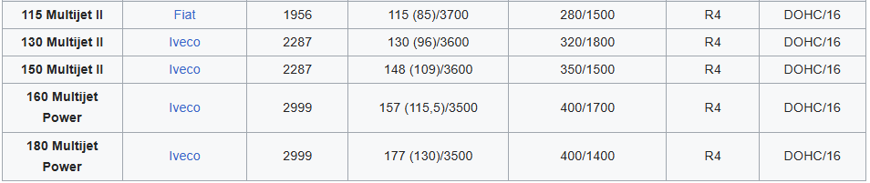

For the 2018 - 2020 models the following engines were available with the EUR6 c norm:
Then for the 2020 - 2021 models the following engines with the EUR6 d norm:

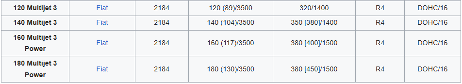

Since 2021 with the EUR6 d final:
The number in the model designation reffers to the maximum power in HP.
There's definitely power mentionned in the V5 document. However could be in kW. You have to convert it to HP (multiply by 1,36). The V5 doc should also mention the EUR norm.

Thanks for the replies guys. I’ve checked the V5 for power (in kw) which is 96. Multiplied by 1.36 I get 130.56 which might indicate it’s a 130 Multijet II, especially as the table (kindly provided) also has 96 in brackets, after the 130 figure under the max power heading. On the engine plate, next to ‘motore’ is ‘F1AGL411D’, a Google search on that has brought up both Fiat and Iveco as manufacturers. Getting somewhere now I feel.
Have to say the information you guys offered has definitely pointed me in the right direction for research as I was kinda struggling with where to start, so massive thanks for that. I’ve now discovered 2 parts dealers selling F1AGL411D engine blocks and both list the engine suitable for a 130 Multijet II.
a bit late to party but i can confirm the F1AGL411D is the 130 multijet 2 , twin egr motor.
