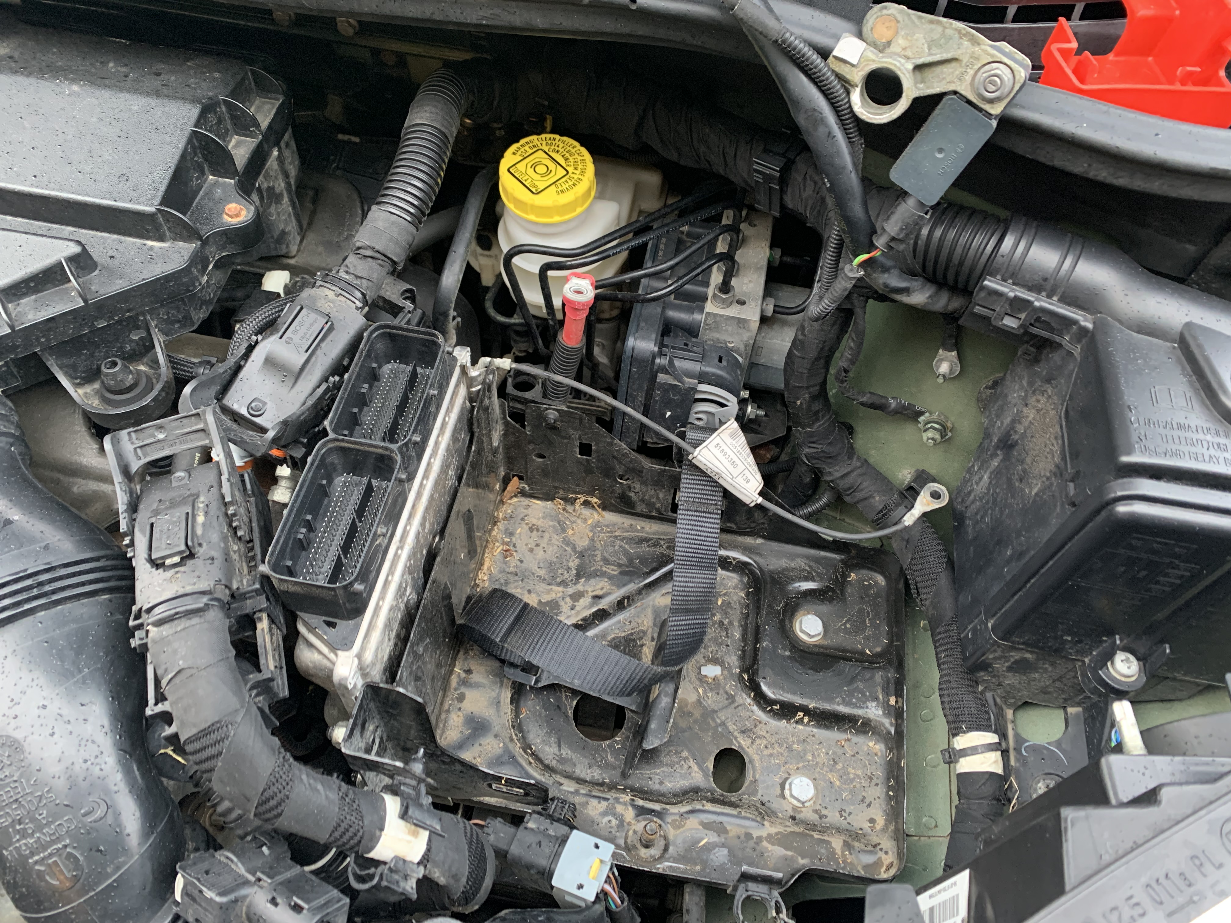

I took the opportunity today to brave trying to reach the troublesome pivot that corrodes and leads to the gear lever becoming very stiff 'across' the gate. Mine's a 2018 diesel 4x4, so some things in the phots may be different on other models, but the gist will be the same.
Start by disconnecting the battery (negative first) and then remove the battery completely.
Next (above), carefully disconnect the large plugs to the ECU and unclip various plastic clips holding cables to the sides of the battery support. Also remove the earth wire from the ECU (at the bodywork end). Remove the plastic drip tray from the bottom of the battery support (noting the long drain pipe that fpokes down from it) and remove the nut and two bolts holding the battery tray in place. Ease the tray up and remove (by rotating the cable and battery tray at 90 degrees to each other) the plastic clip that holds the bonnet release cable to the bottom of the tray. The ECU remains bolted to the side of the battery support and all comes out as one unit.

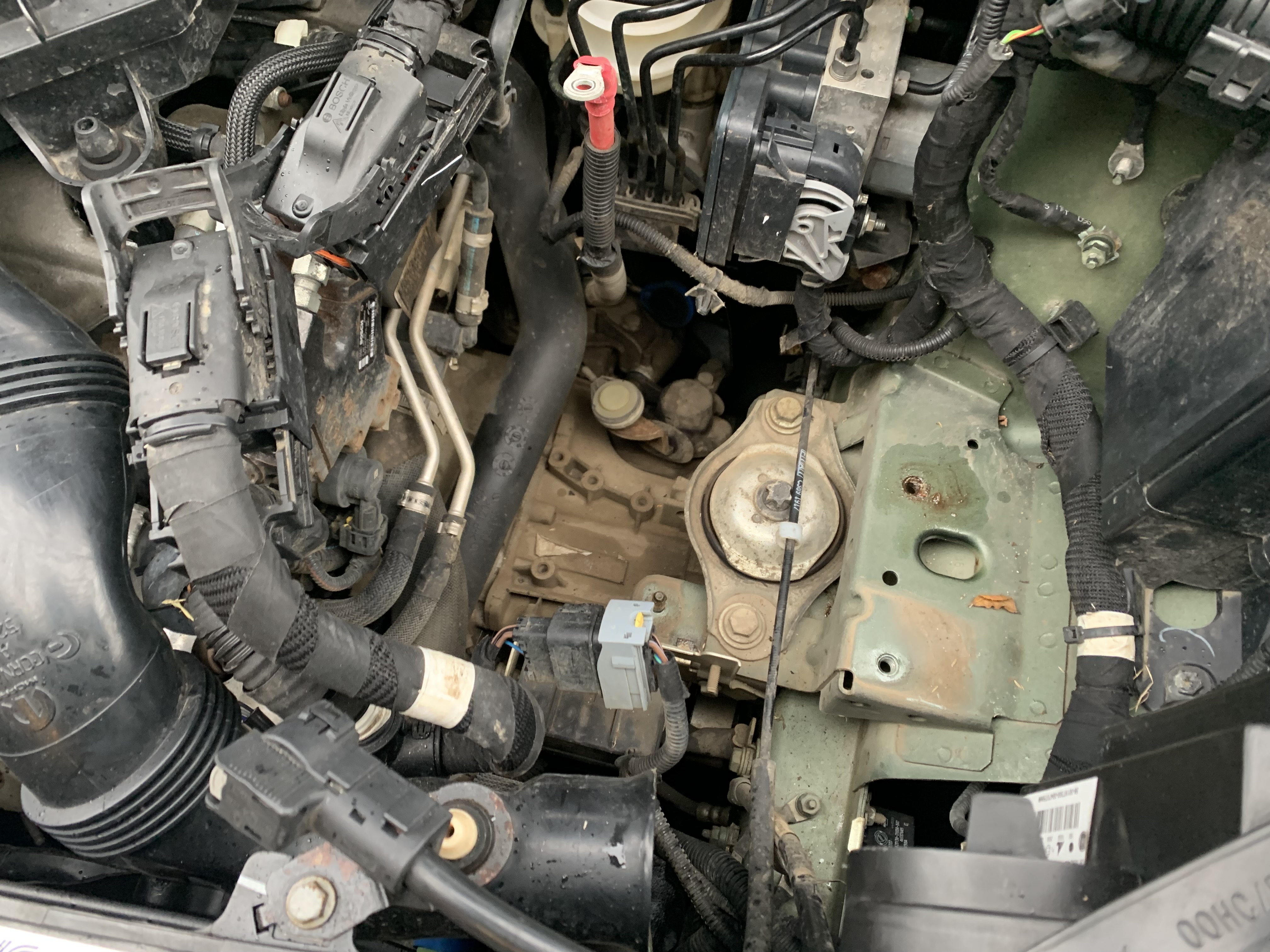

With the battery support out of the way, the top of the gearbox is now more visible. The ends of the gear change cables can be seen (round plastic fittings that just clip onto ball and sockets) Unclip these (by carefully levering away with a blunt tool). Note - these are not lubricated, and should not be. They are made of teflon or similar. Greasing these would in time make them stiff as dirt would get into the grease. Similary, these ends of the inner cables where they pass through rubber seals to the outer part must not be lubricated.

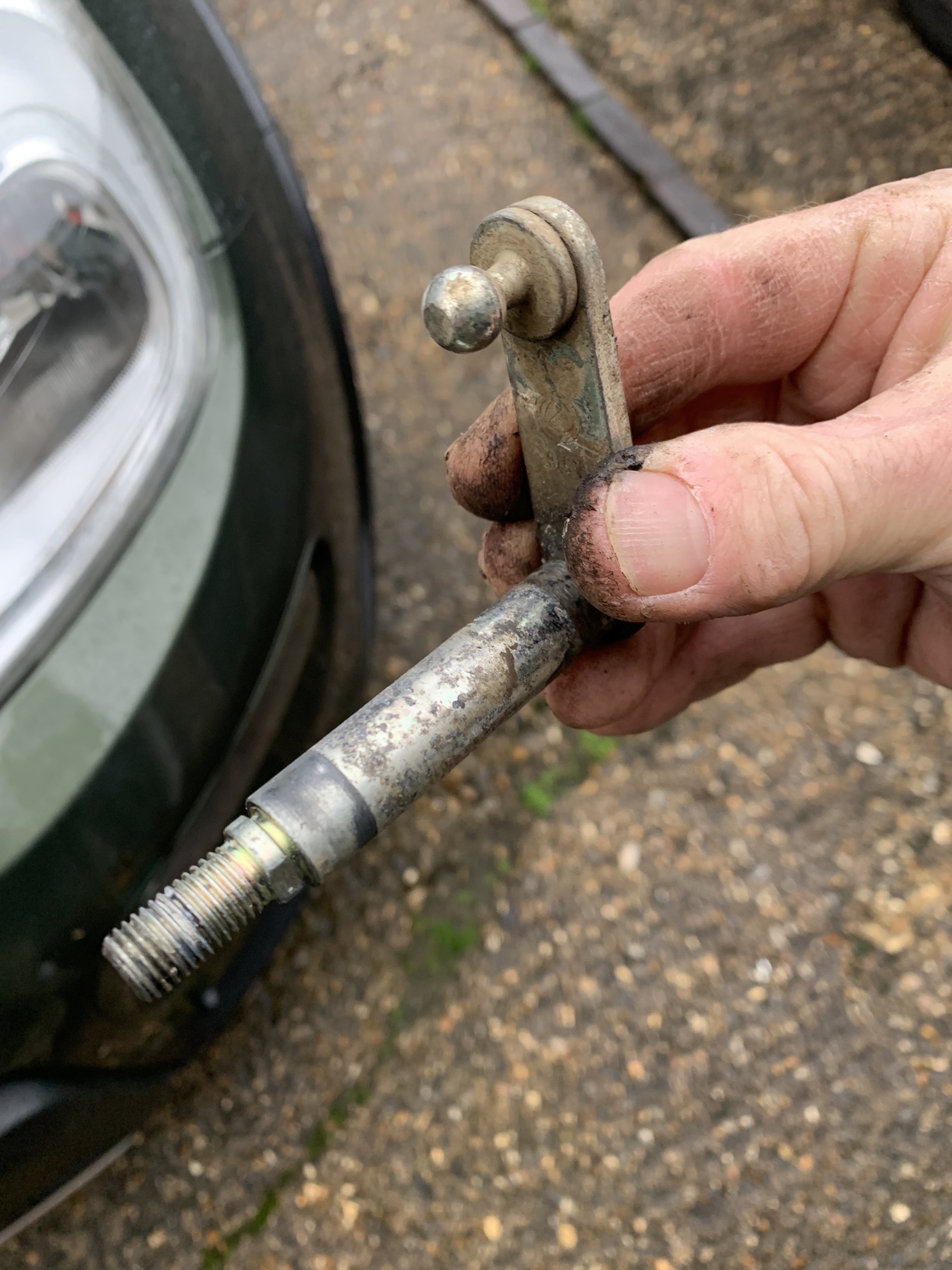

Unscrew the nut (17mm AF) on the end of the pivot rod (this rod is what corrodes and leads to the stiff gear change action). Carefully recover the nut and washer behind it. The rod should be able to be pushed out towards the back of the engine bay. Mine was so corroded I had to knock it through with a soft hammer. There's a small, loose metal part that fits between this rod and into the rubber cover on top of the gear control levers. This should stay in situ, but it comes loose, it just slots back in later.
Out of the car, here's rod in question It has two bands of corrosion mixed with dirt on it (worse nearer the balljoint end, under my thumb). I cleaned this away with some fine wet-and-dry paper., ahead of lubricating it before putting things back together. This rod is supported in the 'tube' it came out from by a plastic sleeve at either end (which I didn't take out). So, be careful in your choice of lubricant so as not to affect the plastic. I used (and hope its OK!) some spray-on white lithium grease. Note for refitting: there's a flat section just beyond the tread which the (possibly loose) lever in the rubber cover (mentioned previously) fits back onto when reassembling.
View attachment 391923Next (above), carefully disconnect the large plugs to the ECU and unclip various plastic clips holding cables to the sides of the battery support. Also remove the earth wire from the ECU (at the bodywork end). Remove the plastic drip tray from the bottom of the battery support (noting the long drain pipe that fpokes down from it) and remove the nut and two bolts holding the battery tray in place. Ease the tray up and remove (by rotating the cable and battery tray at 90 degrees to each other) the plastic clip that holds the bonnet release cable to the bottom of the tray. The ECU remains bolted to the side of the battery support and all comes out as one unit.
View attachment 391927Out of the car, here's rod in question It has two bands of corrosion mixed with dirt on it (worse nearer the balljoint end, under my thumb). I cleaned this away with some fine wet-and-dry paper., ahead of lubricating it before putting things back together. This rod is supported in the 'tube' it came out from by a plastic sleeve at either end (which I didn't take out). So, be careful in your choice of lubricant so as not to affect the plastic. I used (and hope its OK!) some spray-on white lithium grease. Note for refitting: there's a flat section just beyond the tread which the (possibly loose) lever in the rubber cover (mentioned previously) fits back onto when reassembling.

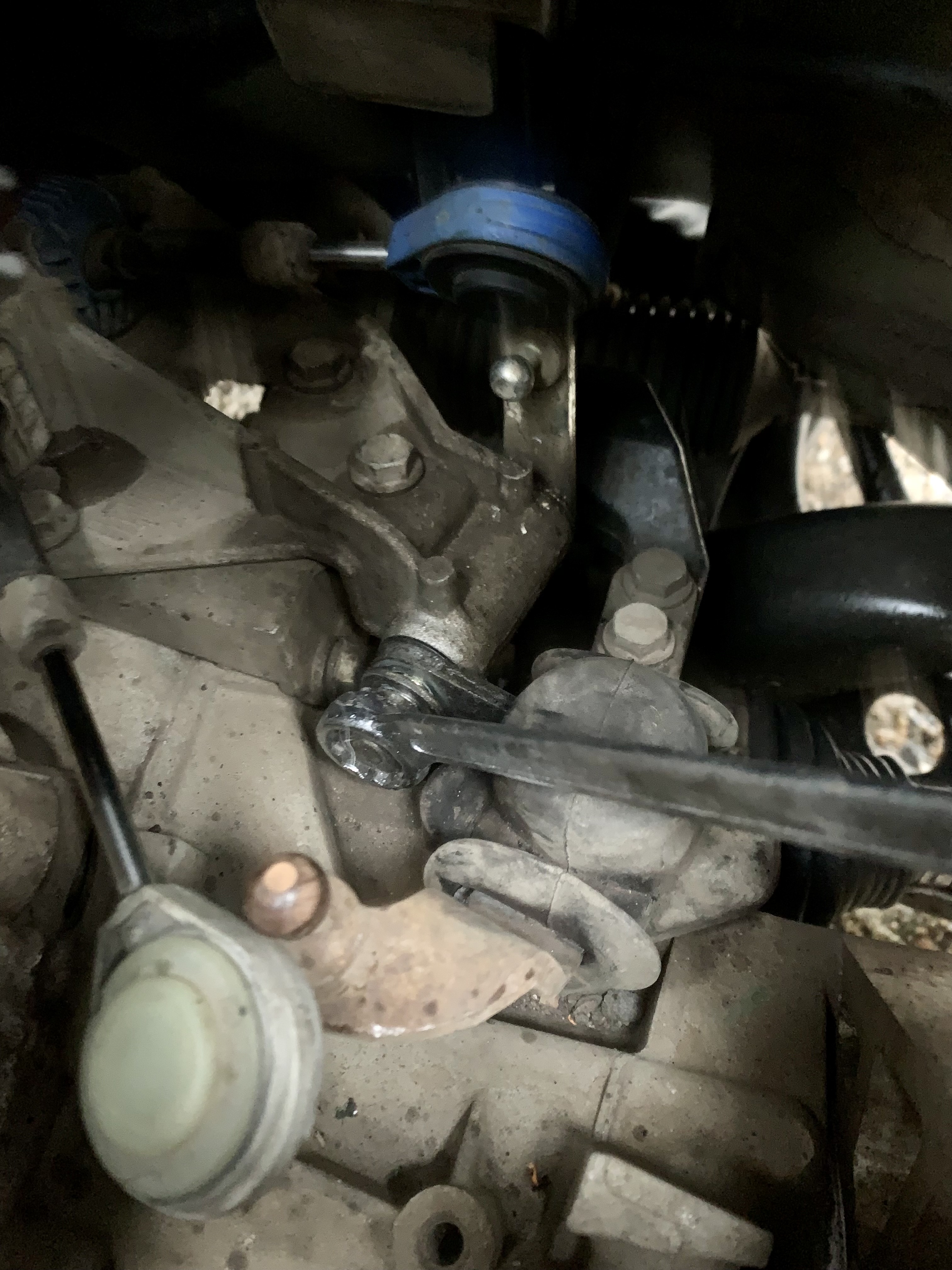

I just did this job on my 2013 Doblo van. Gear selector wouldn't return to the middle and was really stiff. Turns out the selector was a right state - pitting, rust build up etc.
Side note: Because I am a lazy toad with nimble fingers, I did this entirely without removing the battery and battery support. There's just about enough room to swing a spanner. The selector was so stiff in its housing that I had to bash the end of the bolt with a hammer on the end of a wooden pole. That nudged it sufficiently out for me to be able to waggle the rest out with my fingers. After that, was straightforward.
