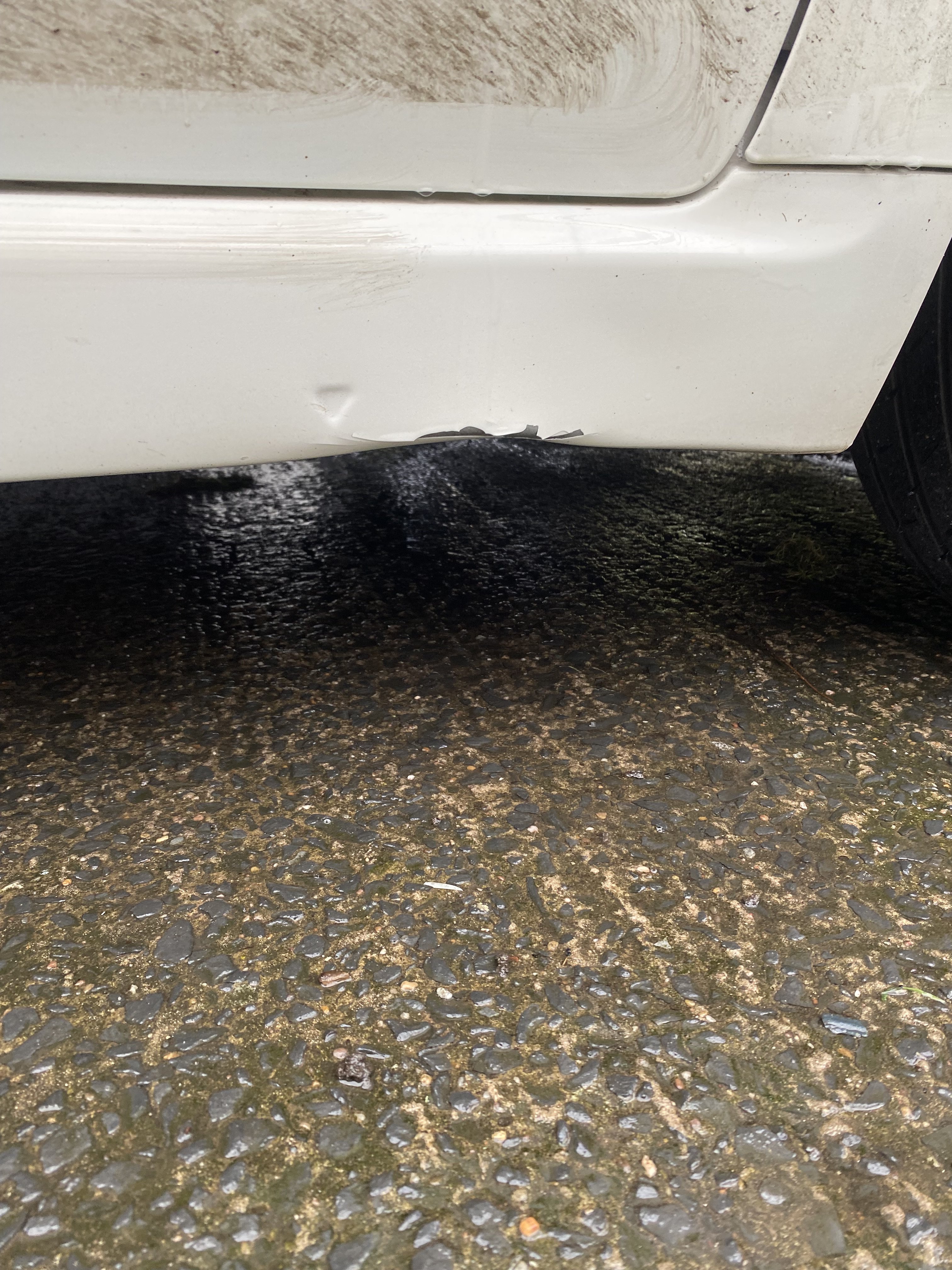

This is a big reason I do all my own work!! Unfortunately I had to book my car in for work I couldn’t do! And this is what I noticed this morning…. @typecastboy any tips or repair as I’ll probably have to repair this myself come spring!
I'd be straight back to them asking for there insurance details for a claim against the garageThis is a big reason I do all my own work!! Unfortunately I had to book my car in for work I couldn’t do! And this is what I noticed this morning…. @typecastboy any tips or repair as I’ll probably have to repair this myself come spring!

The good to need straighting and the entire area repaiting and blending in to the rest of the sill

Let the garage head person know straight away you have found the damage caused by them and don't be fobbed off.
Plus tell them in writing with photos.
If a nationwide chain contact head office.

Yeah will speak to the garage tomorrow … either way it’s prob a job for the professionalsNot a straightforward fix, best bet, weld on keys and pull it out, however that strips off the galvanised coating permanently then fill and paint, not an issue if done correctly?

I personally would smear grease over that

The part of me that believes in justice wouldn't want to see that garage get away with this. The weakness of the 500 sills is well understood in the trade by now and they really should have known better. But at the end of the day, you need to do what feels right for you, and I can understand you not wanting to risk making the situation any worse than it already is.
Much as I'd like to see this particular garage named and shamed, the reality is that this could happen to anyone taking a 500 anywhere for just about anything. It's one reason why I always take the wheels separately in another car at tyre change time.
So would I, and I'd also want to get some sort of wax based protection into the inside of that sill - it's likely to have damaged any factory-applied corrosion proofing on the internal sill seam.
For those new to this issue, and not wanting this to happen to them, I've linked my historic post on the subject, here. I wrote this a long time ago now, before the problem was generally known, but if I were writing it again today, I wouldn't change one word of it.
